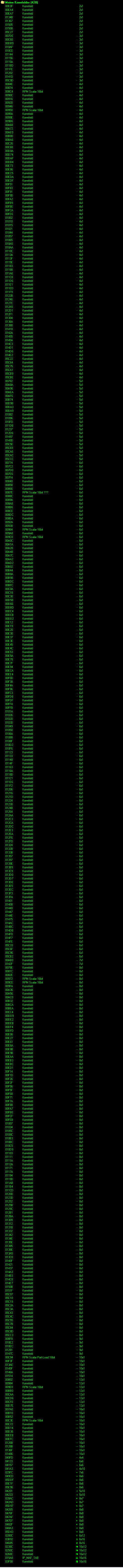

Thanks for the posts. Ive not seen that winols hex editor view with the bar graphs showing the values on the right before. Thats pretty cool, and makes more sense than ascii for this type of work.
