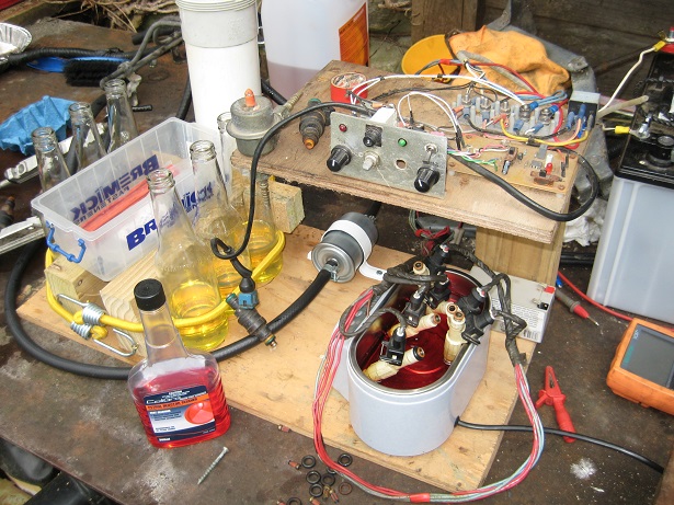

I had a pool of coolant under the rear of the supercharger.. in a recess in the LIM... looks like it came through the bolt!
Also a bad mis-fire getting progressively worse under load. Right then... LIM gaskets... bought a G-Force kit, it'll do.
Whilst apart, I knocked up a little rig to test the injectors, its a bit of a jury rig, but enough to kinda see if the squirters could deliver a reasonably equal volume of fuel.
New orings and filter baskets... they tested well.
But, this brings me to question 2... I still have a horrible split between the banks. lh+3%, rh -10%.. basically.
What to try next?
I have swapped O2 sensors, and even swapped to another set.. NTN vs Bosch. No diffference.
Swapped to a different ECM ('728) for a quick test.. no difference. (Well, Worse actually.. no LTFT memory, all STFT)
The earths of both O2 sensor grounds are linked ... slight difference.
I think i even managed to inadvertently swap the injectors from one bank to the other during maintenance.... No difference.
I haven't done a compression test, or changed the head gaskets... yet.
But general driving it seems fine, other than the data-log telling me it isn't. The miss-fire is still felt at full power, so it isn't fixed.

PrOn
Injector Tester
Pity can't attach videos.
