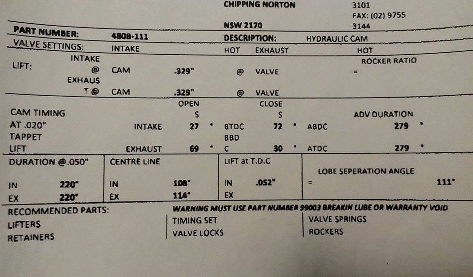

The owner is a clever sort and takes advice well. It liked 20 degrees through the top too under heavy throttle no probs. Sign of a well chosen cam with the higher compHolden202T wrote:that's a good result!
Here's the cam card. also got a vid from the customer on his way home too lol
Re: Sharing is caring
good old camtech
yeah should be pretty reasonable for a streeter .... is it auto or manual ?
