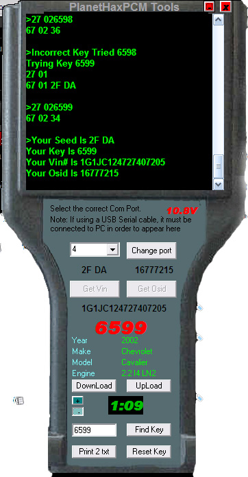

Some nice work there! Was the 23 hours to find the key just lucky that you picked the right start value? 23 hours out of a possible week is a terrific result.
planethax
- Posts: 41
- Joined: Fri Jan 01, 2010 2:45 am
Re: Seed/Key Osid and Vin retrieval via Elm
the 4 I have done, the max was 23 hours, min was just under 8 hours.
Most Keys pretty low, for example the 2 3400 pcms the one key was 115D very early, the second was 42CE, but since Seed was higher, I took a chance and started at 3000
The longest was a 2200 Seed was 2F DA and Key 6599 (different algo)
Here is the latest Update, probably last for awhile till I can read/write Pcm.

well i used this program on a locked ecu and it just took 38hrs to find the key. put it into efilive and unlocked it straight away.
