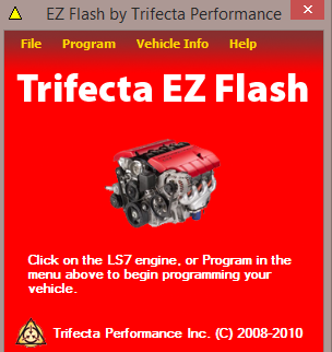

Its not this mob is it?
Deceiving little app. Gets alot larger after it decompresses at runtime.
