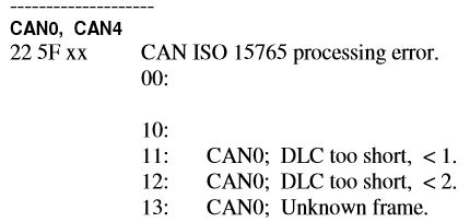

the 22 5F 13 is an error code relating to the avt having trouble with multi frame responses.

Beat me to it. Just getting ready for work and thinking the 22 5F sounded like an error code.
So
0B = length
00 = another status code?
05 E8 FE 00 0C A2 00 E1 89 00 = 0B bytes payload where
05E = source can ID?
8FE = target can ID (or vice versa)
and followed by 22 5F 13 = Can0 Unknown frame error.
And the AVT has processed and stripped the checksums.
