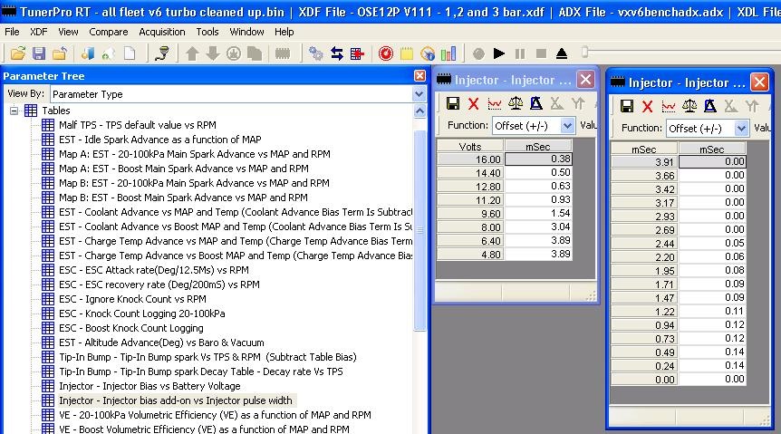

Posts: 5714
Re: Deka 60's Injector Values
this is what i run on one stock cam v6 turbo runs exactly the same as it did with stock injectors with no ve table changes off boost
Posts: 3364
cars: VR Commodore V8
Post by Dylan »
Thanks for the info delcowizzid. Definetely some different results here. I guess the best way to do it is to send them to The1 for proper testing.
Obviously no 2 sets are the same but some big differences here.
