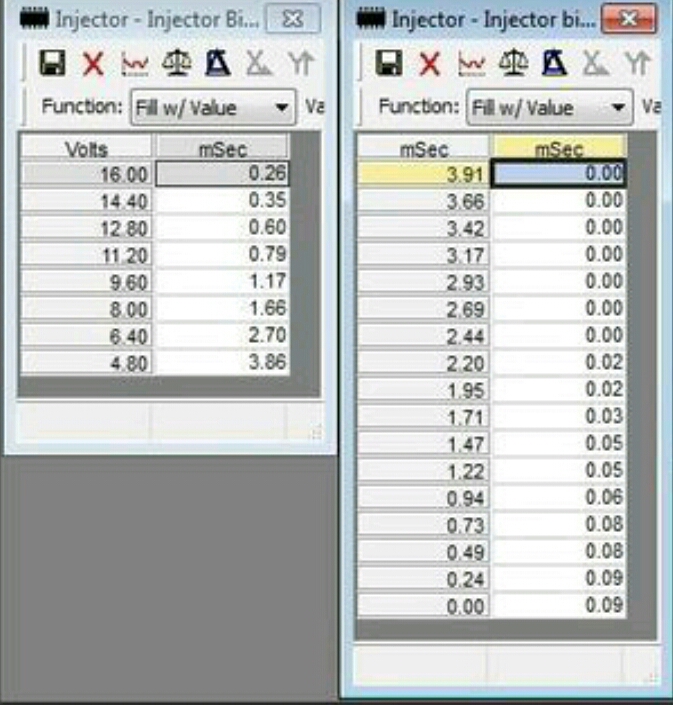

Im tuning a 4race car for a mate and getting everything set up before we hire a track to tune it properly.
We've fitted Siemens Deka 60. VR V6 on methanol running12P.
I've found different values on Google searches none from Siemens though.
I found some values on here so I went with them.
Hopefully someone has some genuine data. Every chance I have the correct figures and just plainly don't know what im doing!
The car idles pretty crook so i set the idle very rich. It then idled reasonable but after about 1 minute it dies with a cough.
It runs better with stock injector values. I had a play with single fire mode at idle with some values I found on here from VL400 but made it slightly worse.
All help appreciated. They are a common injector so maybe someone has some proven values.
Below is a shot of the values im using.

Running the deka 60 on my l67 on e 85.this voltage vs offset 4.8-3.89.6.4-3.62.8.0-3.11.9.6-2.24.11.2-1.40.12.8-1.01.14.4-0.70.16-0.52.injector rate .090 second/gram that's kalmaker sp3.if it's bpc with the 3.8v6 its.057.you won't need to use single fire mode at idle.just zero all the msec/msec table out.ive tuned with wideband and driven many kms with above values good economy for e85 idles and runs well pressure reg is factory l67 3.5 bar.i assume you know you need about 2 times methanol over pump gas with mine I run full open loop tune noo2 sensor dropped all the afr to suit and decreased cranking fuel.cheers darren

I have the target AFR's set to suit methanol injector rate is around. 055 - 060 from memory.

Been doing some more Google searches. The settings I posted up top I seen on here and they match up with the values on the Siemens website. There's a few places quoting same as I posted some have different.
Where did you get your data from? I actually ran this engine on stock injector values first up and it ran better than with what I posted. I compared your figures against stock and they are closer to stock than what Siemens give you.
Which makes me think it should be a lot better.
