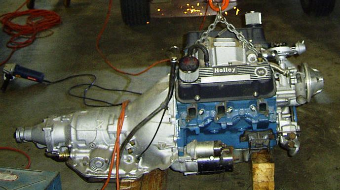

Re: V6 heads, differences.
those heads will fit this little gem I have hiding in the shed
1978 I think I worked out it was!
- Posts: 8549
well hurry up then
