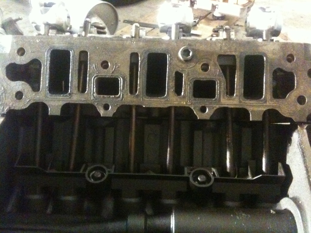

was curious to see if ecotec ones fit pre eco block and it does line up with mating surface and gasket holes pretty good. Even the push rods line up well on 4 out of 6. the 2 that dont is due to flashing in the head which can be clearanced but still be be at weird angles.

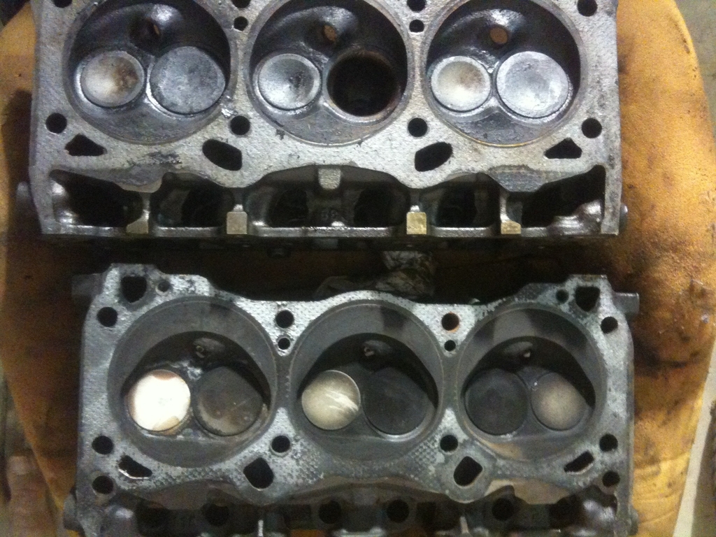

Interesting seeing how different the combustion chambers are, frankly how shit the VN-VR ones are
Also the saying ecotec ones crack due to lack of meat between valves. I think not after seeing how little the previous generation heads are and thats more so given than the ecotec heads I have are the "series 3" big valve heads.
the spark plug is better placed, further in the chamber in ecotec heads. Ports are 5mm longer in ecotec. They use kidney chambers compared to wedge as VN-VR use.
The chamber is heaps more unshrouded and shaped to induce swirl. The chamber is bigger as well but the ecotec use almost flat tops, only a fraction of mm dish.

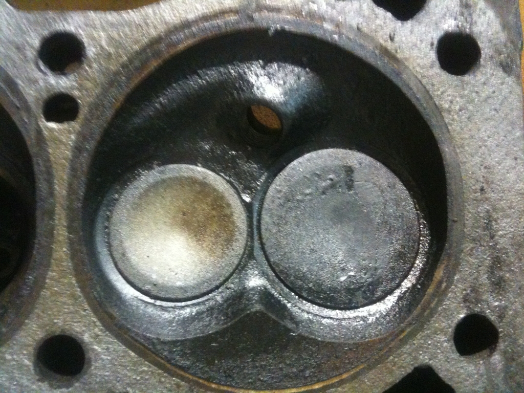

VP head.
VY head with larger valves than normal ecotec.

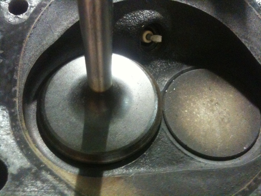

ecotec 1.84" ? on top of VP valve

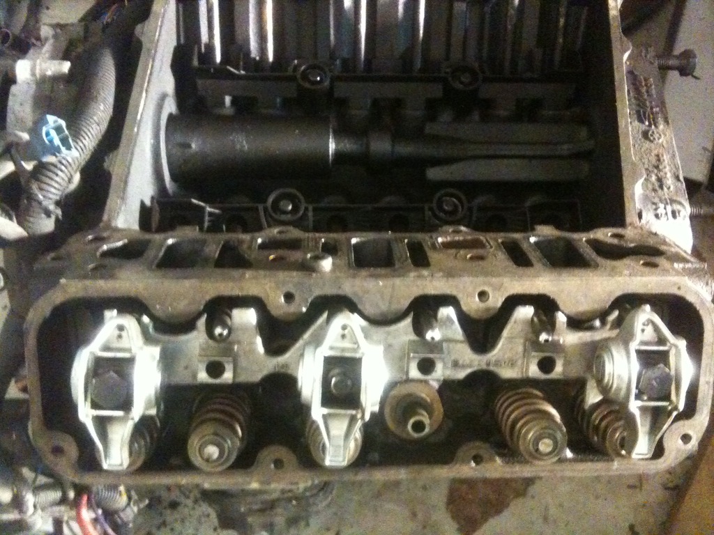

ecotec head on pre ecotec block.
pushrod alignment. Just an idea, but if it were to work longer push rods are needed, custom intake, some minor clearanceing needed to clear those angled ones. Custom cam as the ends of the pre ecotec heads have intake and exhaust lobs swapped compared to ecotec. Look at the valve placement in both heads.
