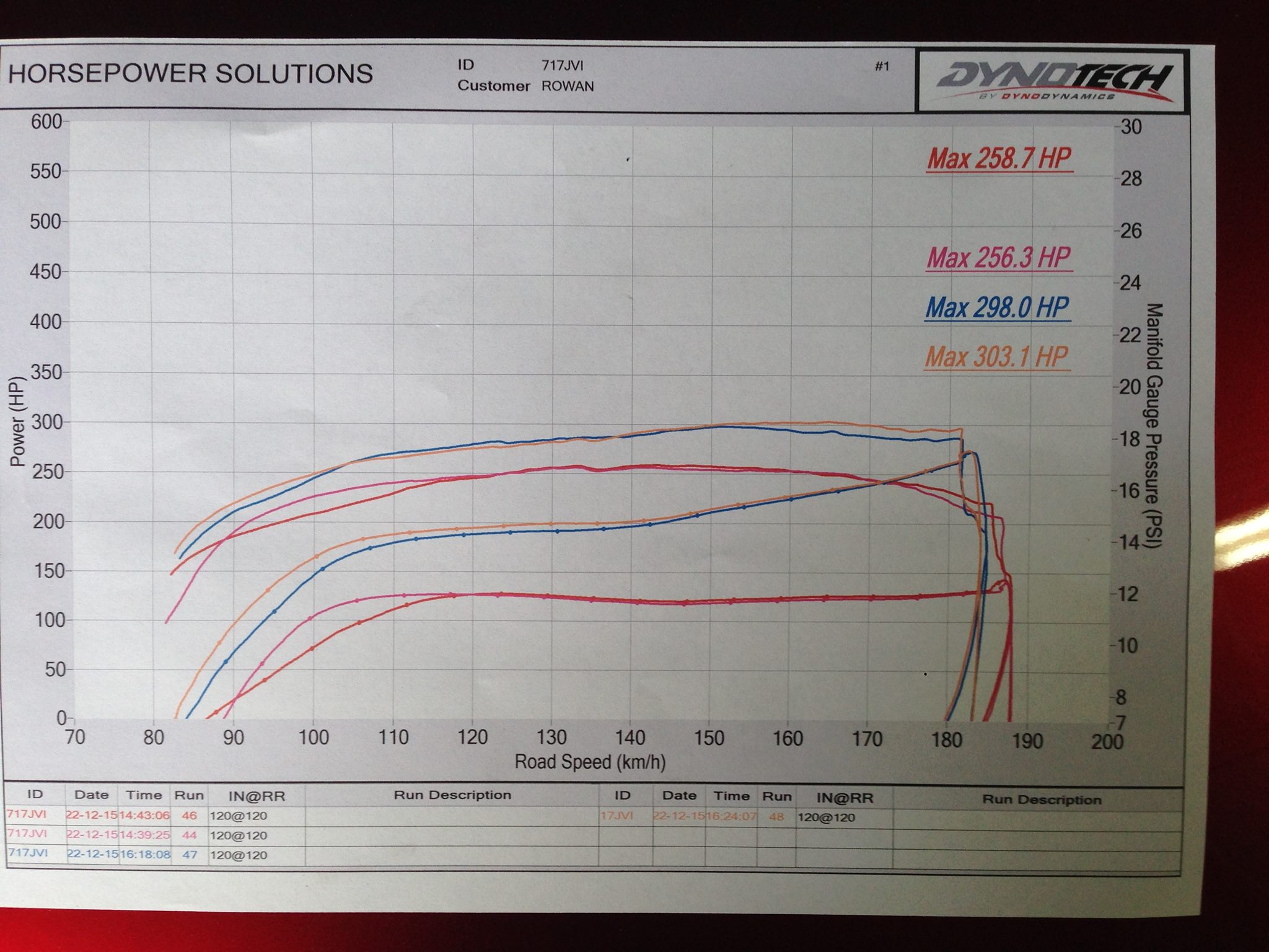

Re: 3" Mandrel Bent Steel L67 M90 Elbow
Hey thanks for that!!TdracerTd wrote:He uses a 100mm throttle body, and the blower inlet is 100mm also. Best to just get one off him. Lots of development went into producing them, and is ongoing. Many blower cases we lost in the process. The price he's charging is quite reasonable for the work involved if that's the way you want to go.0081 wrote:What throttle body did he use.
Did he port the inlet to the blower also?
I saw a great gain from a stock ported one and the ls1 throttle body, this one appears to have a better design from the start.
Yep it is all 100mm from the TB to the case.
I have destroyed a few cases now to get the final result, but to get it right takes time and testing.
I have done some Kalmaker logs and some back to back dyno testing to show what the difference is between a stock setup and the Brushworks M90.
I think it is important to show real data when doing modifications so that people get the facts and not just some number that is a mere guess....
If you have Facebook you can check out all the information here, just need to scroll down to find it all.
https://www.facebook.com/brushworkz/
For those that may not have FB, here is some of the information.
Dyno run https://www.youtube.com/watch?v=FjTi4tJ ... e=youtu.be
Dyno Sheet. Log one, stock blower 2.55 pulley
https://www.youtube.com/watch?v=4l-W8YGrJEc
Log 2 Brushworks M90 2.55 pulley.
The test was done on the same day as we swapped over the blower at the dyno so temps and so forth stayed as close as possible
https://www.youtube.com/watch?v=d70tP6m6RYM

Some nice gains there!! Looks like there could be more to come by tailoring supporting mods?
Decicrate
- Posts: 8
- Joined: Mon May 30, 2011 10:43 pm
Yeah, now it comes down to what else has been done.TdracerTd wrote:Some nice gains there!! Looks like there could be more to come by tailoring supporting mods?
I am doing an exhaust on Rowans car this weekend and he has fitted the BW cam.
I think his barrel cooler will run out of flow, but we are going to shove some E85 into it and see if what we end up with!!

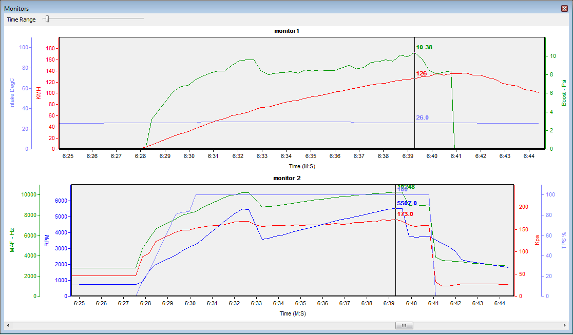

OK, so I bolted this sucker on today unfortunately there were some hiccups along the way
Got the map sensor on and working this morning with the logger, all good there, however the car didn't want to start when I turned the key, it just ticked like it had a flat battery.... Tried it again and it did start the 2nd time. This battery has been on it's way out so I didn't think much off it and went for a spin around the block. Anyway, this is the result: Came home and time for breakie.... Finally got around to bolting the new elbow on after lunch but then the car didn't want to start again..... Long story short it now has a new battery but noticed a few changes, for starters it was idling at a lower kpa than with the old battery? Really not sure what the go is there as the MAP sensor reads exactly the same as before with only the ignition on.
Took my boy up the road to Fitness plus as he wanted to buy a weight bench etc and managed to give it a good boot full coming up the motorway onramp unfortunately didn't actually keep my boot planted. Also, air intake temps were a lot higher this afternoon, 44° C Vs 26° C this morning. So between the battery issue and air temps and not keeping my boot planted the data isn't really comparable but I'll post a screen shot of the results anyway. So I'm going to have to log another run when it's cooler to get some decent comparable data, hopefully the tune will have settle down after a full reset with the battery been changed too. Unfortunately the rain has set in here so no more testing today.
