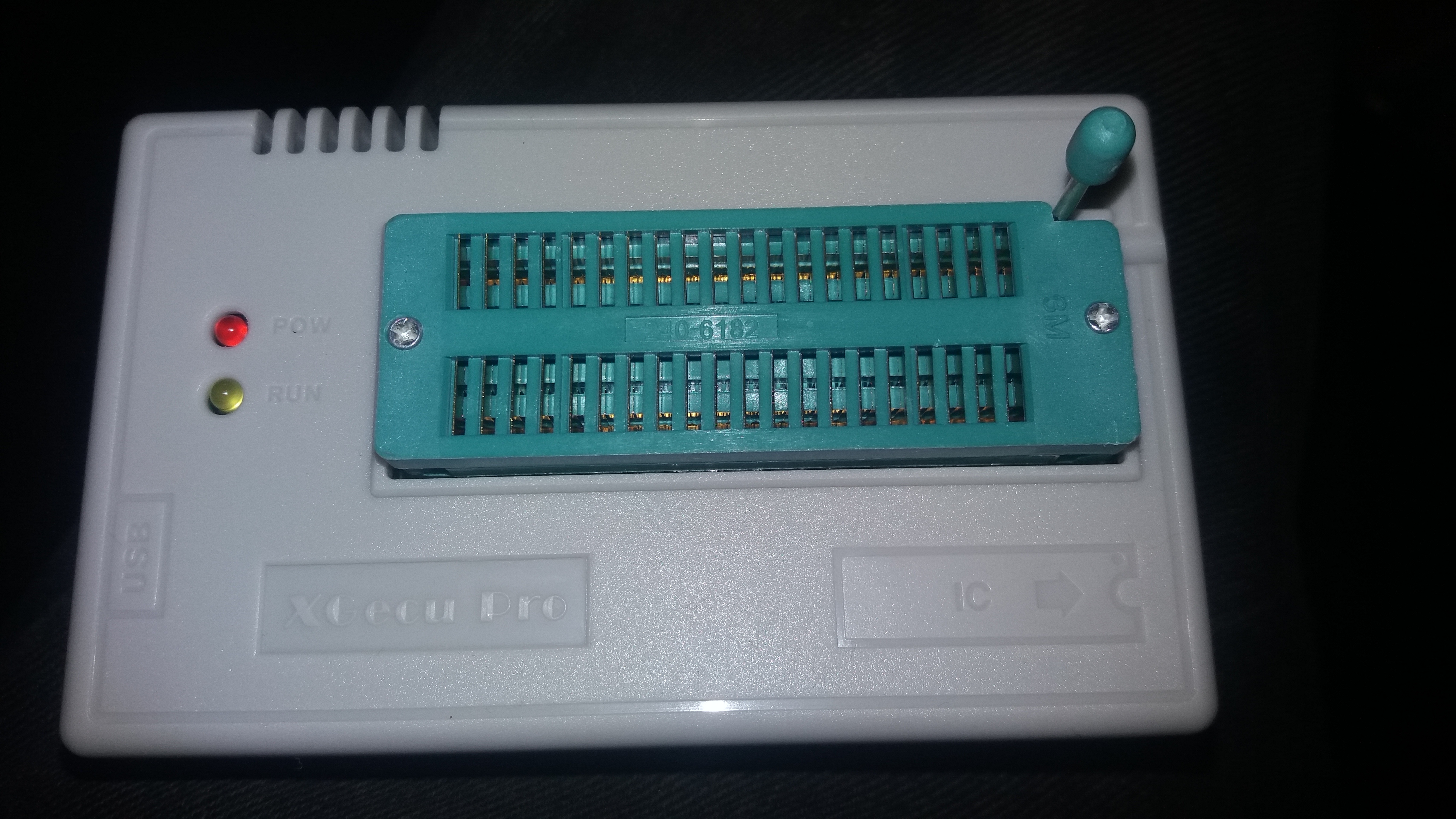

Has worked for me with EEPROM SST27SF010. And Dallas DS1245Y

I just bought another one of these after my last one off ebay never turned up.hopefully this one shows up.
Then I went to get the software for it and seen the website says they have not sold these since Feb 2018 due to copies and everything for sale is counterfeit .didn't bother me too much till I read that the software will brick any non genuine programmer here we go again ftdi all over again lol.i had a bit of a search and there's a fix on the eevblog forum if anyone's programmer gets bricked cause its even killing genuine programmers that have had the firmware swapped from cs to A and some that were bought as the A version

Oh and you can program chips on the go with your Android phone or tablet it if you download wizardprog off play store its free and man it looks flash as hell compared to any programmer software lol

I have got "minipro setup 670" (version 6.70).
I downloaded it from their website on 8/3/2018 for use with my minipro I purchased around the same time.
Either my minipro is one of the last genuine ones or the software is an earlier version not bricking the fakes, because I've had no issues.
What version is the latest software?
Did you want a copy of this?
- Posts: 5714
Re: Mini Review TL866 Programmer
May as well send me a copy to save as a backup .its up to 6.85 now was not long after your version that the bricking routine got added to the software

I got really excited about new software for the tl866 there but it looks like the ds1245 and the chips in the p01 and p59 pcms are all not supported by wizzard prog. The official app says 15000+ supported devices, wizardprog has 2959 devices listed at the moment. Hopefully the author can keep working on it.

His email address is in the software about menu I didn't even realise there was no Dallas section lol

After buying 3 one finally showed up now I can burn tunes without firing up my 20 year old dinosaur with win xp lol
And it's supposedly the new tl866 II plus that's unclonable

Hi guys what eeprom do I select for a Ecotec memcals I know it's a 27c010 but what brand?
'quipt4it
- Posts: 675
Factory Ecotecs use a FM27c010 Eprom.
If you know it's a 27c010 but don't know the manufacturer, you can de-select the Check ID box (ie use generic).
Which programmer are you using (TL866?).
Need to UV erase chip also.
