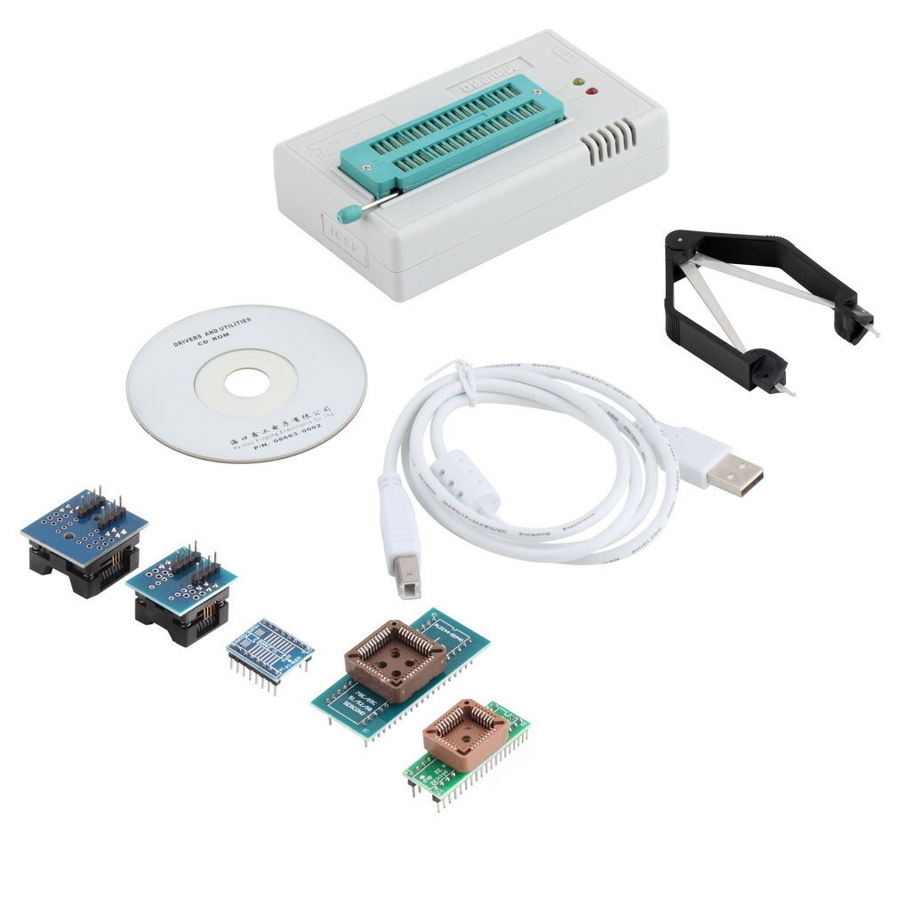

This is what $70 will get you from any one of the ebay sellers who stock them:
A lot of the smarts is done in firmware, so when you first install the program and connect the programmer you'll probably be prompted to update the firmware. And don't bother installing the windows program from the supplied CD, it will be a few versions behind so better to download the latest version from the start.
It doesn't need external power, just a single USB cable.

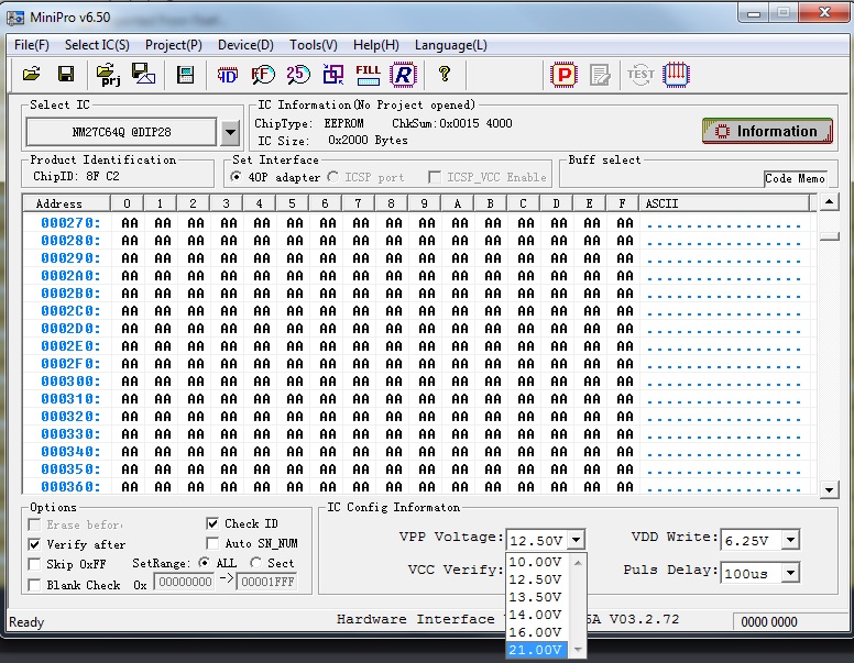

The GUI is pretty reasonable, but a few minor complaints. First, when you click "read" it opens a window with a few options, and two buttons - "read" and "cancel". Click read to read, but once that's complete you then have to click cancel to close the window. This is a common theme across the program, and a little annoying but not a huge issue.
My second gripe is that it IDs the chip prior to a read, and if you've selected the wrong variation of a chip it fails with an incorrect ID. It shows the ID bytes and you can then consult google to work out exactly what chip you have, but it would be handy if the program said "chip type xxxxxx detected". You can also skip the ID check, but still....
This is the interface - it has all the features you'd expect like read, blank/blank check, verify, pattern fill, file and buffer offset, serial number increment, auto-ID serial flash etc. It can also program a variety of Atmel and PIC MCUs, and test 4000 and 74 series logic ICs.

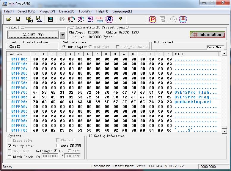

A couple more pics of the interface.
It remembers the last 10 chip types you've selected, which is a nice touch.
And gives you some control over the voltage selection:
VPP isn't infinitely variable, but should cover most applications well enough.
