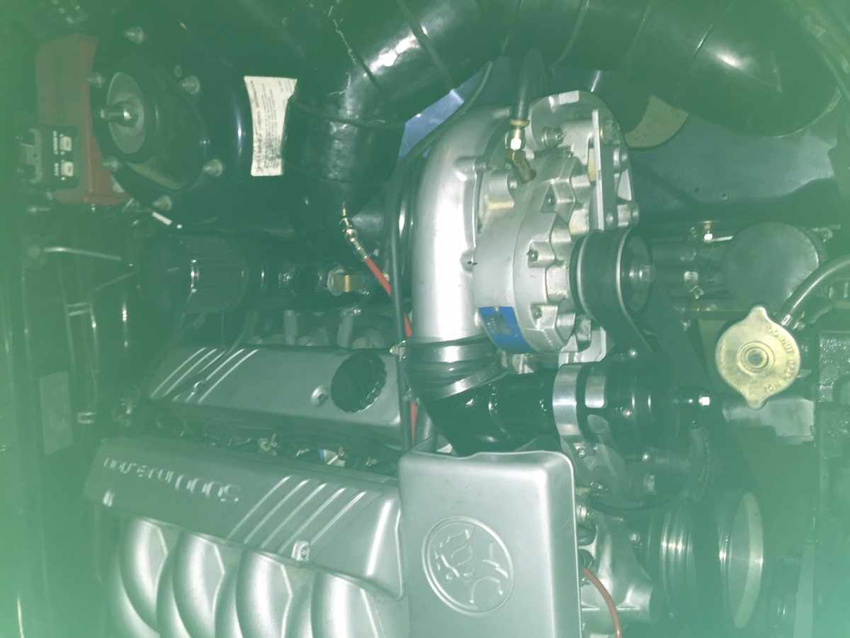

PaulR wrote:Thanks alot, yes im just seting up now for more boost, ive got a smaller pulley which will spin the blower close to 60,000rpm. should see maybe 14-15psi.
also got 80lb injectors and running on e85.
Planning on running again very soon.

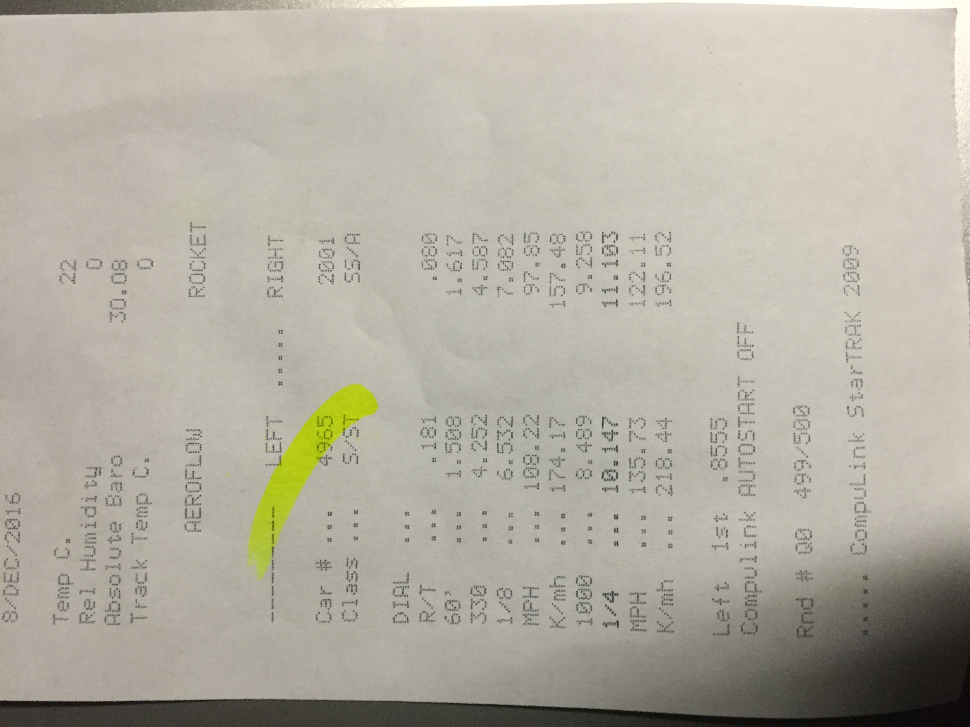

Raced on Wednesday, done quickest time yet. Spun a bit off the line, but still very Happy

Thanks, yeah the 60 foot times have been inconsistent last few times ive raced, ive done a best of 1.44 60 foot then some are 1.6?. im going to check out all the diff bushes and mounts and maybe get some Mcdonalds Bros tubular Trailing arms

Time for an update. Ended up removing the front mount and running the blower straight in the t/b. picked up about 2 pound boost, now making about 14 pound. Also hooked up a snow performance water injection kit. Air temps are a little bit higher - up to 100 deg sometimes so ive had to pull a bit of timing. But overall pretty happy ran a new pb last night
