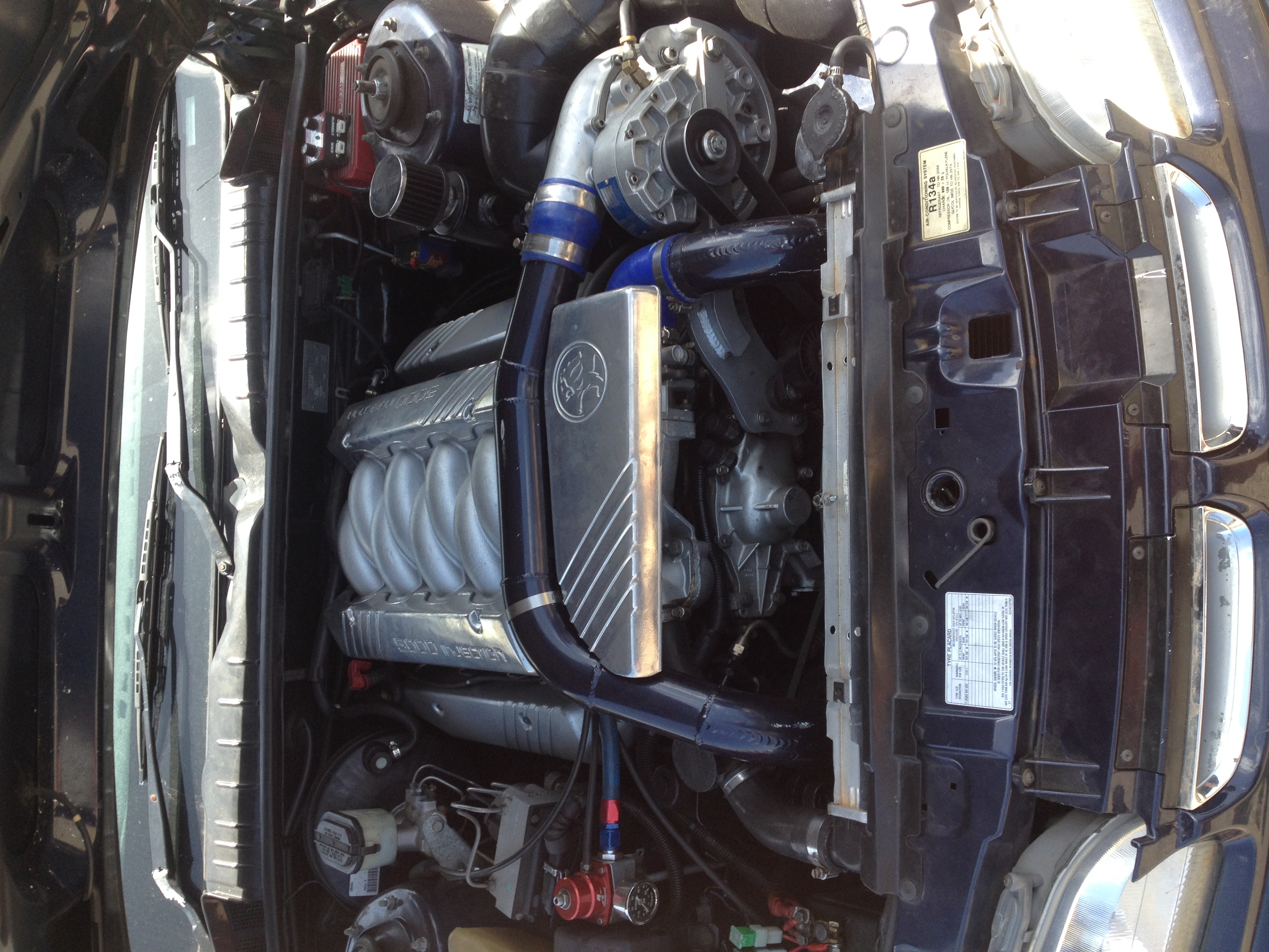

Hi all this is My Commodore
Engine - VS block, Scat Crank, Holden Rods, Probe Forged dish top Pistons 9.5 to 1 compression, Ported factory heads, std valves, 7/16 screw in studs, double valve springs, yella terra roller rockers, cometic gaskets, Camtech solid cam 238 @50 112 Lobe speration, standard manifold 70mm throttle body, vortech v2 supercharger with 928 motorsports billet impellor, 7.25inch crank pully, 2.95 supercharger pulley. makes about 12psi at 6400rpm with front mount intercooler, Msd6al and 2 step, blaster coil, twin bosch 044s, surgetank, 60lb injectors on 98 fuel. DELCO 424 ECU
Gearbox- 4L60E, 3500rpm stall, sonnax shift kit, sonnax billet servos, zpac clutch, beast shell.
Runs automatic shifting still by factory ecu - Recently changed to 11P.
Diff - Factory Borgwarner 3.7 ratio and Mini spool.
Wheels VY ss 18s street driving, weld prostars for racing 15x4 front 15x7 rear with 26x9 slick.

Thanks alot, yes im just seting up now for more boost, ive got a smaller pulley which will spin the blower close to 60,000rpm. should see maybe 14-15psi.
also got 80lb injectors and running on e85.
Planning on running again very soon.
yeah the splits are interesting others have said that aswell, i think maybe cause the short 1st gear of the 4l60e? helps with the 60 foots.
what gearbox you running?

Its hasnt been on a dyno, going off mph and race weight of 1600kg including driver. shows about 550hp on the moroso calculator.

The electronic auto took a while to get it working good, rebuilt twice over past few years, first time was the sprag bearing failed, fitted a sonnax heavy duty 2-3 shift valve that helps with this and second time was a 3-4 clutch failure, using a zpac clutch still for now. there is an upgrade drum now which holds extra clutches.
As for programing using the 11p its awsome, just had to spend the time logging and adjusting shift points etc to get it right.
Runs are Very consistent and hard to beat compared to manually shifting
