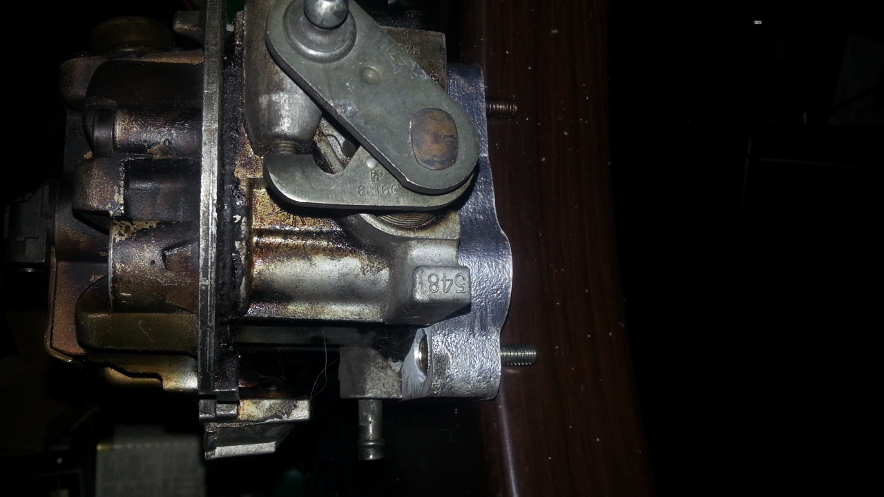

Beautifull! Just need some m9 rod and she's done.

Turns out m9 rod doesn't exist... why does a tap&die set have 9mm tools!?!?! Helicoil set inbound. Stronger threads so not all bad...
