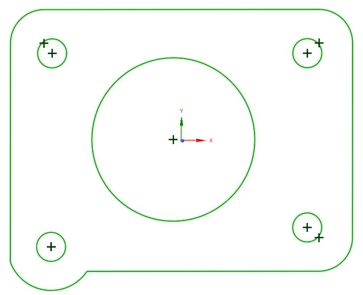

We start by drawing up both flanges in CAD.
TBI Flange.JPG (19.38 KiB) Viewed 9798 times
AMR Flange.JPG (33.98 KiB) Viewed 9798 times

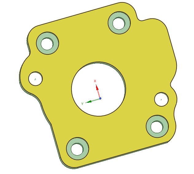

Then we merge them so no support bolts are interfering, no breach of any sealed surfaces, add clearance for both the bolt head and the socket to tighten them. Add a mm either side for finishing on the mill/lathe and we're almost ready.

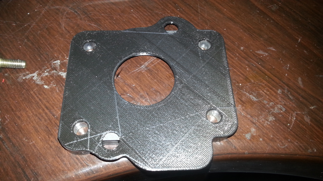

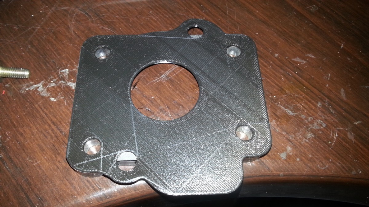

We print a 1mm slice to confirm everything is lined up and no gross errors.
Now I fill in the through holes and add a dimple to locate the drill when drilling. I do this because every edge must have a draft angle to help removal from the sand. It is just easier not to have complete small diameter through holes and instead drill them in the finishing stage.
I'm printing the master pattern now, Should be done in an hour or so. I'll add more photo's when I'm ready to make the sand molds and pour them.

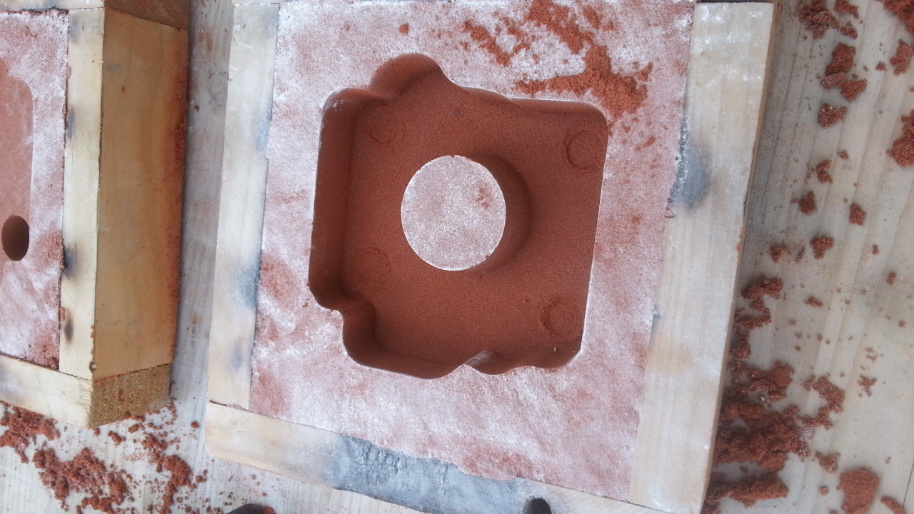

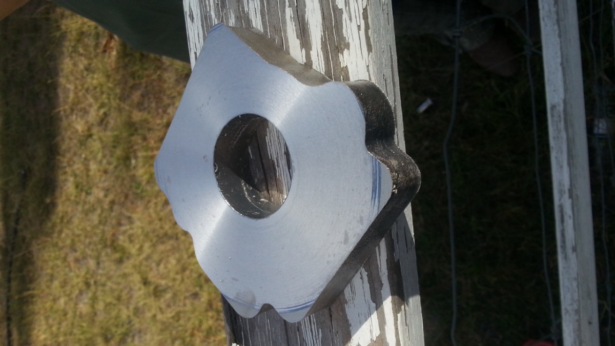

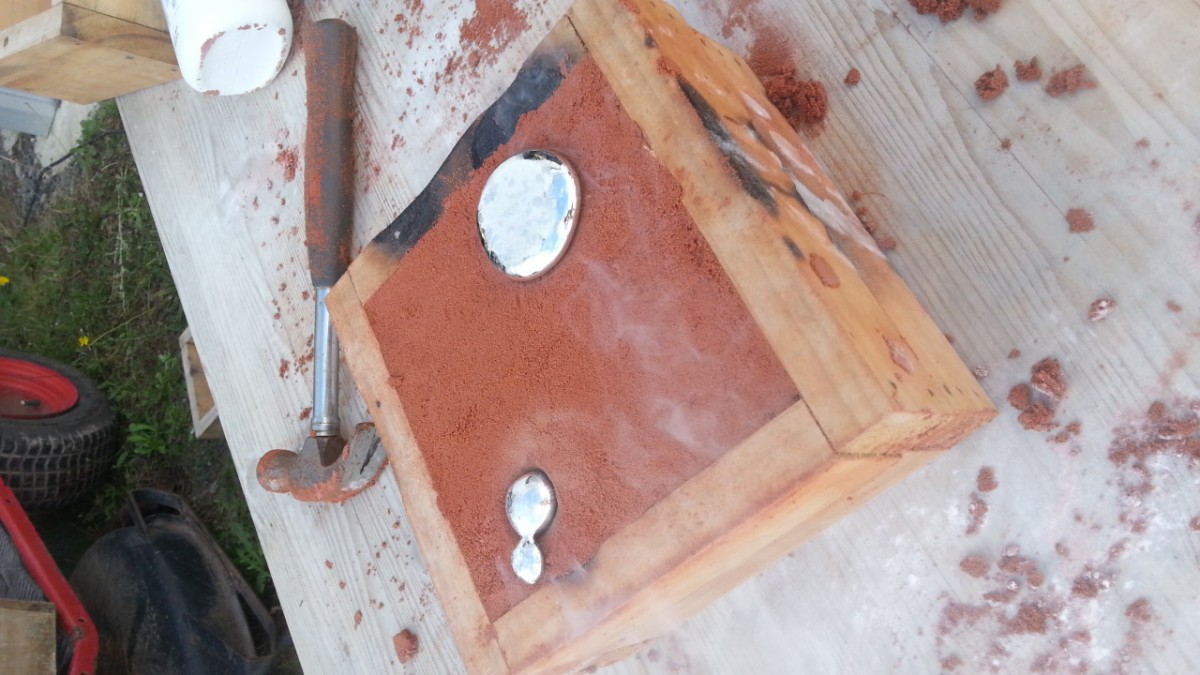

OK, so a bit of a backstory:

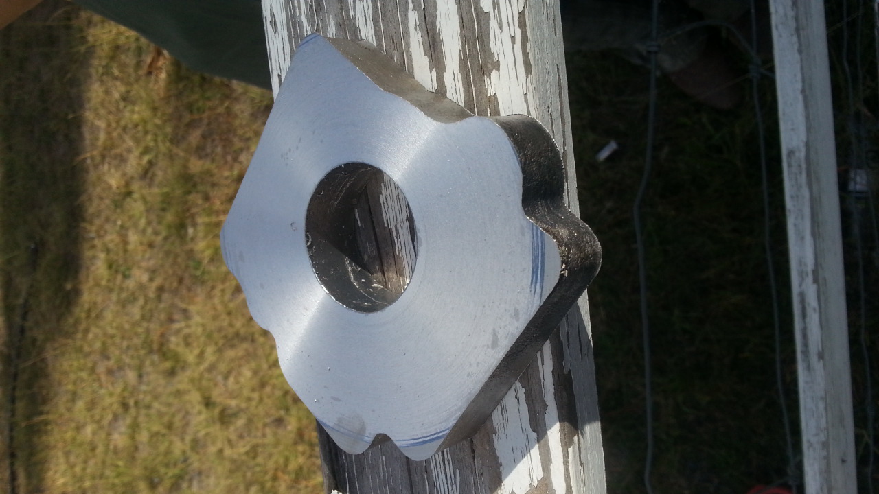

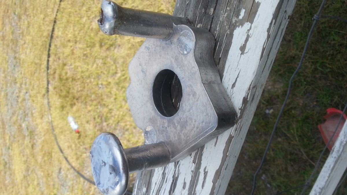

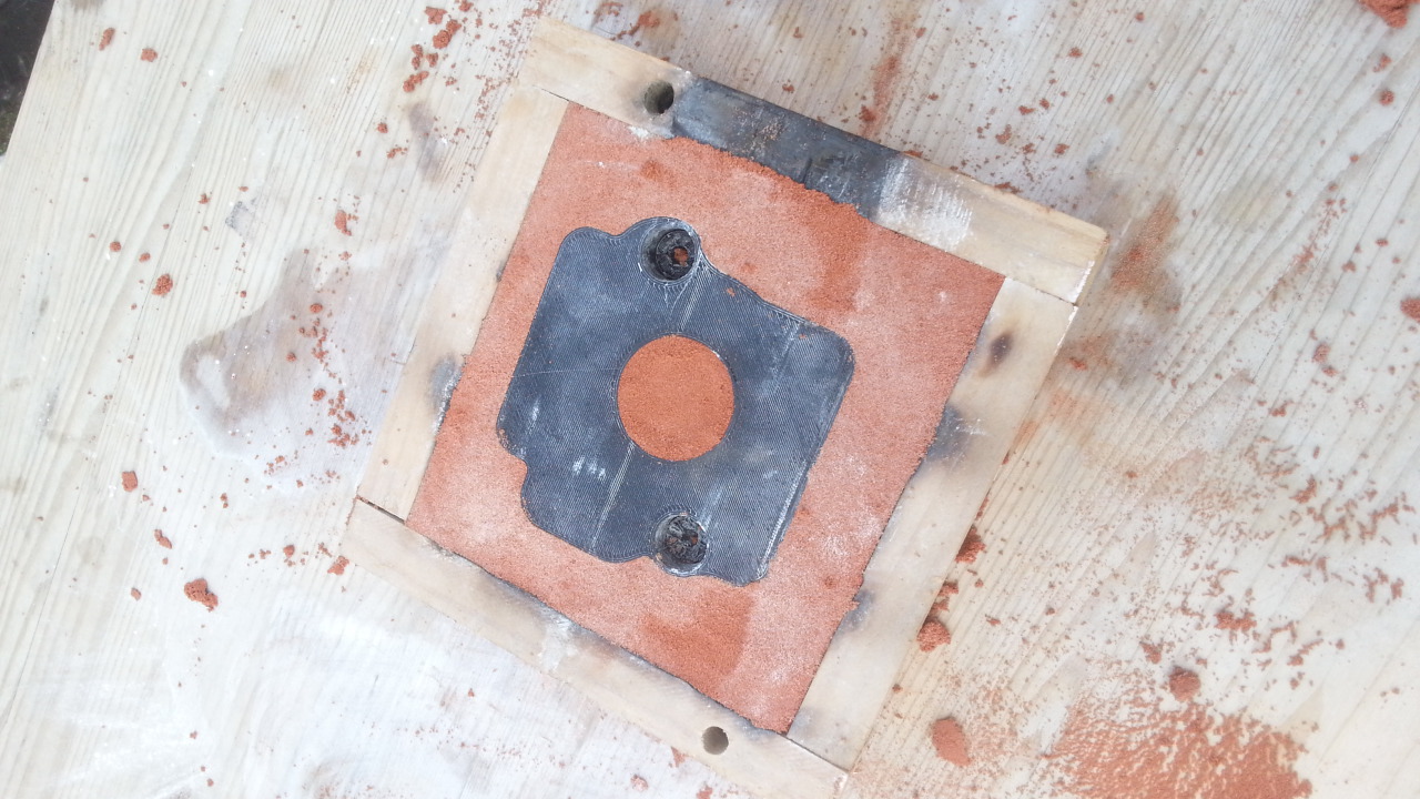

I usually cast with what is known as 'greensand'. This is clay bonded sand with water to help bind it all together. There are limits to the detail and surface finish you can achieve with greensand due to the required porisity of the sand to aid in venting when the 900deg metal gets poured into the mold. This means course grain sand and due to the water to bind it, it evaporates and requires constant mulling (compacting and breaking). It is hard work! but it works well.
I invested the money and got 15kgs of 'Petrobond' binder (~$220 in shipping alone from the US!!!). This works in the same way as greensand but uses synthetic 2-stroke oil to bind. No evaporation, no constant mulling. No water means no steam which means extremely fine grade sand (I'm using al-ox 120grit sand blasting media) and almost mirror surface finish. You can easily cast the detail off a 10c piece. I can even see my fingerprints in the casting! Being my first time mixing this oil bonded sand I ran into a few issues. I'm still working out why there isn't much strength to my sand. Consequently, Some parts of my mold couldn't be achieved. Anyway, On with the show!
So not exactly what I wanted, Now I have to drill the holes manually :cry:
I'll have to add more draft in my next print to make up for the weak sand. Also, I printed in PLA rather than ABS. The neat thing with ABS is you can acetone vapour polish it which gives it a very hard mirror shell and sand won't stick to it. You can get away with some vertical edges using that technique.
I might re-do my master and do another pour tomorrow. Then on with the more complicated manifolds!
