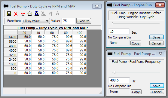

Certainly sounds like you are exceeding the reg return. For 11P I have a table of RPM vs MAP and can adjust the DC, which a MOSFET circuit PWMs the actual pump.OZ38 wrote:Reading all your info here is handy for me as I have recently fitted a larger pump to my VS V6 via surge tank set up. I notice the fuel pressure runs at around 46.5 psi now at idle where as before with just stock pump it was around 34 - 36 psi. So figure like you did the reg is being over pressured.

The factory method is a two speed setup, they look at fuel flow and if it exceeds a set point goes to high speed. The PCM sends a PWM signal to the fuel pump controller but I dont know if that then PWMs the pump or just switches in a series resistor to run the pump at a lower voltage and hence lower speed (Toyota do it this way).
The new controller uses a driver designed for the task so hopefully should work a bit better than an SSR. Will keep you posted!Holden202T wrote:yeah i'd definitely be keen to try one too, as you know in the past my attempts at fuel pump speed controllers did get toasty with the 2 x 044's!
