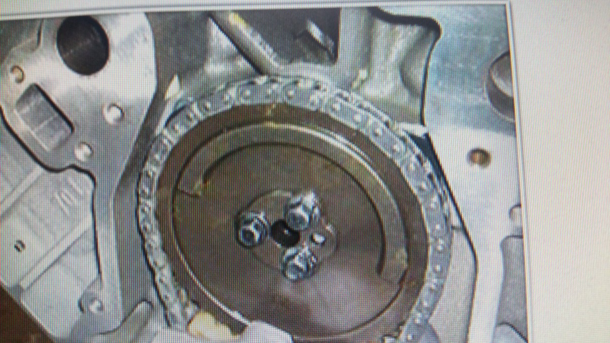

Quick google search looks like the cam trigger wheel does the long pulse. Raised section is half way around the wheel.

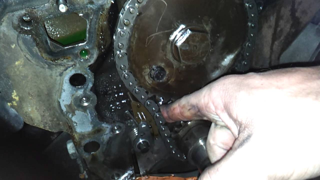

that doesn't make sense though because the magnet in the cam wheel is like 10mm in diameter max, it passes the sensor fro no more than 20 degrees I reckon ....

Picks I found are a raised section half way around the wheel not so much a casting on the cam. Hope that makes sense. I've seen a crank shaft wheel in person but never a cam wheel. I'll get a screen shot and post up.

see the magnet, its in a black plastic bit that clips into the cam wheel

Google images this. Wonder what it is off just said LS1 think it was LT1 swap.
The US seems to of got some different combos to us.
Re: 12200411 tune Disassembly (12225074)
yeah that's certainly very different to the V6 one above it!

Is that pic of yours a V6 fitted with a 0411 PCM?
