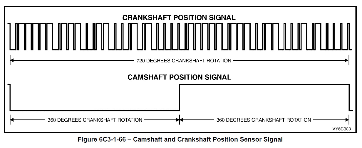

I haven't got a pic on my phone but in the Holden workshop manual is a picture of the trace from the stock V8 trigger wheels. From memory it's 720 degree crank rotation and the cam signal is on for 360 then off for 360 and so on.
There is some American bin's from factory V6's and V8's set for low res mode and different trigger set up's running the 0411 PCM.

Re: 12200411 tune Disassembly (12225074)
Thats the pic I was thinking of. Have you found a trace like that of the signal from the low res factory vehicles? I think the V8 models still ran a crank trigger but at 4 pulses. Was the V6 3 crank pulses? Both are 1 cam pulse still the V8 got that from the dissy.
that's strange, unless the passing of the sensor by the magnet in the cam just makes it change from low to high for the next revolution ?
