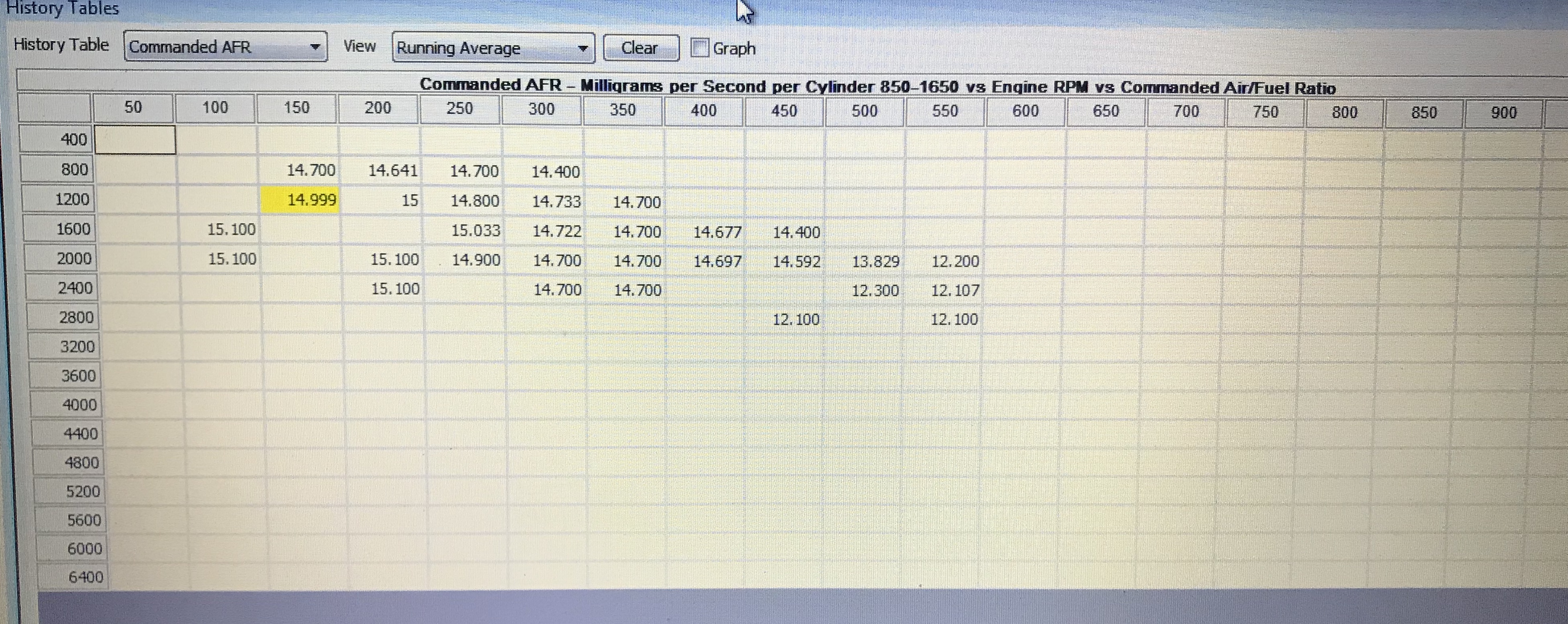

This is a stock l67 commanded afr table. Its commanding richer at 550mg. But after logging i may see that in my commanded afr table ive setup its actually commanding that at say 400mg

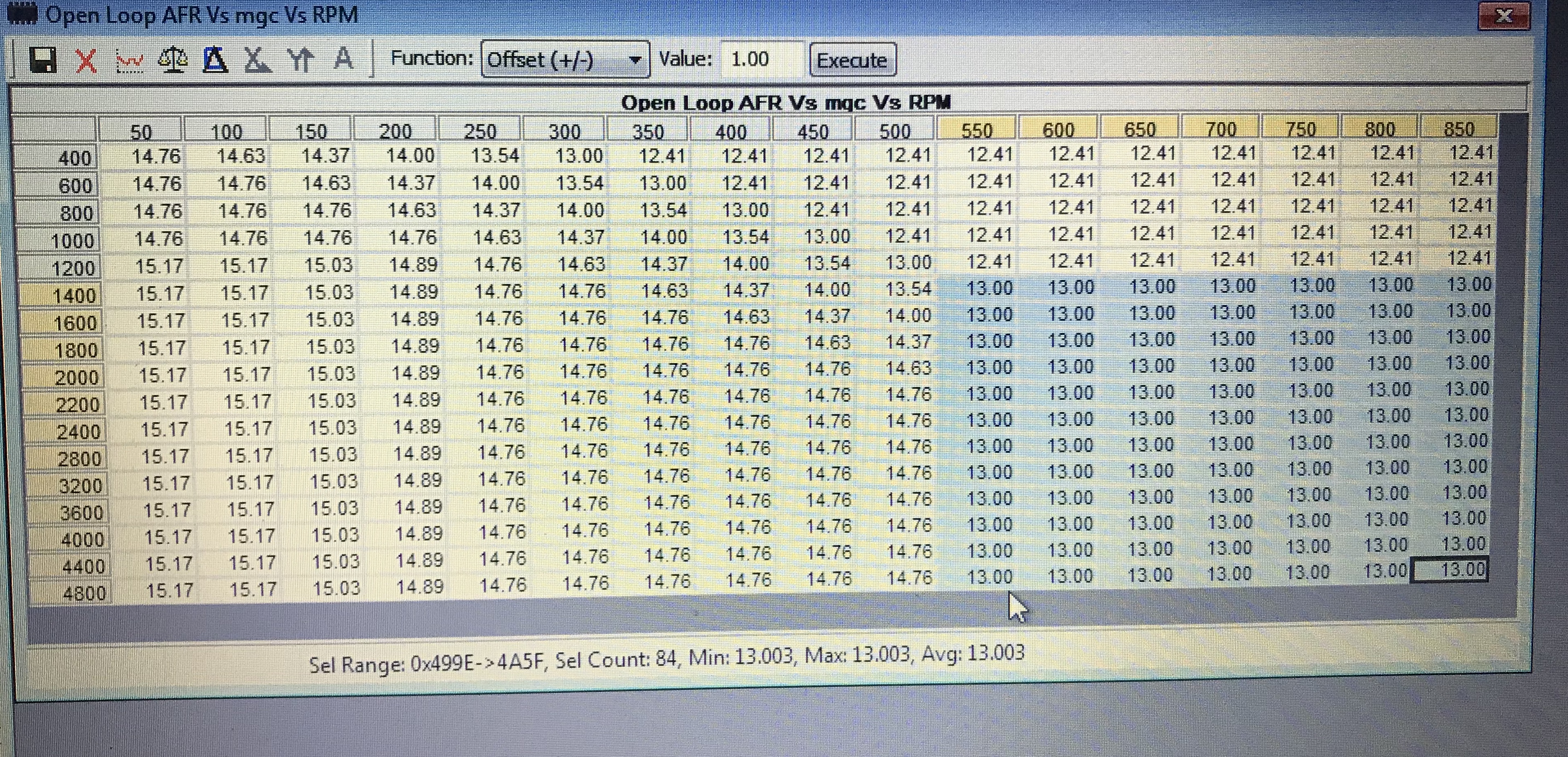

This is where I needed to set the commanded afr’s up to actually match my logs of what I was targeting on a mild l67 I’m remote tuning

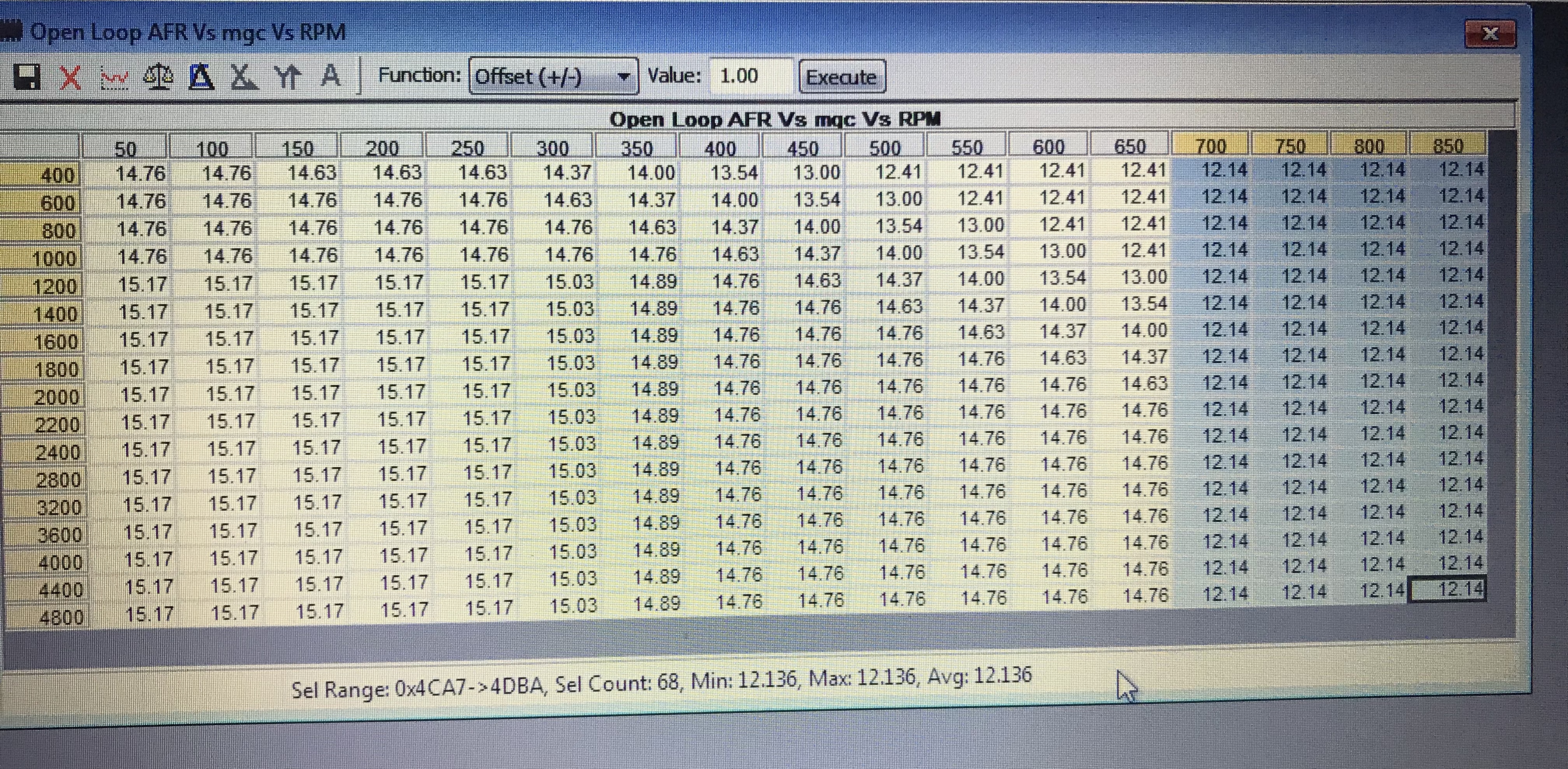

You can see that although I’m now targeting richer at 700mg, in the logs it’s actually around 500-550mg right when it’s coming onto boost.
Wade
- Posts: 1247
Re: Help Tuning VT304 with Supercharger
Once you know that your commanded afr’s are now matching what your seeing in your logs, than force open loop. Turn off lean cruise and dfco and start fine tuning the fuelling while keeping an eye on knock

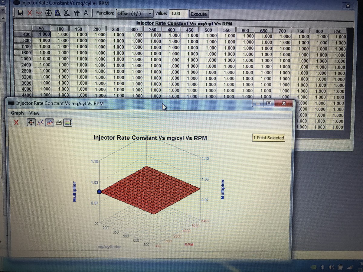

Wade
- Posts: 1247
Once I’m this stage I’ll set the injector multipliers up to 1.000 flat across the range. Get the car to operating temp and start logging

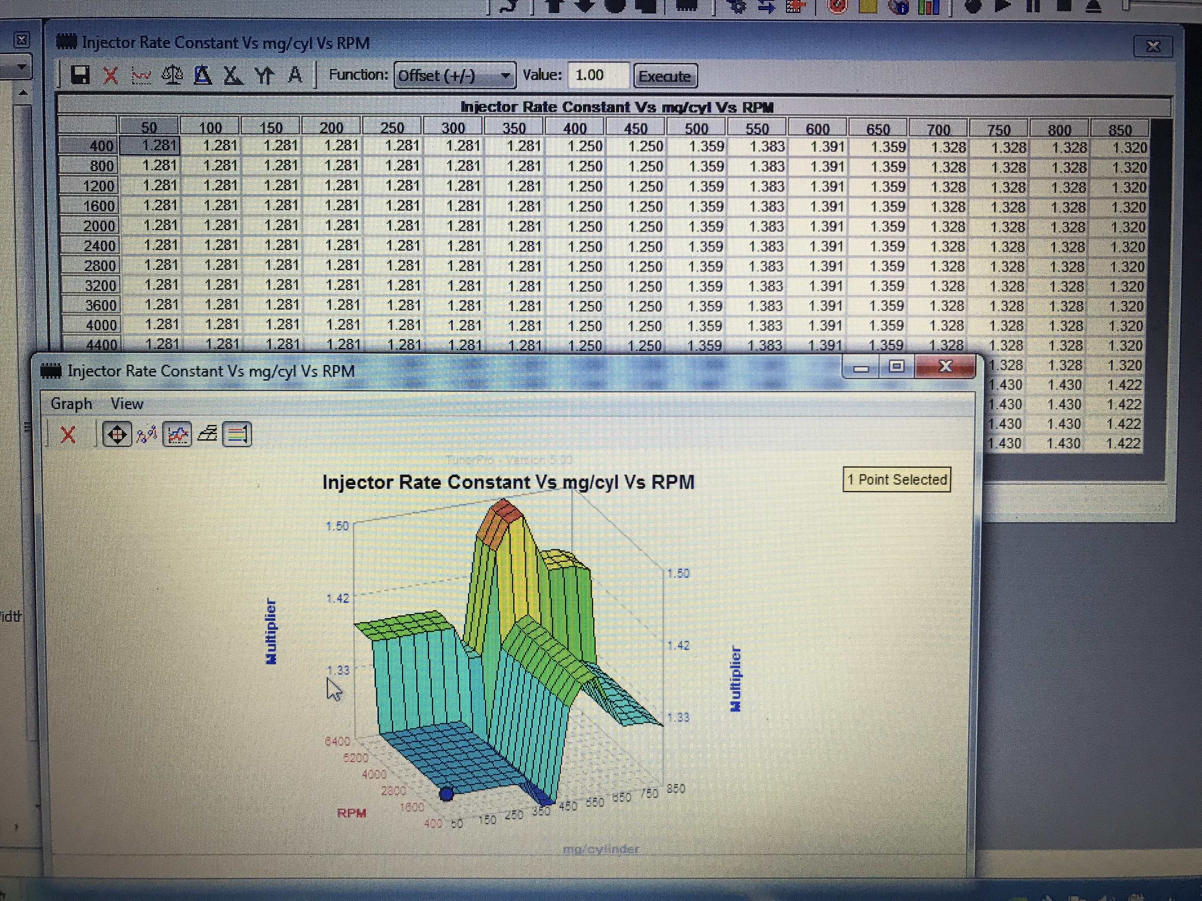

After playing back the log I check my wideband readings and select both running average and running sample counts across the mg range and look for an average pattern of how much the fuel is out by. So say at 300mg the average across the rpm range is -5% and say at 700mg it’s out by -2%. I than use the injector multiplier spread sheet and pump those numbers in across the whole table and I’ll end up having an injector multiplier that looks more like this. Doing it this way I’ve found I can get the fuelling dialed in within just a couple logs

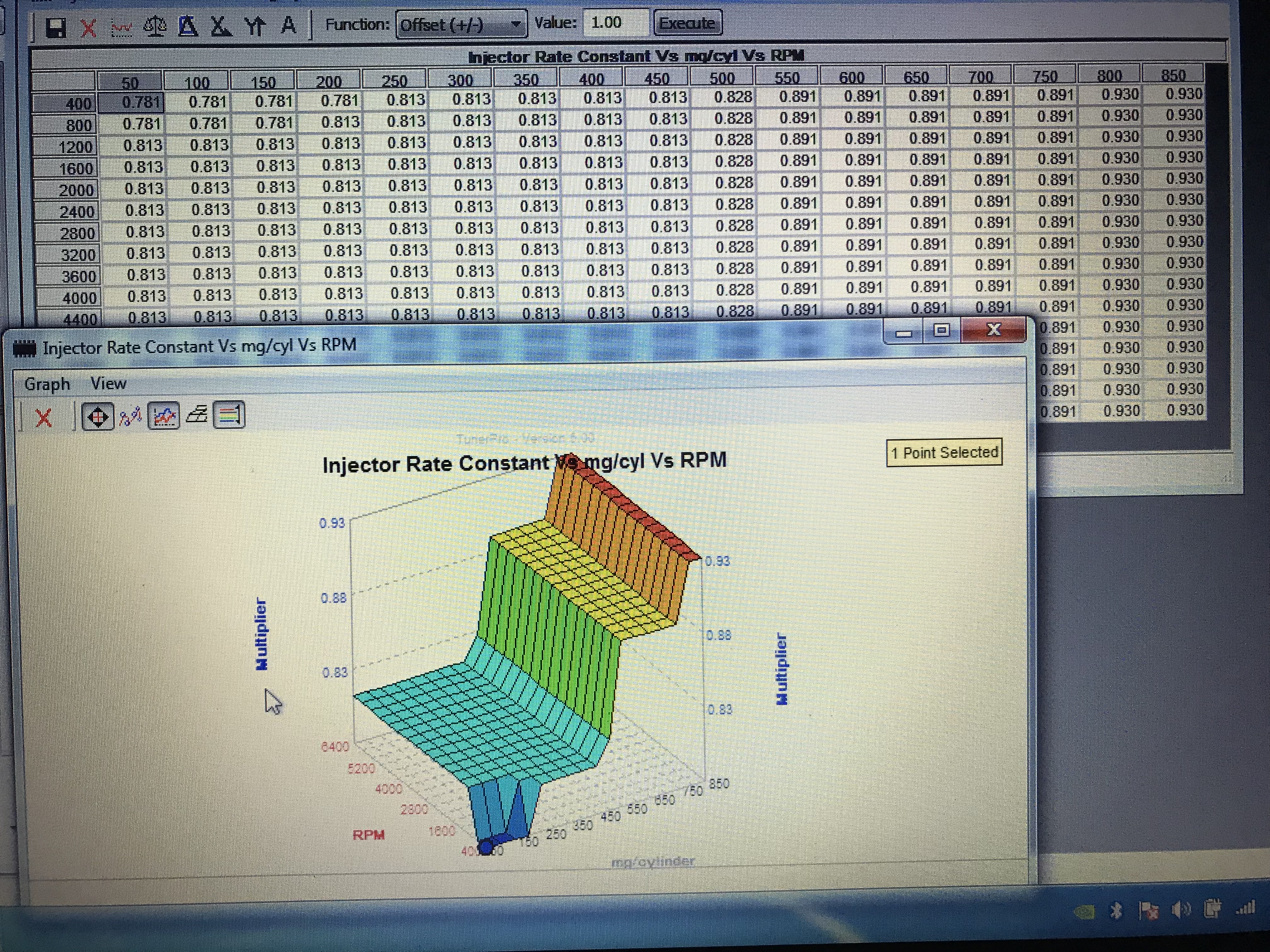

than I’ll hold a lower gear and start doing more wot runs, and repeat. I’ll than have an injector multiplier that looks like this. By this stage your fuelling should be pretty good. Hope this helps. Might not be the right way. But it sure is a fast way and works really well for me
