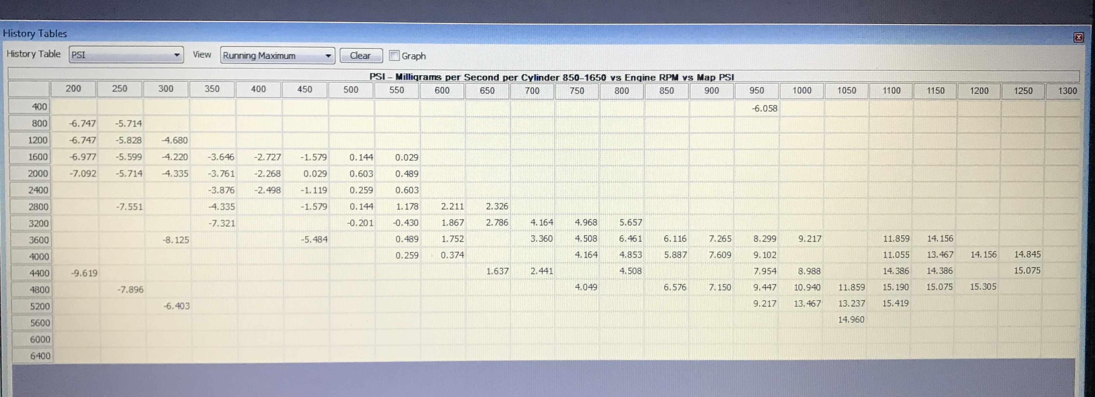

Re: Help Tuning VT304 with Supercharger
First thing i like to do is figure out when its coming onto boost. You can see its around 500mg. Than i know ive got to start running it richer at that point. So ill change the open loop commanded afr’s and power enrichment afr’s to suit from 500mg on. Than ill setup a new history table showing me the commanded afr’s.
