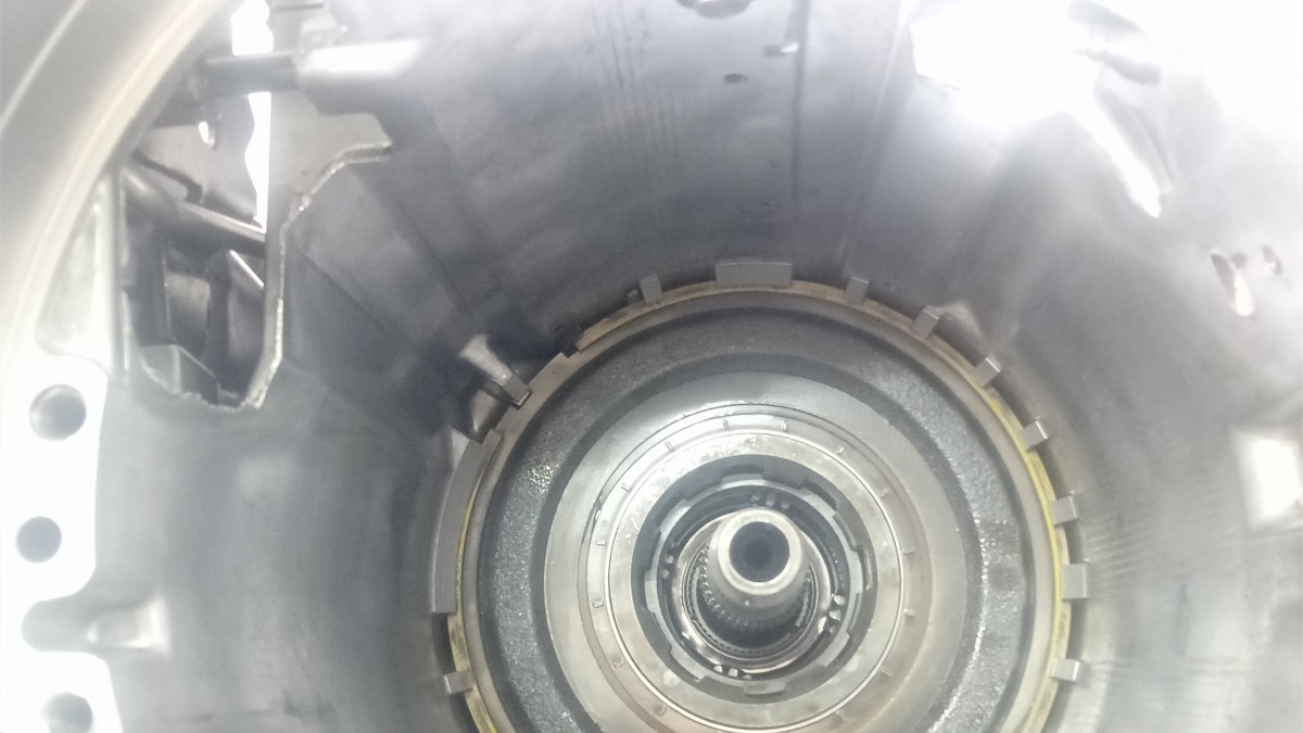

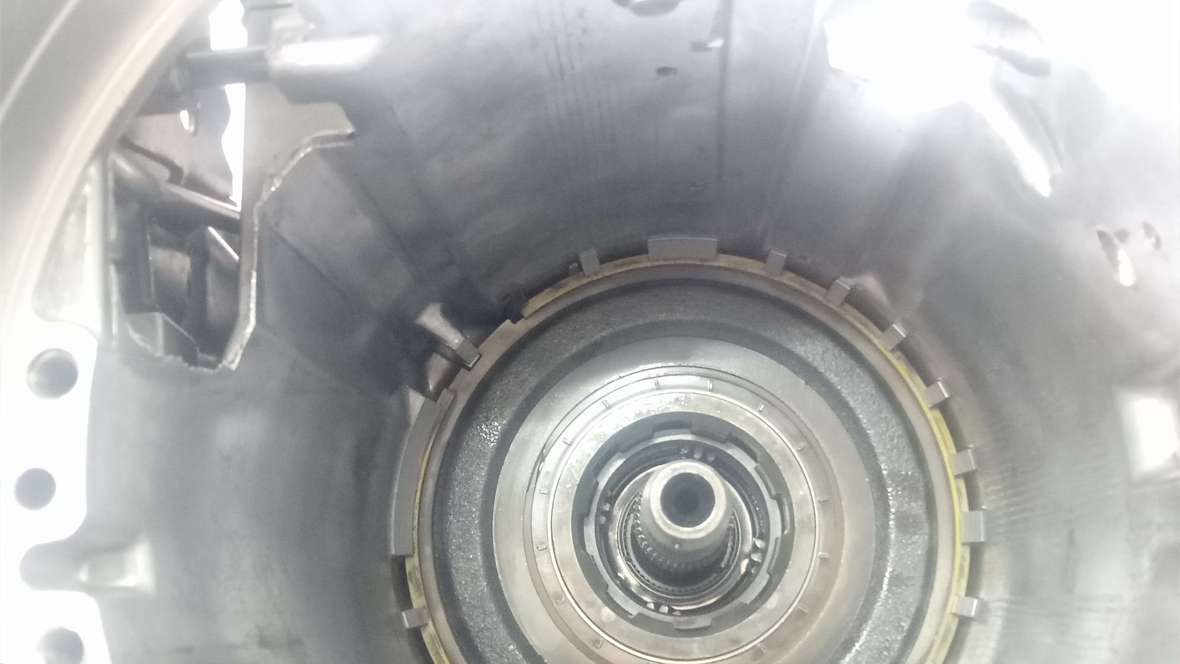

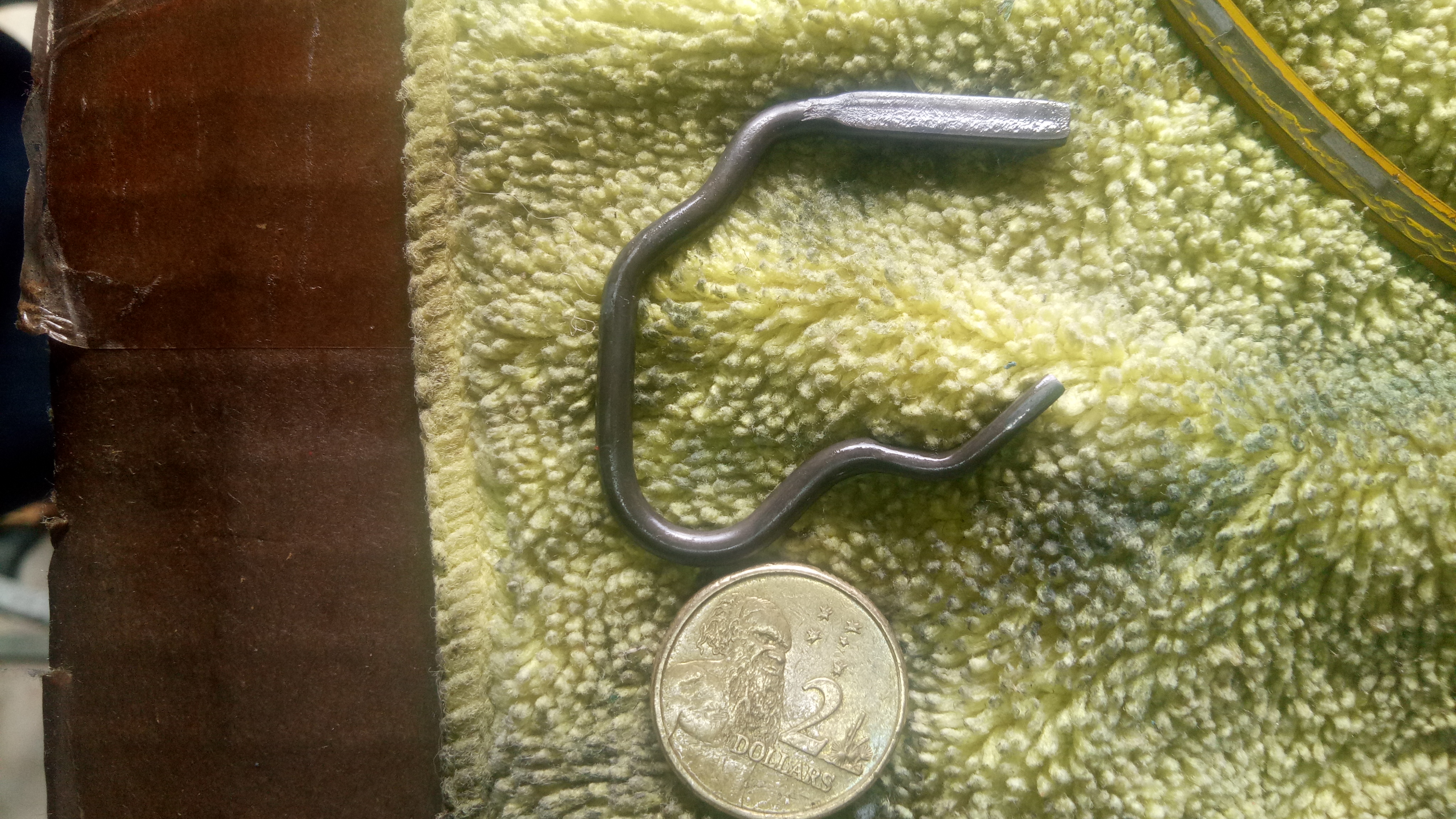

On further dismantling and viewing. I nkw found an item, wedged in the rear end of the trans section. I cant even see it to be part of the Transmission. Pic attached. If anyone knows where it is meant to go or even if it is part of the transmission at all?
This is one of the longest repairs ever i have experienced in my life on cars.
Regards
John.

That is a solenoid retaining clip from the valve body bent backwards.
Posts: 10435
Re: Commodore VX Auto Trans Failure - How To diagnose?
no im not sure it is ...... its been too long I cant remember where it goes, but it goes somewhere inside the case to hold one of the parts in place, I'm sure it is!

It's a lo/reverse clutch support spring( anti rattle ) that goes between the case and the lo/ reverse clutch support assembly (the part in your last pic).

Post by Comcal76 »
My mistake, vs ss is correct :thumbup:
