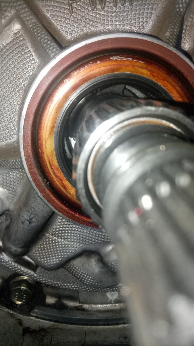

Hi Vlad01,
I re looked at the gearbox today. as the Converter seemed to be OK, according to little info I could find on YouTube to test it.
The gearbox spline is unable to rotate ( seized solid). There are two or three bits of broken metal pieces which can be seen down the side of the spline inside the bearing area. pic attached.
I am planning to dismantle the gearbox in a couple of days to see IF it is a cheap and possible easy repair for now. To get me home (700km) where I can look to begin rebuild of a spare old one there.
Anyway, thanks guys for your advice and I will hope to get back here with what I find. hopefully it'll be good news.
thanks again,
John.
thanks again,
John.

The larger outter spline in your photo is meant to be solid, it splines to the stator in the converter and doesnt turn. The smaller center shaft spline is meant to turn, thats your input shaft, which splines to the turbine in the converter. The impeller in the converter is connected to the housing of the converter itself and turns at engine speed. You will notice the end of the converter where it goes into the trans there is 2 big notches, they line up and drive the pump (the pump drive is down behind that seal where your photo is pointing. If you see broken metal down there its very likely pump failure. Pump is unbolted and removed from front of trans I believe. Take care to ensure converter is in all the way correctly prior to installation in the vehicle (if pump drive isn't lined up, you will break the pump from converter pushing on it if you try to do up bellhousing bolts)

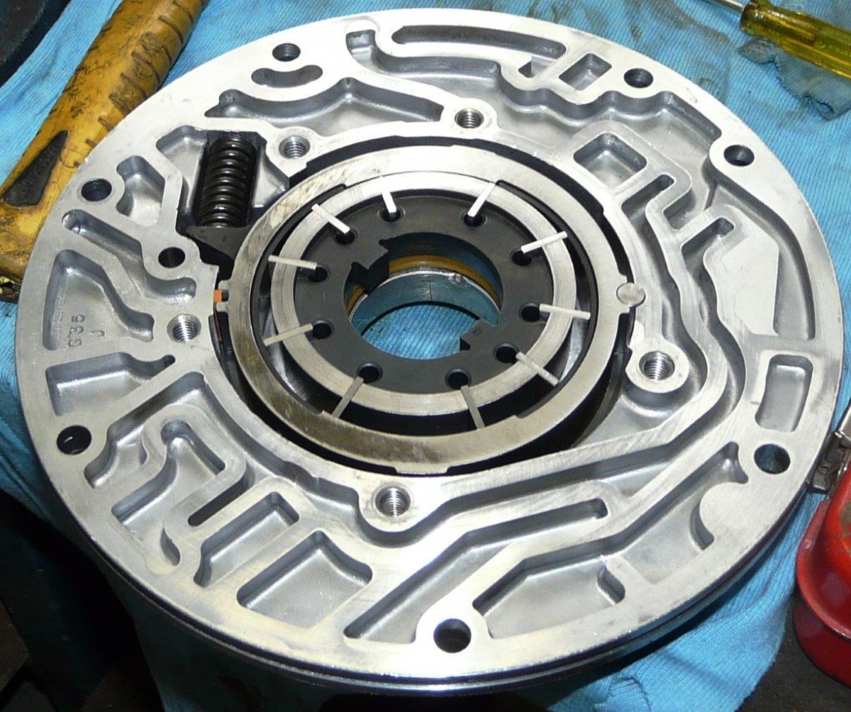

Re: Commodore VX Auto Trans Failure - How To diagnose?
yeah its too hard to tell in that photo, but it certainly sounds like the pump has failed.
so it just so happens I have a picture of what the pump should look like from when I rebuilt my T700 ..... so the black part in the centre is the pump drive that should lock into the two slots in the converter hub, then your larger splined section will be inside this.
so if you cant see a black thing with two tabs, then its probably fairly certain the pump has packed it in.

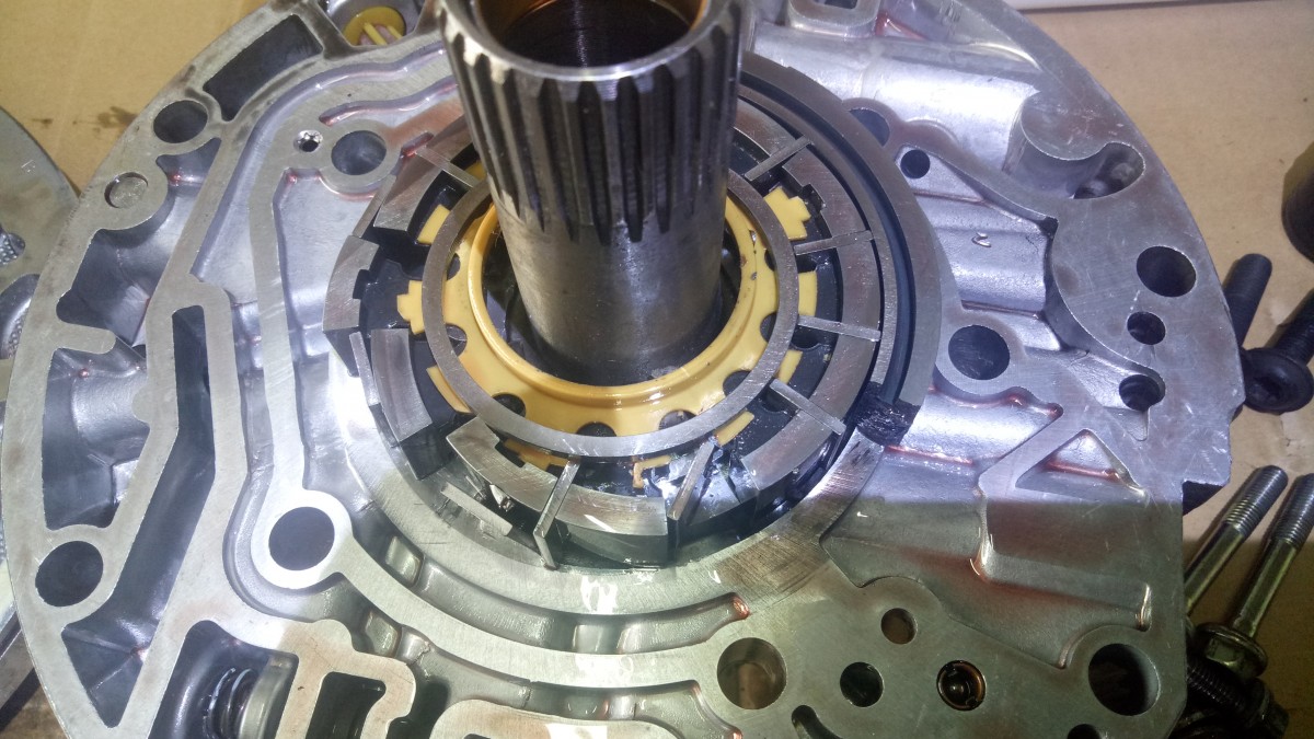

Hi Guys,
thanks so much for all your advice and help.
Yes, on dismantling of the trans. (a good learning experience.)
The oil pump had shattered completely. I hope, it is just from age, not from anything sinister lurking further down the track.
Thanks again, help and advice appreciated.
Regards
John.
Regards
John.
