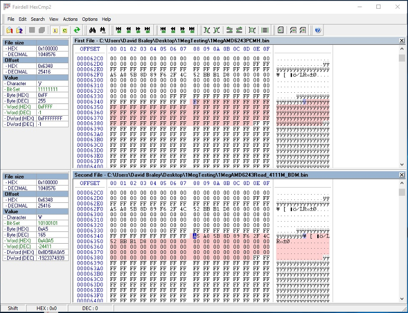

So I did a read and compare of bin files using the USB BDM NT device on the two 1 meg P59 PCM's I have here. One PCM (6106) uses the Intel Flash AB28F800, and the second PCM (6243) uses the AMD Flash AM29F800BB. I used the 4111M and P59 .xml config files to create two separate bins for each PCM. It seem the P59 .xml file just reads pure junk. The output from using the P59 config file is a repeating string characters. I'm guessing that the P59 .xml file is possibly configured for the 6 cyl S-10 engines that bubba2533 was getting help with on the USB BDM NT forum. I do think that the 4111M .xml config file is reading something close to, or even good data.
So to back up my theory, I decided to compare the two bin files created by both the BDM device (using the 4111M .xml config file) and PCM Hammer. The PCM I read is a year 2004 12586243, with the AMD Flash AB29F800BB. The two bins files are almost identical. Only one small area of difference. No were else in the two bin files are they different:
I am unable to compare the bins files for the 1 meg Intel Flash PCM here, just because PCM Hammer will not read it. I am though able to open the 1 meg Intel Flash PCM bin file I created using the BDM device in TunerPro RT. Had a look around and it shows the correct Vin, Engine Type, OS, etc. Not an exhaustive look. But it seems the BDM device is reading something close to good data from the P59 with the Intel Flash.

- Posts: 8999
Re: USB BDM NT
one has been reflashed, one has not. Thats a log that an external kernel was executed on it, in the param block. Its not part of the OS or the Calibration, but part of the data specific to that pcm. param blocks are $4000->$5FFF and $6000->$7FFF. On 512k pcms each time persistant data is saved the active block swaps. On 1mbytes I think only one may be used... but more research required at this stage.

Antus,
Help me understand what you are saying. I know that both bins are just a read of the flash contents. The BDM device was used to read the PCM, and then PCM Hammer was used to read the same PCM. I took those two bins and compared them to see what or if there was any difference.
You mention that "one has been reflashed, one has not." I'm confused by that statement. Are you saying that a read of a flash memory changes the contents? Very interesting for sure if that's the case...
