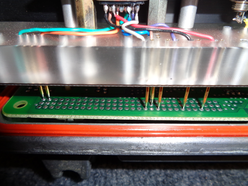

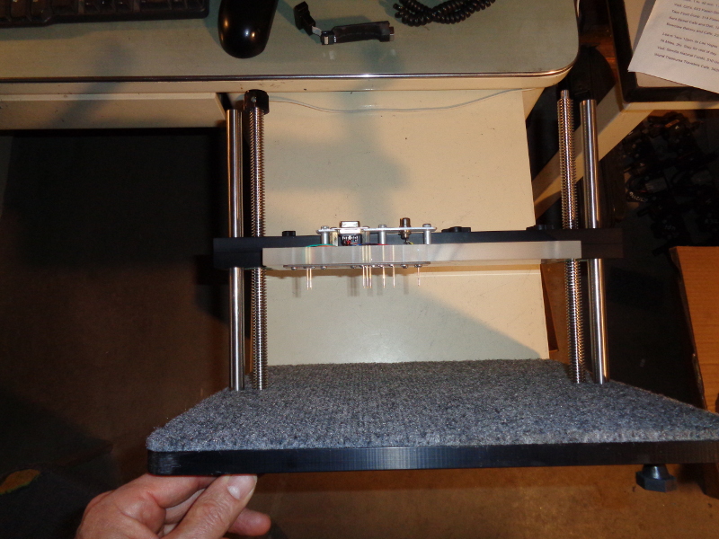

But in case it's of any interest, I read the contents of a 0411 with PCMHammer version 4, and then read the contents of the same 0411 PCM with a USB BDM NT device using a fixture I built to do so. It was PeteS who exposed me to this device in a post. My original motive was to see if the contents of the two bin files where the same. I used a tool called HexCmp2 (Antus inspired) to make the comparison. According to HexCmp2, both bins where exactly the same. I just remove the 0411 lid to access the rear side of the main board to read and write. Not practical for sure, but fast as hell. Full 512K read in less than 3 seconds. Full 512K erase and then write in less than 38 seconds. I was careful to keep the lead lengths (including probe pins) to less than 6 inches (152mm).

I found implementing the BDM NT device to be much harder than I was expecting. I spent more time figuring out how I would do this and how to actually get it to work then it too me to make the fixture. I've spent the last 40+ years as a precision machinist, welder and fabricator. So typically when I need to play with electrons, or manipulate a line of software code or a system config file, I really am out of my element. I think the only reason I eventually stumble through projects like this is my ability to pay attention to details. Something that you learn how to do really well as a machinist.
I chose to make the fixture universal because I do not know where this "Playing with EFI" is going to take me. I may use it to program other engine computers in the future. Probably the simplest way to use the USB BDM NT device is to wire the ribbon cable directly to the PCM like PeteS did. MUCH simpler for sure.
For my project, I didn't want to do it this way. Instead, I made the part that holds the test probe pins separate, and it just bolts to the cross-bar of the programming fixture:

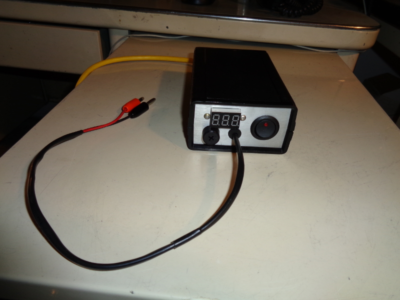

I built my programming cable to have these features. On one end is the voltage input to the cable (I use a 13 volt supply). It has a safety fuse (1 amp) and a voltage meter so I know what the cable is being feed. This input voltage is controlled through a switch that sends it to pins 19 (ignition) and 20 (battery) on the blue connector. I also feed ground to pin 60 on the blue connector.
The other end of the cable has the blue connector cable output, another switch for sending 12 volts to the Vpp pin for erasing and writing. It also has a voltage meter so I know exactly what voltage the Vpp is getting.
I mention earlier that I put a trim pot inside the programming cable I made so that I could adjust the voltage at pin Vpp to 12 volts. I use a .75 watt, 15 turn pot for this. It's located on the side of the black programming cable case. Access is with a very small screwdriver.

I think I was not completely clear about something in my last post. I use both the USB BDM NT device and what I call my programming cable above at the same time when I read and write to the PCM.
