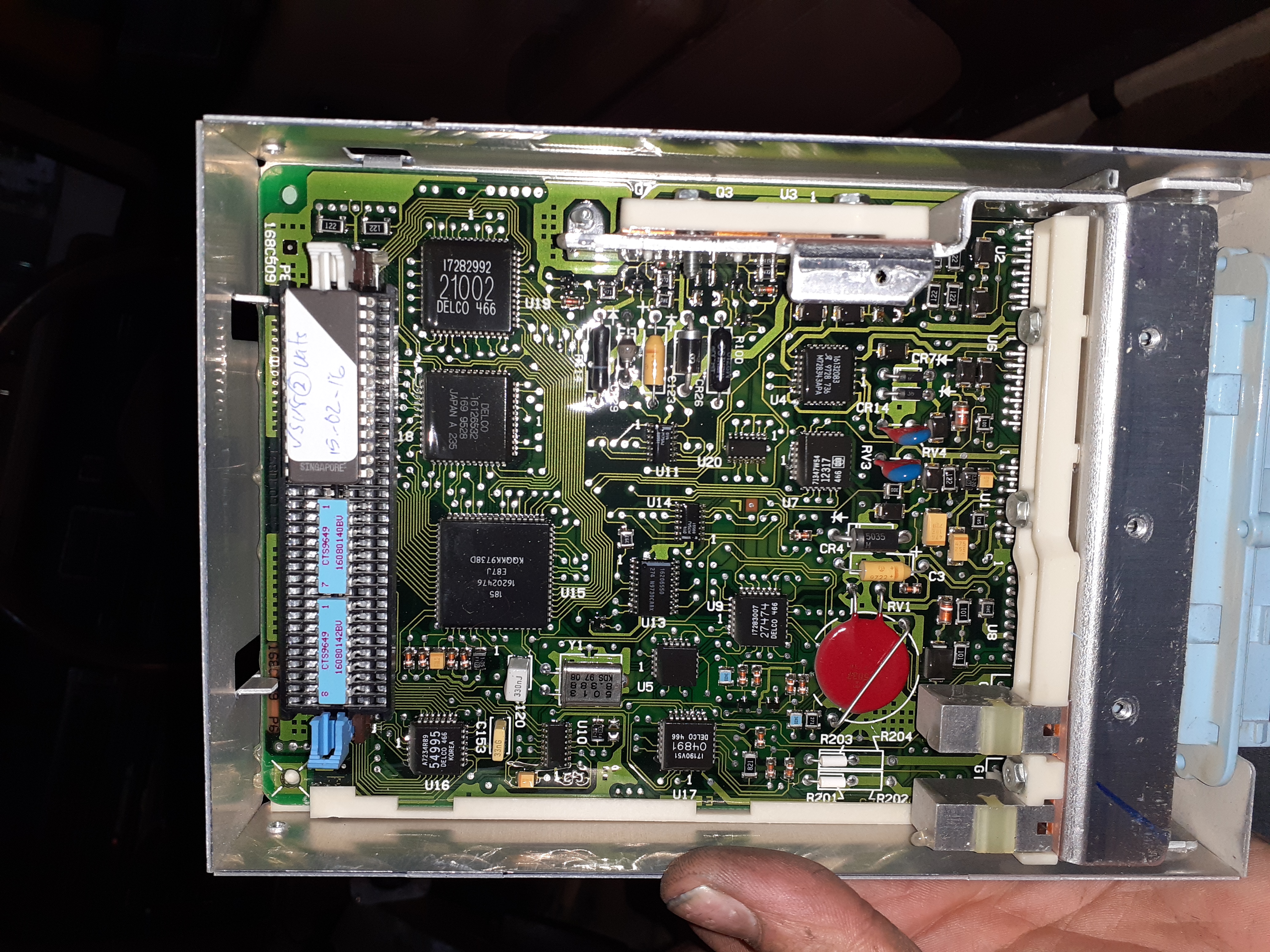

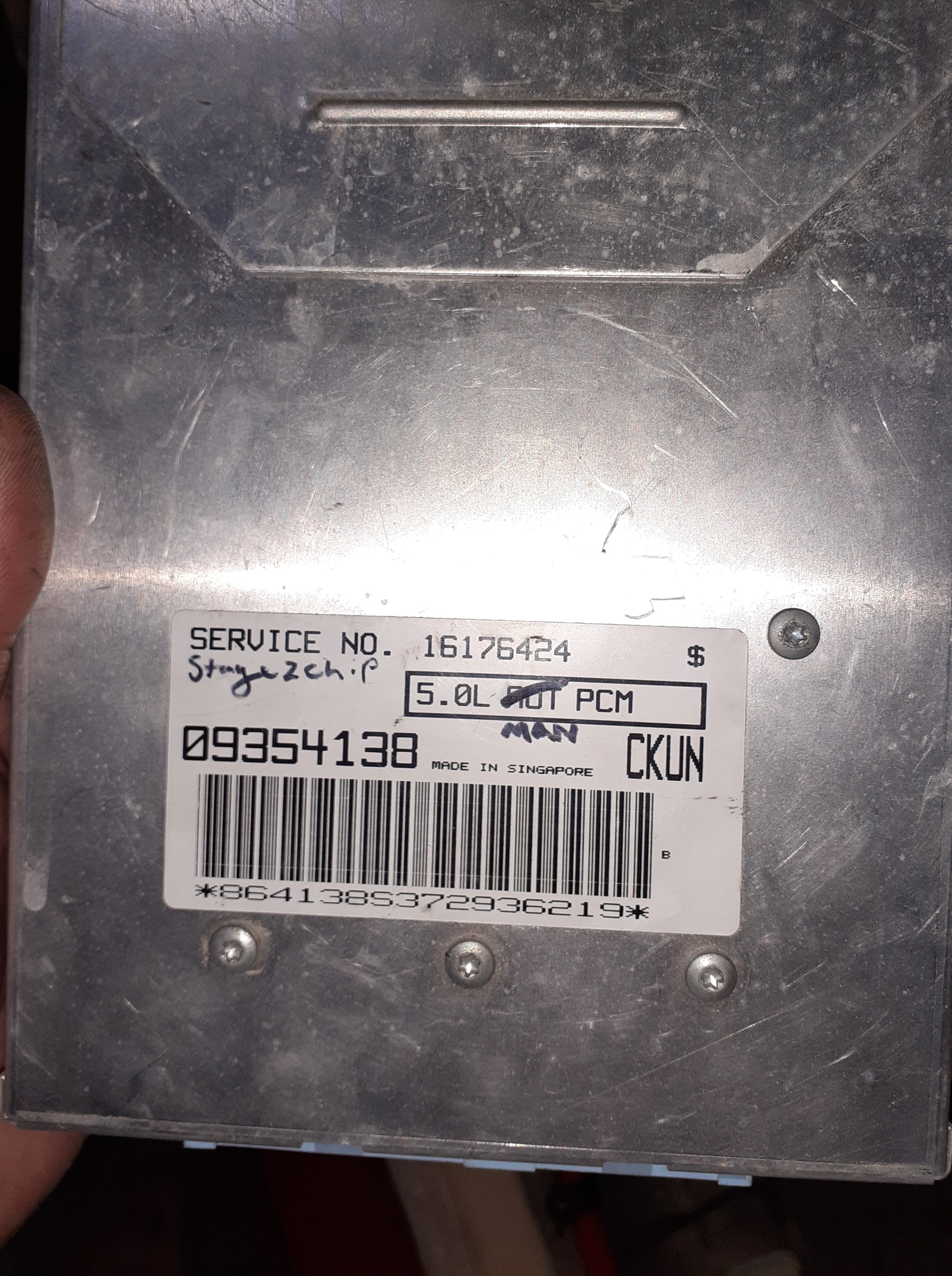

Can anyone identify this ecu ,its out of vs 1998 auto 5l vats deleted and "stage 2 chip" whatever that means ,maybe then I can look up wiring inputs outputs and hook speedometer up

Posts: 9044
Re: Vt getrag speedometer
Dunno about the tune but its an 11p capable 424 maybe with 11p and the auto dtcs masked.

Post by Vk304 »
Yea no idea what that means, I might have to do some learning before I can figure this one out haha :?:
