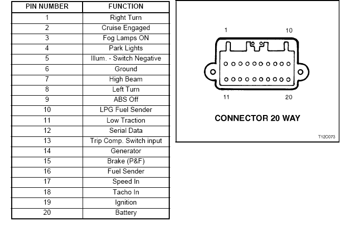

I think this is the pinout for vt

I can trip the kms, warning lights ,indicators and fog but no idea how to get speedometer working
Posts: 8125
Re: Vt getrag speedometer
you need a 12v square or saw tooth wave going to it?

I've got the sender on the gearbox ,its got 2 wires coming from the sender(abs style) that reads a pulley . Where would the 2 wires need to go ,does one directly go to the speed in pin on the cluster?
