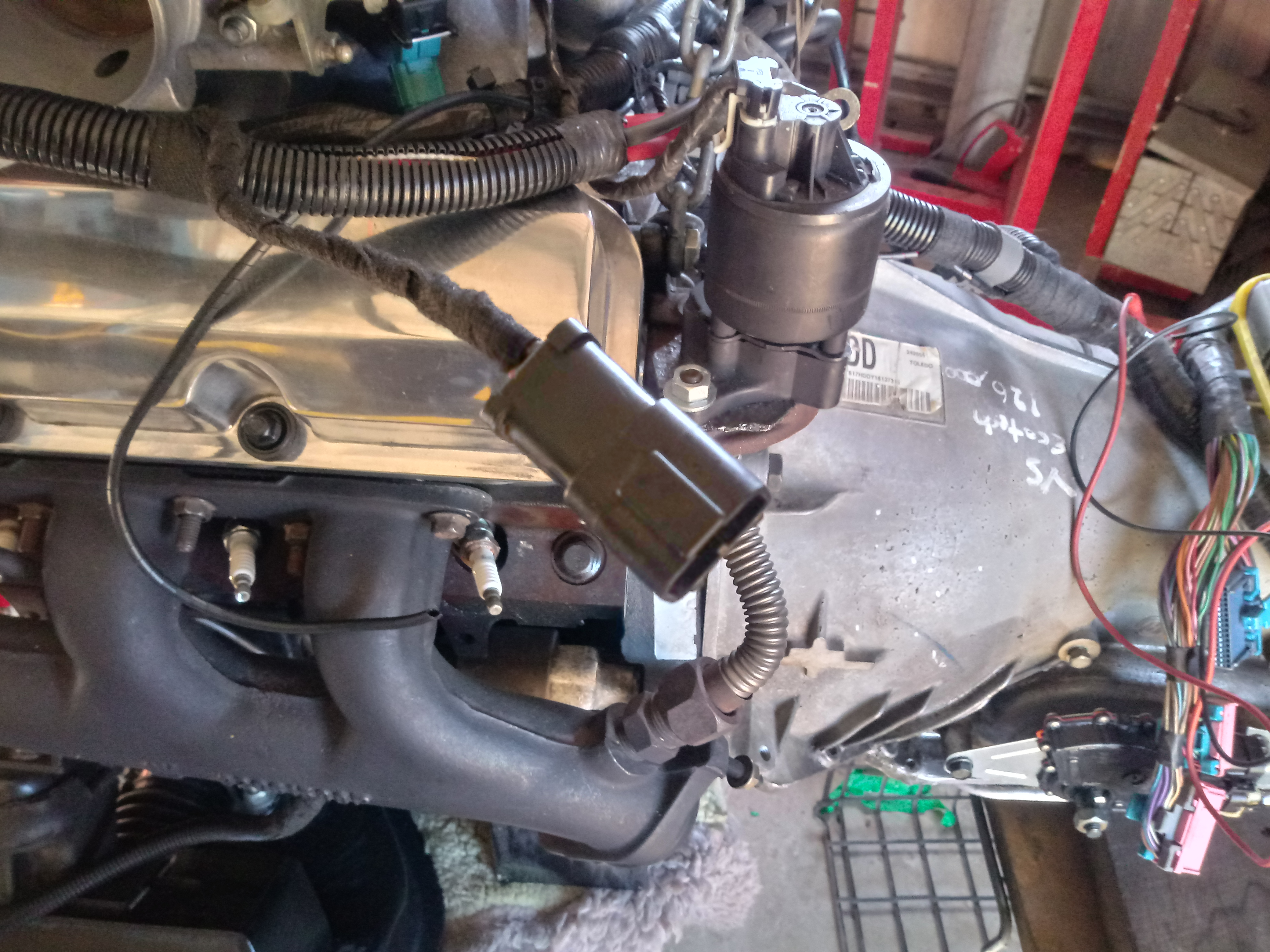

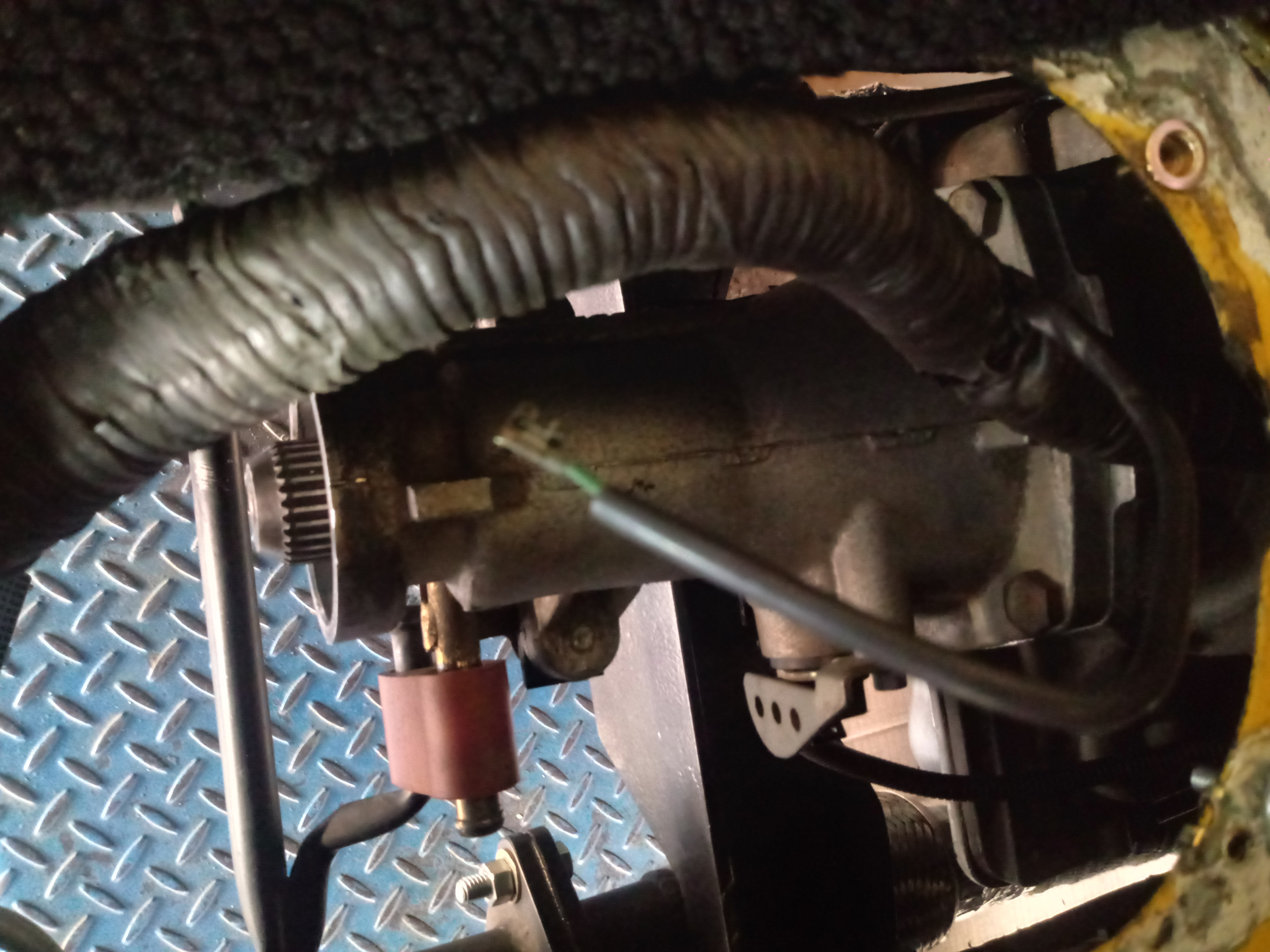

Re: Wiring for VT Ecotec Engine Power
I'm working on the VT Engine Earths in my Triumph TR7 EcoTec project.
I've connected the one to the Water Pump, and the one on the rear of the left cylinder head, and will connect two
heavy cables from the block to the chassis.
I've read about one that connects to the right hand side engine mounting, but can't find it in the loom.
Which part of the loom does it come from?
There is a red (light gauge) wire that appears to connect to the battery +ve (Picture Attached) with the two heavy gauge
cables that connect to the alternator and starter...Is this correct?
There is a green wire (light gauge) coming out of the PCM Harness, approx 600mm from the ECU. (Picture Attached)
Is this a ground, or something else.
TIA.

- Posts: 8115
The red ones are correct, the smaller of the 2 is the alternator charging wire, big one is the starter motor one.
No idea what the green one is, I only know up to VR and VS.
The one on the engine mount is a heavy black ground cable from block to negative battery.
The green wire is the factory anti theft horn that is situated in the passenger top corner of the engine bay.
