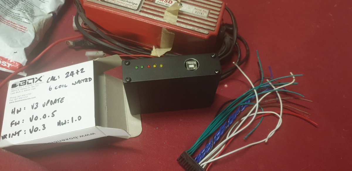

So after many months of searching I finally managed to track down & purchase one of VL400's Ignition Modules.
Problem is, the packaging indicates that it configured for a 6 coil wasted spark, and I intend using it on a 4cyl wasted spark configuration.
I'm not sure how to proceed from here. I've just sent a PM to VL400 asking for his assistance, but according to his profile, he last visited this forum exactly 1 year ago today, October 13, 2019, so I'm not confident of a response.
I don't know what I can and/or can't do in setting up the module to suit my requirements. No documentation was provided by the previous owner, so I don't even have a wiring diagram indicating what each of the wires are for or how to use it. That's a problem.
Can anyone help? Does anyone have any literature, documentation or manual that could be emailed to me on the Configuration, and/or usage of the module.
I hate to think that after finally getting my hands on one of these that I couldn't use it.
Thanks everyone.

- Posts: 2971

I've read that thread a few times. VL400 shows images of the software he uses to configure the module, but that's it. Without the appropriate software or the relevant documentation I can't see how I can proceed.
