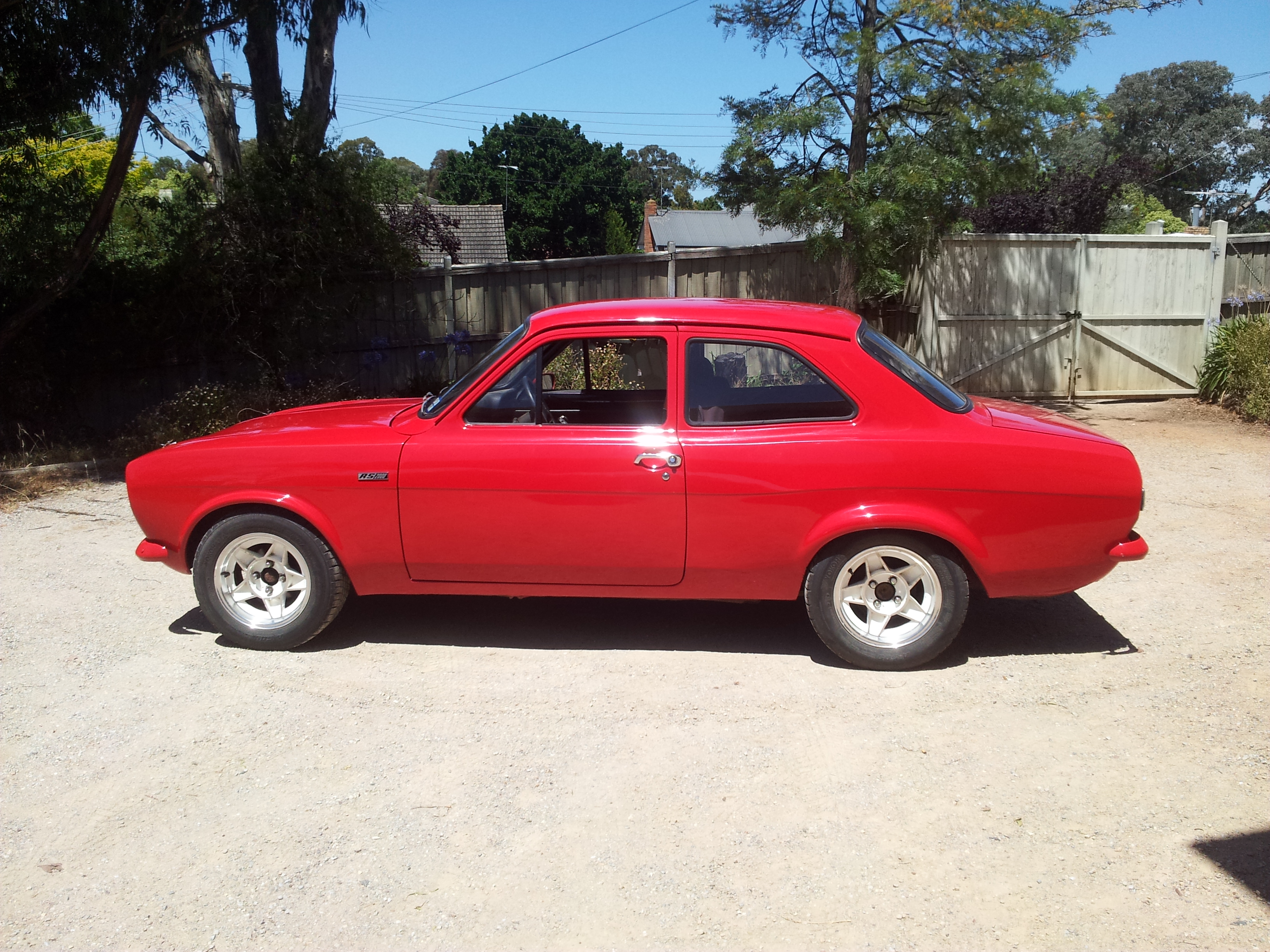

Well I'm finally getting around to converting my MK1 Escort to EFI.

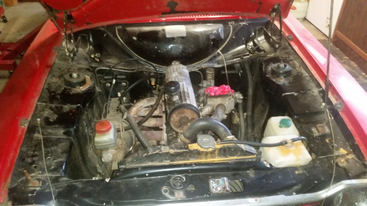

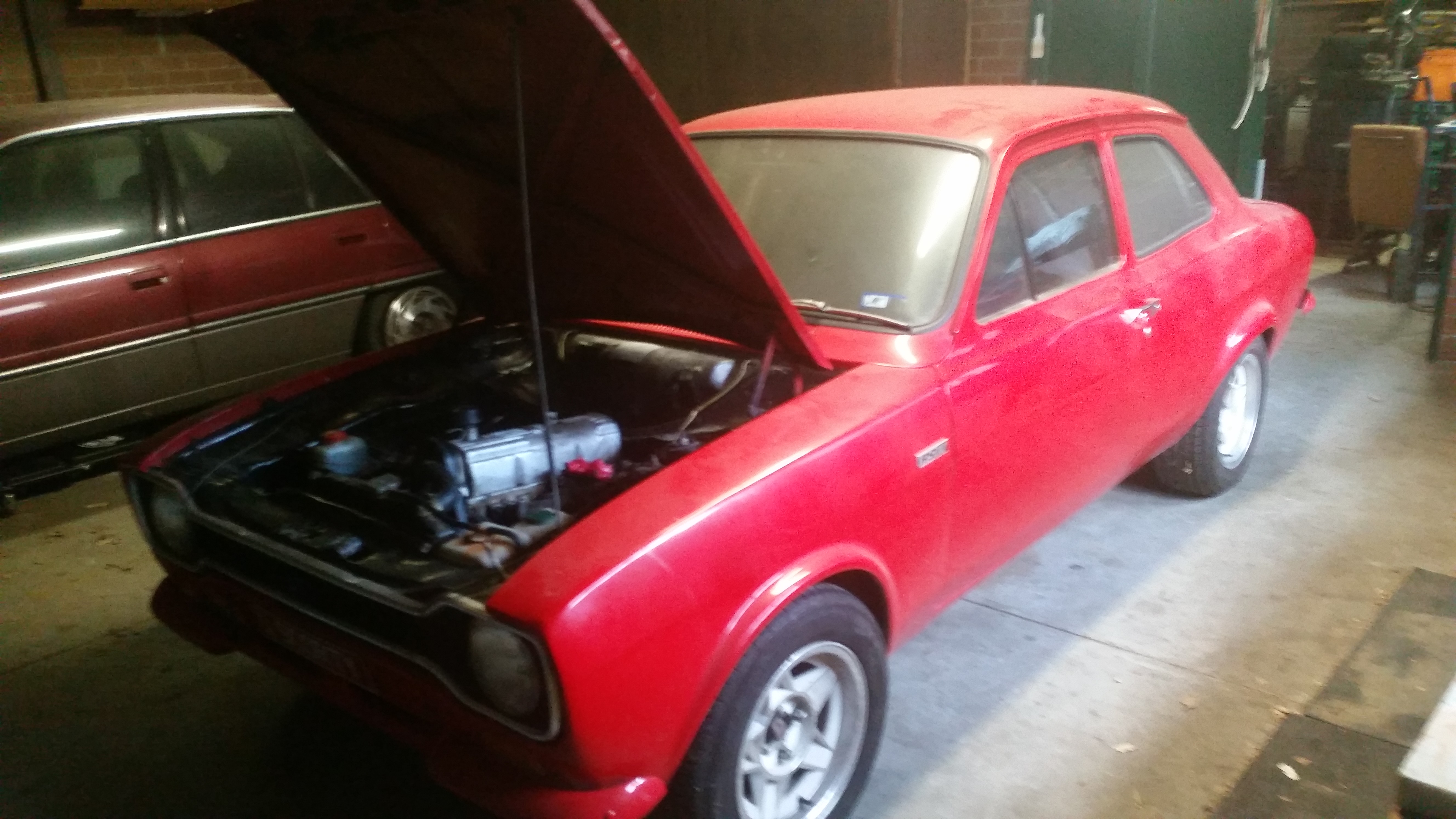

The photo above was taken 7 years ago when it was still on the road. I took it off the road in 2016 with the intention of converting to EFI but life got in the way until COVID forced everyone to stay home, so I have no excuses now. This is it in the garage ready for the conversion:
Driveline currently comprises of a 2.0 litre Pinto motor running a big valve head which has been ported, a performance cam which I do not know the specifications of, a standard 4 speed Escort gearbox and a 3.77 open centre differential. Intake is handled by a standard Escort 32/36 Webber carburettor on the factory intake manifold, and exhaust exits via HM Headers into a 2.25 inch exhaust system.
The engine is pretty healthy so apart from a coat of paint to clean it up it will remain as it is. I have a selection of camshafts ranging from stock to hot so I might consider changing to another grind for the finished product. I also have a Celica 5 speed steel case gearbox with a Castlemaine Rod Shop conversion which will need to be rebuilt and then installed and finally bearings and seals for the diff centre which will also be rebuilt.

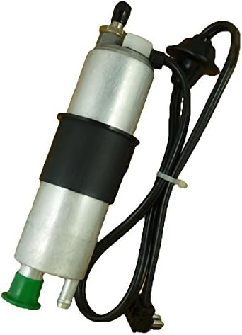

Then I found the Bosch fuel pump 0986580371 to suit early 2000's C class Mercedes Benz which has a fuel return port at the rear of the pump next to the fuel inlet port from the tank:
I've search high and low to get the specs on the pump and the best I have come up with was on a Chinese copy site where their version was rated at 4Bar which I believe is 1Bar less than the Camira pump I have.
I'd like to know if anyone is familiar with this pump and if there's any reason not to use it?
Seems like a good solution unless there's something I'm not seeing.

My mate is facing the same thing on his isuzu bellett efi conversion. He has installed a port in to the top of the tank and added a second factory fuel line taking the same route as the supply to implement a return on his. The merc pump you show looks like it would do the job. I probably would not do that because its a bit of a weird pump and especially if the chinese one fails it might be hard to get a replacement you can drop it. It'll also be heating and cycling the same fuel around and around rather than giving it time to cool back in the tank. Probably not a big issue, I dont think there is a wrong answer. Your pressure should be under 4 bar at the engine, so I think 4 bar from the pump should be ok in s normally aspirated setup.

I would NEVER buy a Chinese fuel pump. I was just referencing it as it was the only site that gave me a fuel pressure figure. I have been unable to find any information whatsoever on a genuine Bosch pump which surprises me with all the Bosch information on the internet.
I did consider the fact that the fuel may warm up a little but I'm not sure if that will be an issue. I figure if they work in a Merc, I can't see it not working in an Escort.

I've been considering whether to use the Bosch or Mercedes pump and I've decided to use the Bosch pump. It's higher pressure may be important if I decide to install the turbo kit I have at a later date.
