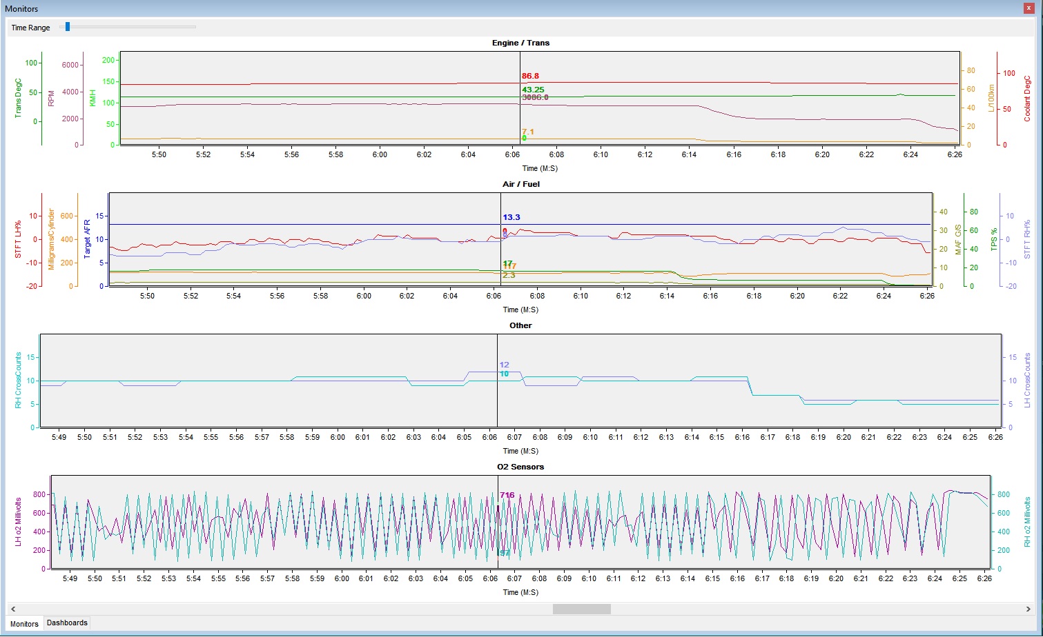

STFT is short term fuel trims, which are pretty much realtime fuel adjustments, LTFT is Long Term fuel trim which is an average of STFT over time. So the LTFT will build over time via the STFT which keeps it in spec. So to see if something's really out check what the LTFT is doing over various driving conditions.
the millivolt fluctuations are normal, look for a variable like o2 crosscounts, this will give you the number of cycles between 0-900mv, normal o2 narrowband sensors will work on usually over 10 with some throttle, at idle maybe around 2-5. If your not getting many crosscounts even with throttle then the o2's are prob getting tired and need replacing.
Idle is the hardest thing to make smooth, check for vac leaks, give the MAF sensor wire a clean to.
STFC frequency seems high?

Re: STFC frequency seems high?
Thanks vlad01, Gareth and The1,
Al be it a backyard check, I did check for vac leaks and didn't find any. Even a Vac gauge showed vacuum was good. Though i am yet to try the smoke technique. I am also needing to check exhaust for leaks prior to O2 sensors ans it too could cause miss reads of the sensors I believe.
I should know tomorrow after my trip IF there has been any significant change to the economy. If it doesn't alter, then i will try checking further. But I feel it is likely the injectors causing the fuel usage by having the PCM adjust for inconsistent injection spray all the time.
I am getting what I consider a fair amount of cross counts anywhere from 0 to 15 at times, while its also cycling the O2 sensors hi / low. I feel the O2 sensors are responding as if new by what TunerProRT is showing me.The1 wrote: look for a variable like o2 crosscounts, this will give you the number of cycles between 0-900mv, normal o2 narrowband sensors will work on usually over 10 with some throttle, at idle maybe around 2-5. If your not getting many crosscounts even with throttle then the o2's are prob getting tired and need replacing. Idle is the hardest thing to make smooth, check for vac leaks, give the MAF sensor wire a clean to.

- Posts: 8600
JohnDee68 wrote:Thanks vlad01, Gareth and The1,
Normally the ECU will throw an error if one bank is running richer than the other. So I doubt the one injector would be the cause. I know they also chuck an error if either or both banks run too lean/rich as well.
I would go and have a look at tyres and their pressures if you haven't, next if the engine is running at full operating temps too. Always good to check the basics.

- Posts: 10111
If its got poor economy due to bad fueling for any reason it'd be too rich, and your O2 sensors which look like they're working would be showing off the scale rich as they are not widebands so will easily pass their limits. But your screen shot doesnt show that. So Im leaning toward the timing theory, that if its running a bit retarded power is lost in the stroke so you have to drive it harder.
- Posts: 8600
That's what I found with my old motors as well, good AFRs, fuel trim and cross counts were normal but still using some 3L/100 more than a fresh motor.
- Posts: 4853
log looks fine to me. For reference our VX Wagon usualy got on average about 13L/100km with mix of town and highway, with 330,000km on it. What figures are you getting?
