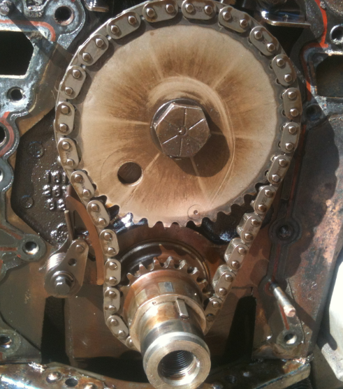

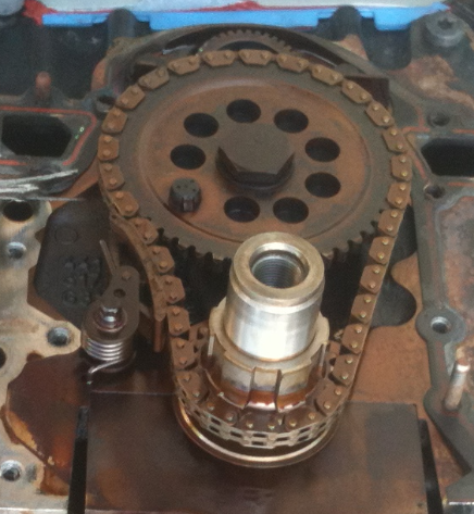

- Posts: 8600
Re: STFC frequency seems high?
not a lot in it but if you look back and forth you can see the top one is more stretched, the bottom of the tensioner is fully contacting while on the 100K chain (bottom pic) is not fully contacting the bottom of the tensioner, the chain looks more straight as well.
Hard to say really, maybe 1-2º more retard? not sure if that would make all the difference but it's the only thing I can think off that could do it.
EDIT. You can also see it in the angle of the tensioner arm, its more angled in on the top one.
My old VN always got good economy and I put a new double row timing chain on that old girl too. Hmmmmm hurry up Xmas....
The chain on the top pic looked stuffed, it doesn't look like the chain is sitting down in the sprocket correctly all the way around which is a good sign of chain stretch. Kinda makes me want to check out the 251,000km timing chain on our L67
- Posts: 8600
Hey, you're right, I didn't even notice that. It really is fucked.
