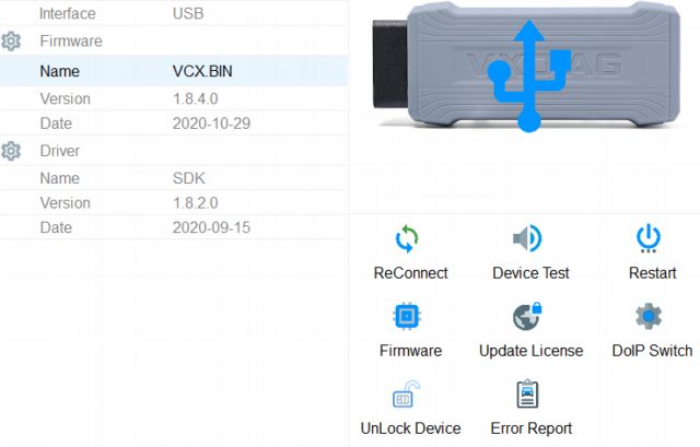

Well, I installed VX Manager ... And it shits like my geriatric 17 year old dog, all over the place!
I mean it shit everywhere ... In the Windows tree, in the Programs files tree, in the ProgramData tree, in the User tree and of course the registry!
[edit] Forgot, Start menu and Desktop as well ...
[edit2] Whoops, missed a pile in C ROOT!
And still doesn't work, VX Manager says "No Device(AUTO)"!
It also installed a "TAP-Windows Adapter v9" device under "Network adapters" in Device Manager! ... A Spyware VPN.
BTW, the VX Manager is called AllScanner, and it is complaining about an expired license ...
