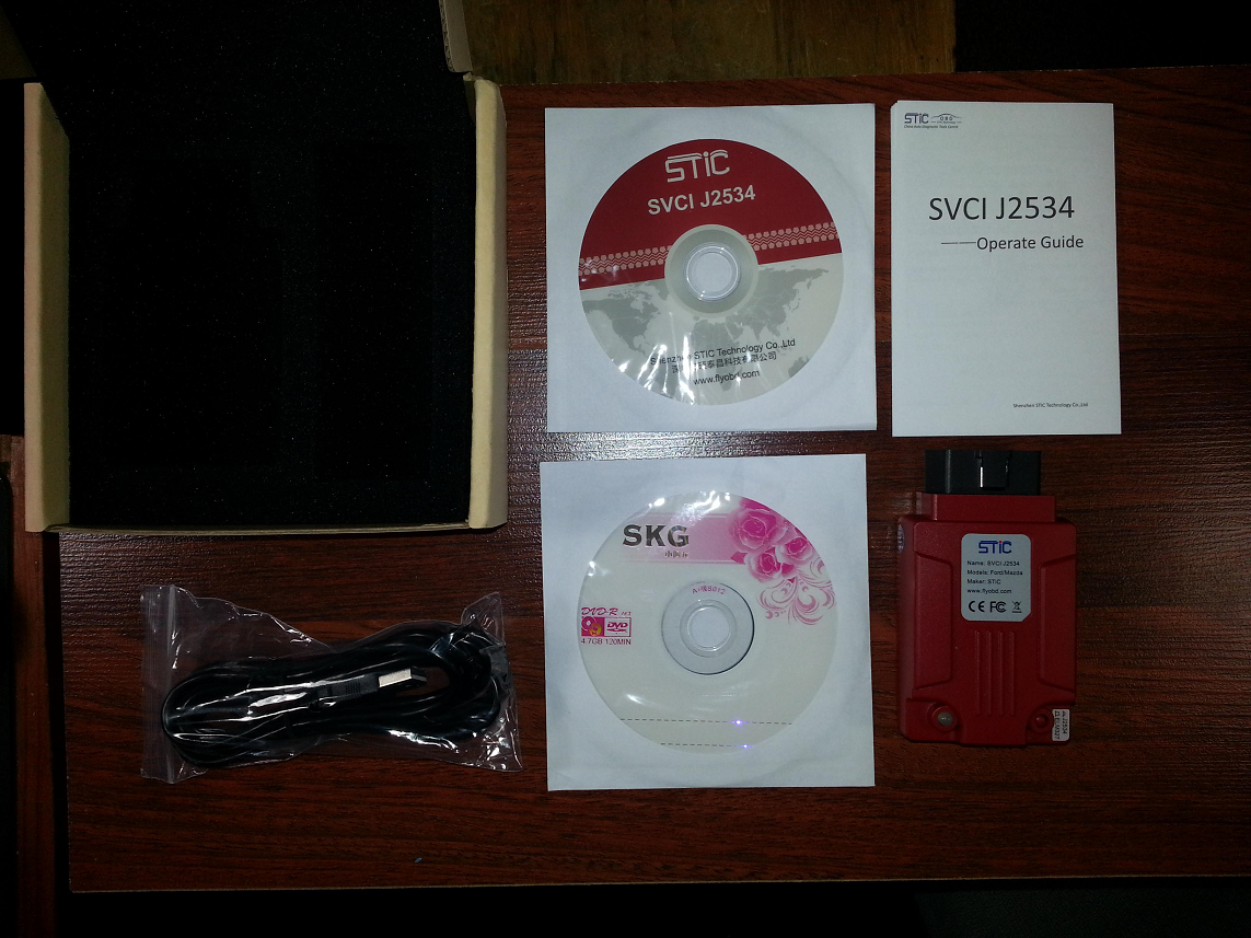

Yesterday when we got back from my pulmonologists, we found a box on the porch, I grabbed some gloves (I don't touch anything outside my bubble, and nothing comes into my bubble without a 24 hour quarantine) and opened the box, this is what was inside,
It says it's for Ford/Mazda, it also says it supports J1850VPW (among others).
So, I figured what the hey, lets try it, so I popped the first of two CD's into a drive and Whammo!

This is the file list on the infected CD ...
DA J2534 Device Setup V4.0
FORDZ_VCMII drivers
MAZDA_VCMII drivers
MongoosePro_JLR.msi
sp312 VCI Manager(JLR) 19.09.09.exe
T6 wiScan V3.11.exe
VX Manager 1.6.2.0902.exe
The only thing I have installed is the "DA J2534 Device Setup V4.0".
"sp312 VCI Manager(JLR) 19.09.09.exe" ... It is infected with Sality virus according to multiple different tests, I will not execute it.
This may very well be the problem, unfortunately support fails to respond for a replacement.
I could install "VX Manager 1.6.2.0902.exe", it tests clean ... Do I really need it ??
