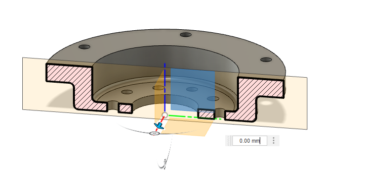

This is probably the only 'critical' part of the build. I'll design up the above style hub joiners and send them off for a quote. They will likely end up at around $80 a piece which is still in the budget and i'll know it won't shake itself or my car to pieces.

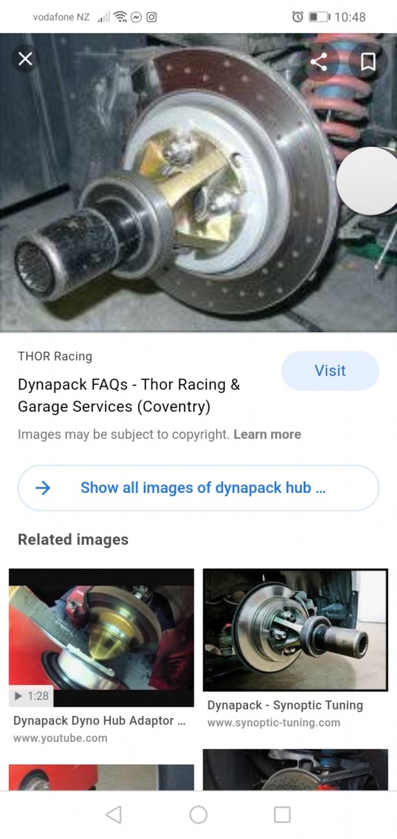

Thus is how the dyna pack setup works could do the same and slide onto a cv shaft

CV shaft annealing and heat treating is probably beyond my skill level. I did it for the engine dyno and even with a couple hrs of dull red heat in the shaft, it ate up a carbide bit when turning them. If i can avoid shafts and splines, it'll make it much easier i thinkdelcowizzid wrote:Thus is how the dyna pack setup works could do the same and slide onto a cv shaft

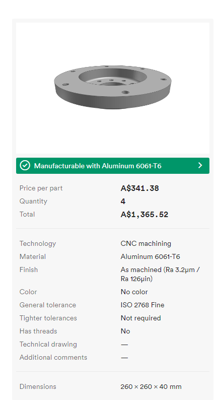

Out of curiosity...
I sent this off for a quote on 4 pcs - 114.3PCD and 120PCD for ford and holden hubs.
Might just blow the budget...
