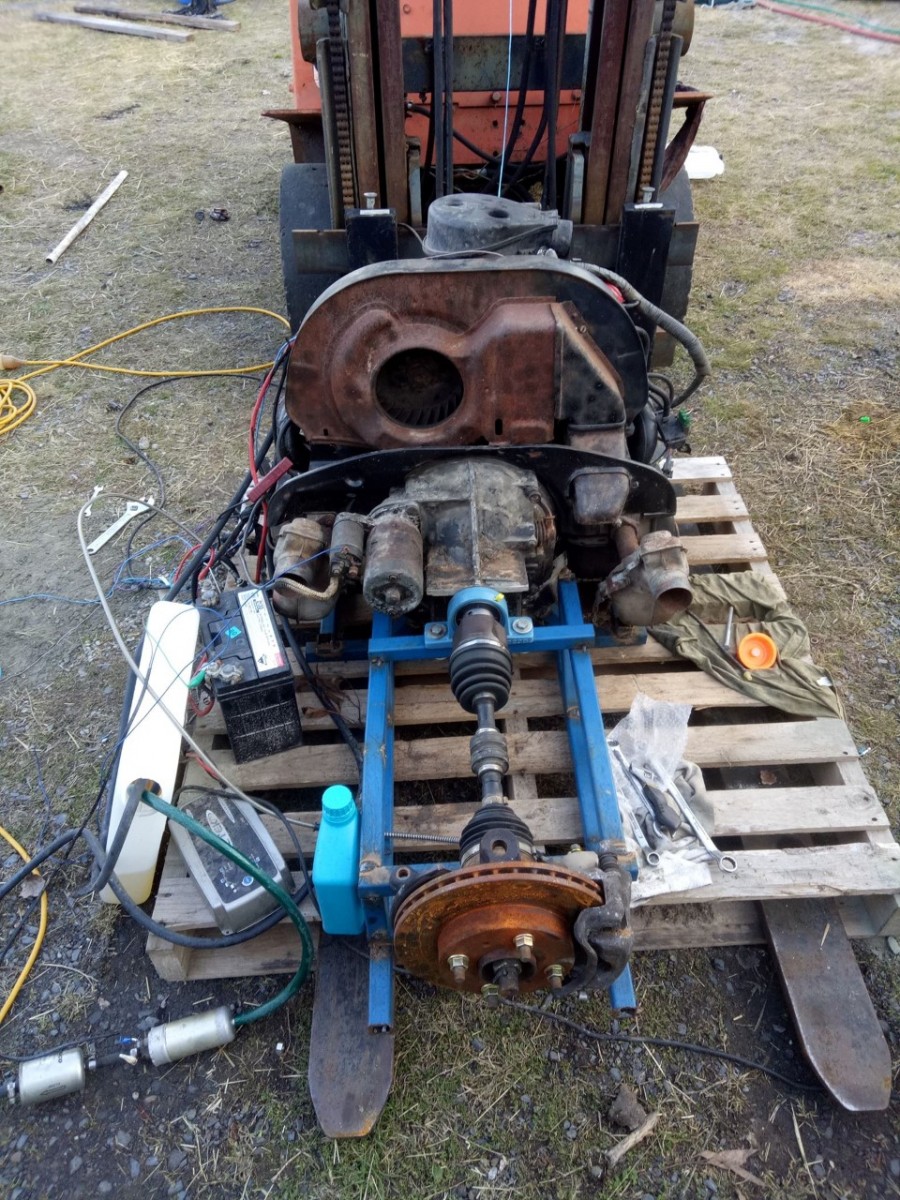

A 1.6L VW motor (40kW) dissipated into a single 4.5KG nissan pulsar rotor. With water cooling, indefinite disspation was possible and the rotor did not exceed 100deg C. The rotor had no issues at 5000rpm though the CV boot expanded like a balloon and caused a bit of vibration. A well aligned rigid shaft would have been preferred.

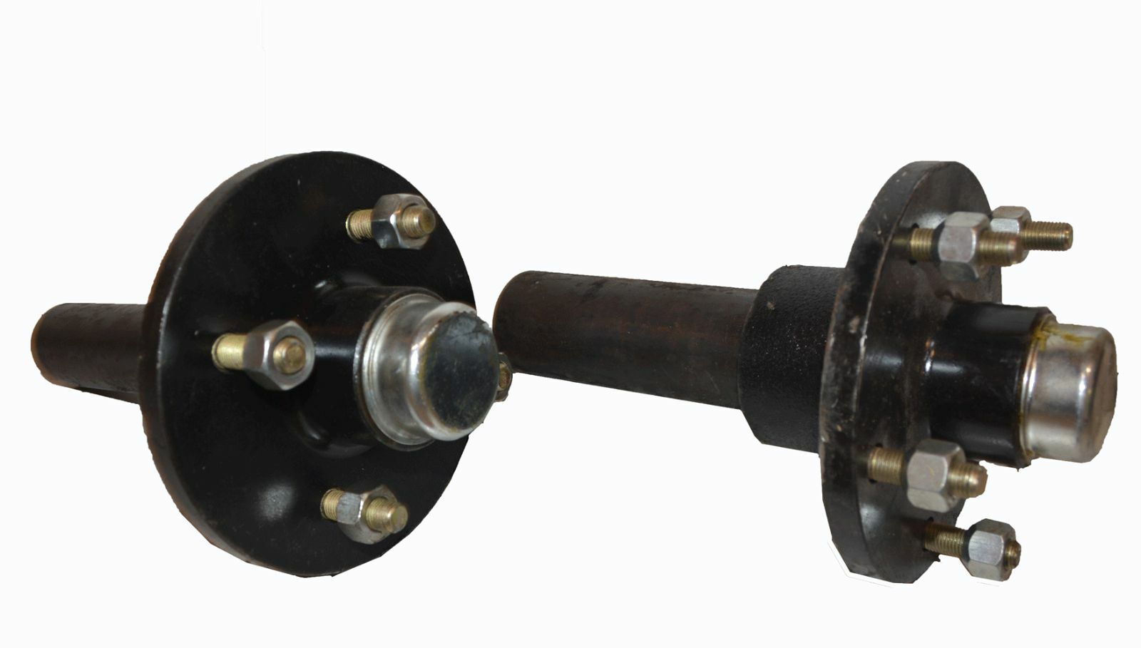

1 ton capacity, 120mm PCD stud pattern. 50mm stub, 200mm long. $135 shipped for the pair.
The 50mm stub will hopefully fit nicely into a 50mm self centering pillow block bearing: $98 shipped for the pair. Self centering is important to absorb any misalignment/tow in/out/camber etc. To add braking to the hubs, I'll add a pair of VE rotors and calipers: $50 for the pair from FB marketplace. This is the first problem I may need to fix up on the lathe - I didn't consider the trailer hub diameter and if the rotor would fit over it. If it doesn't, I'll need to turn a few mm off it. Buying a disc braked trailer hub kit ($350) would solve this but the disc was small, not ventilated and used a small caliper. I decided against it for this reason. The stub axle's will arrive in a few days and I'll see if it's a problem or not.
For the pillow block, I figure I'll only need one per stub thanks to the car's hub being able to support itself. Any camber should be compensated in the pillow block.

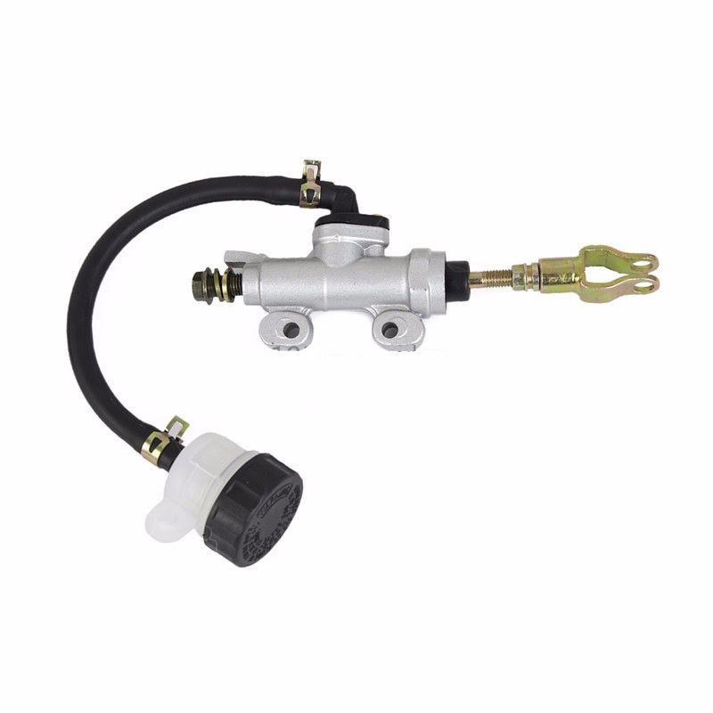

On the engine dyno I used an ebay $15 pitbike rear brake master cylinder: Given the size difference between the caliper cylinder and the master cylinder, there was more than enough mechanical advantage to stall the full 40KW using only hand weight direct on the master input shaft. The VE caliper has two slaves and are larger. Hopefully there is enough volume in the master to actuate it but its not so much a volume thing with the brakes, its nearly all pressure. I'm sure it'll be fine. I have two of these on the way ($40 shipped for the pair).
To get the pressure to the caliper, A $15 10mm 500mm long banjo brake line is used. These were $30 shipped for the pair.

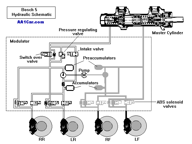

I have been looking into using an ABS pump to generate and regulate the pressure to the calipers. Any forum anecdotes I have found say an ABS pump doesn't generate pressure, it modulates the supplied pressure to the wheel, preventing braking. Looking up the schematics inside these pumps suggests that isn't necessarily the case and thanks to stability control and downhill brake assist, they most certainly do generate their own pressure. See attached:
My only problem with this method is the valves are not PWM controllable, rather on/off only at a max of around 10hz. While this will work, the load cell measuring torque won't see a nice linear analog style load and the resolution of one valve 'click' may be too course of a resolution and bog the engine down. I've grabbed the VE's ABS module to test anyway. This seems like the easiest Electronic to Hydraulic control method I've found. I figure if I can slow the motor down enough, a single valve click may be small enough. Adding check valves and pressure compensated flow control valves will blow the budget.

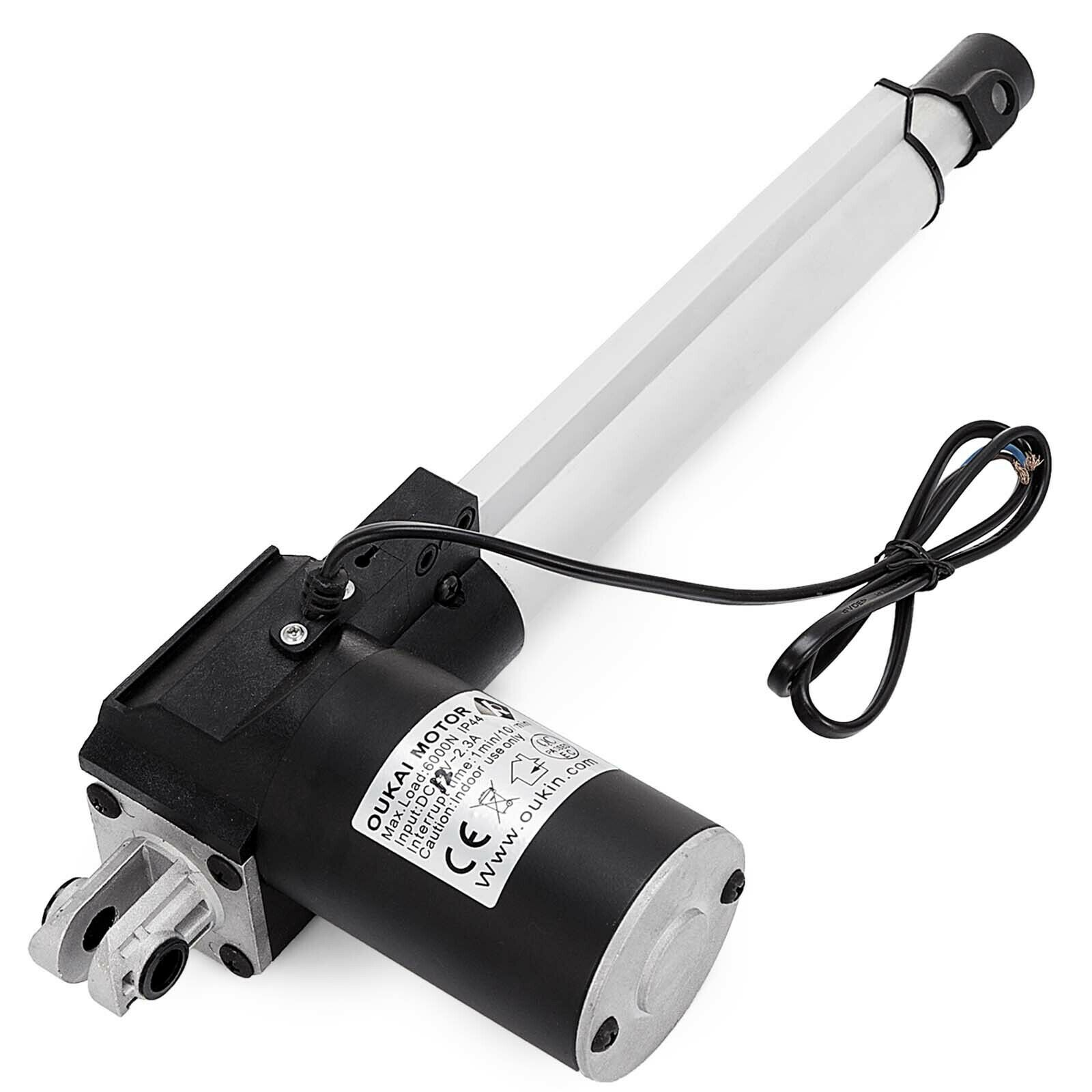

The backup, and probably the way I'll go is using a linear actuator like this: 600kgs force, 5mm/second may be a little slow but with that kind of force I could add a lever to speed that up, or use a 300kg actuator at 14mm/s. I tested the car this afternoon with the motor off on the highway to remove any vac from the booster to see how much force and travel was needed to pull the car up. It was almost zero travel and all force so I figure 5mm/second will be fine as long as it can translate the force. A pair of these shipped is $76.

my thoughts exactly! haha. I had a look under my trailer and looks pretty much exactly like this. I guess the 1t static load would have a huge overhead for dynamic loads (speed bumps, pot holes) so I *fingers crossed* think a steady 500kgs between the pair should be safe. I'll definitely look deeper into the VE option on version 2'quipt4it wrote:I like the sound of the VE set-up. Those Chinese stubs look cheap.

Those look exactly like trailer wheel hub assemblies.

Forgot to say in the post, they are in fact trailer stub axles off eBay.immortality wrote:Those look exactly like trailer wheel hub assemblies.

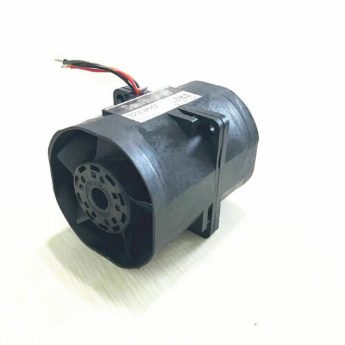

I might try one of those eBay 'electric turbos' as a simple high flow cooling fan
