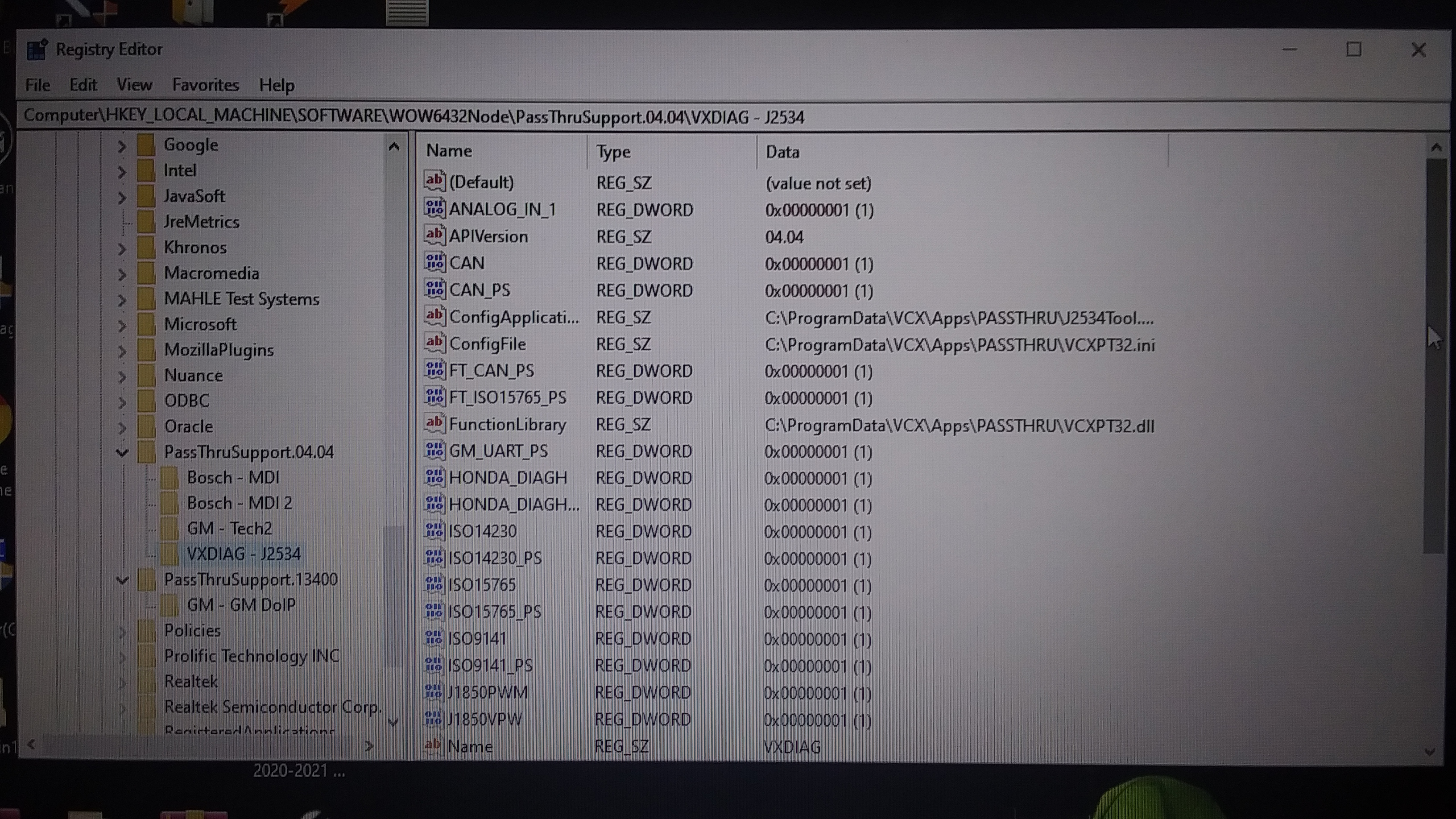

So I checked registry. There is no pass thru directly under software, but there is under wow6432node. I'll try the vc_redist and see if that fixes it.
- Posts: 2332
Re: Vcx nano error 126 using PCM hammer
See "FunctionLibrary", that is what all software looks for to find the devices driver, in this case it's vcxpt32.dll, vcxpt32.dll loads vcx.dll.

Where is functionlibrary? I couldn't find it in registry or anywhere else.
