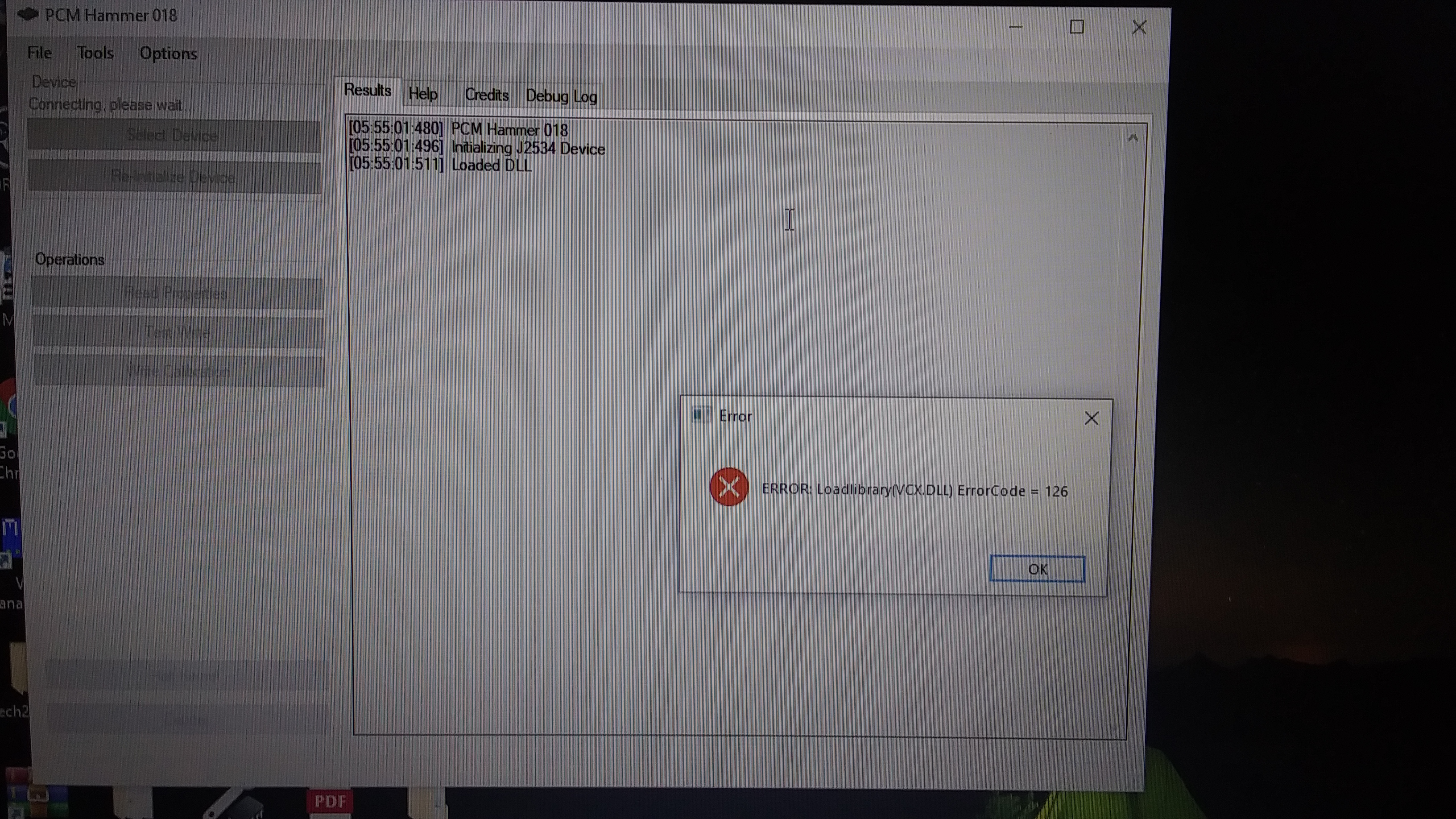

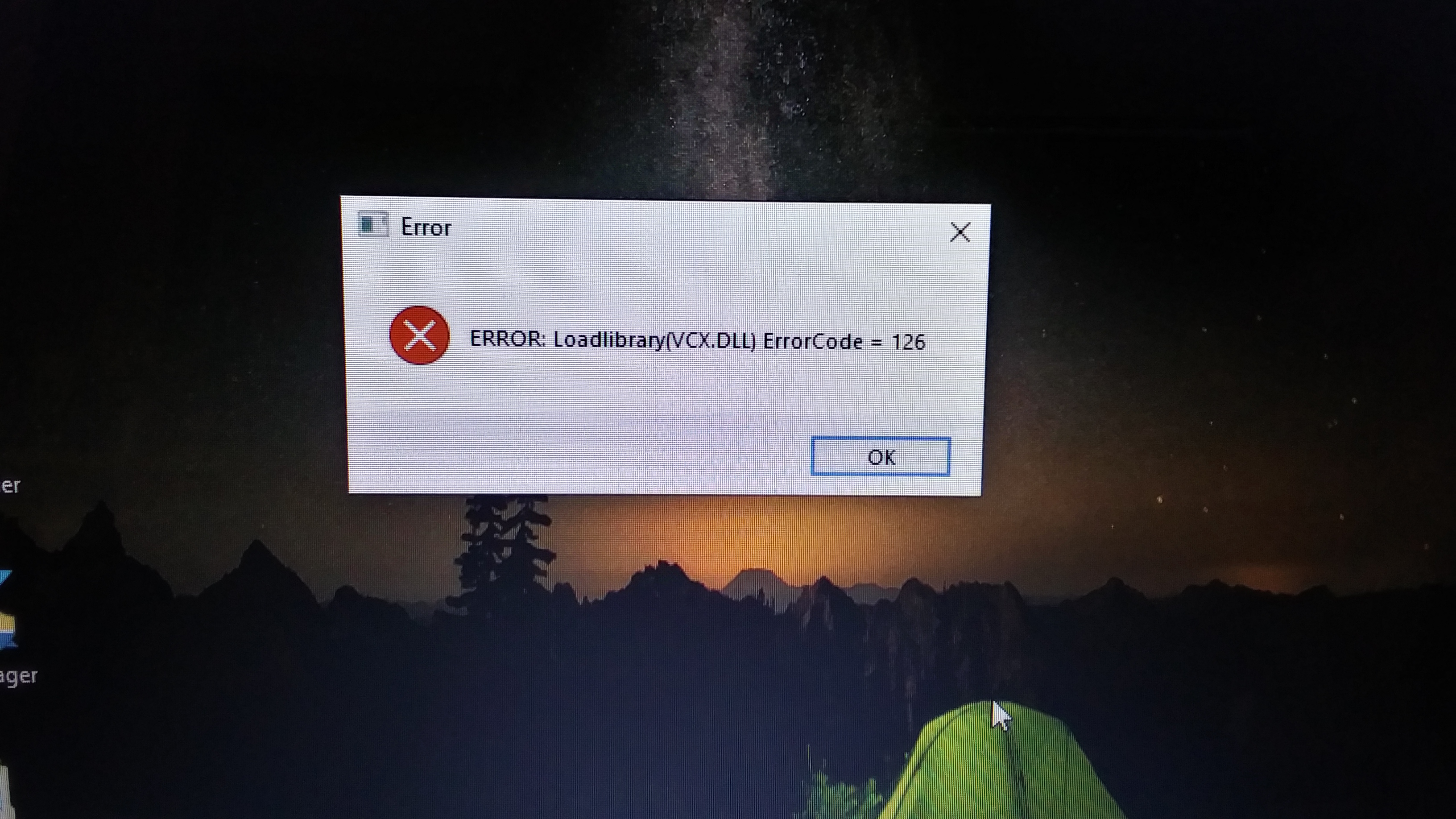

So I have a vcx nano with windows 10. I have used it with gds2, tech2win, sps, and forscan without any problems. I installed PCM hammer and when I choose vcxdiag I get error 126 can't load vcx.dll. I'm not a programmer but competent getting hardware functional. Any ideas or suggestions greatly appreciated. I also have hptuners, elm327, and am considering the vci j2534 for Toyota if anyone has experience please share. Also wondering if the vci is compatible with PCM hammer if anyone has used it? Thanks, Cincinnatus

Vcx serial number starts n52gm***** it's for gm. On PCM hammer without opening a file, just selecting vcxdiag as device causes the error. Then every time I open hammer it immediately says the error before hammer opens.

Here is when I try to open hammer. Sorry for pic quality as I use phone instead of computer most of the time.

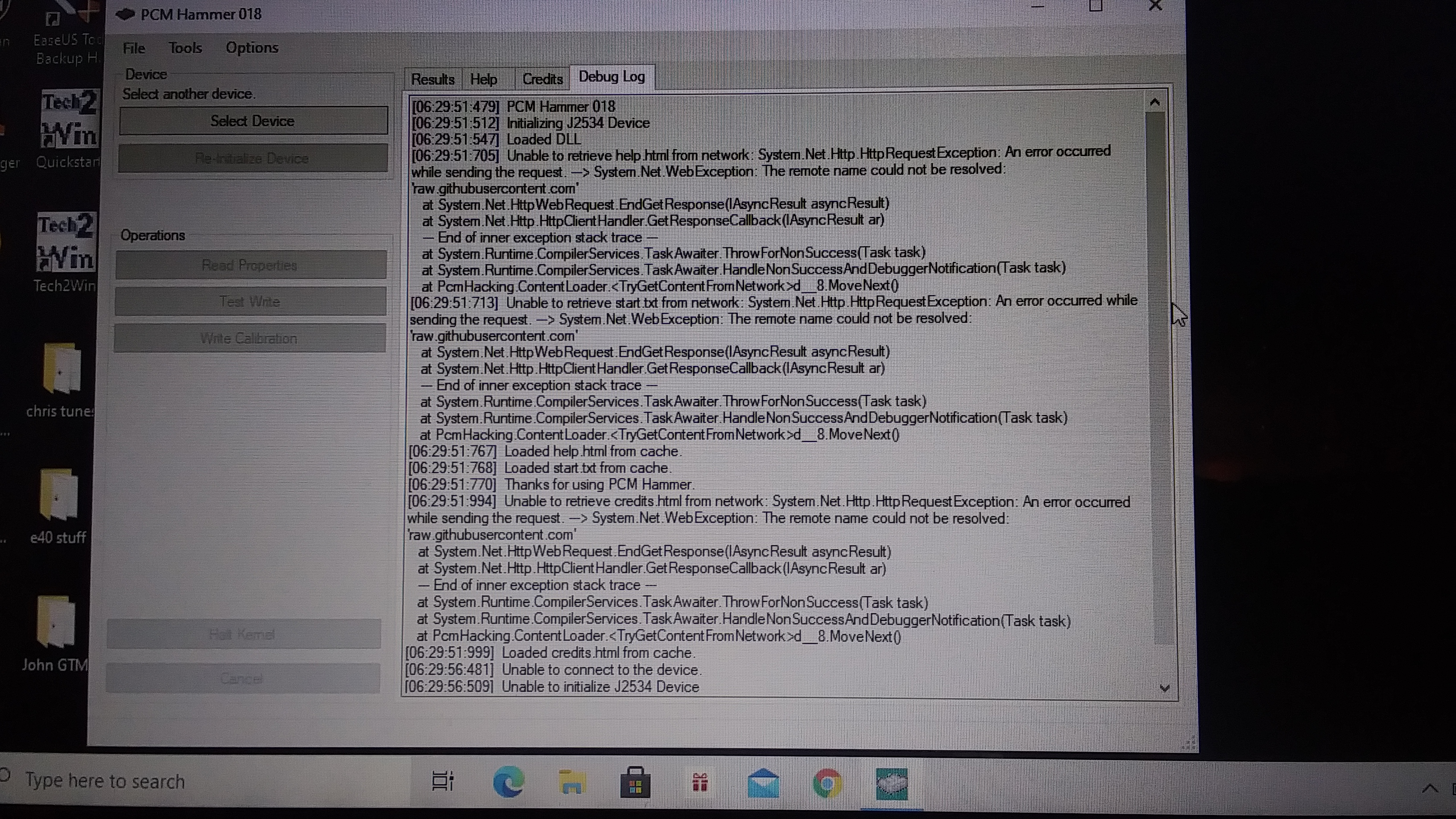

Re: Vcx nano error 126 using PCM hammer
Took this too. Btw I run my PC without internet most of the time if that makes a difference.
The error, IIRC it is a missing Microsoft vc-redist package, IIRC it's vc_redist-2015.
Gosh I sure do despise ET apps Phoning Home ... i.e. the Unhandled Exception because it's not connected to the internet.
Don't get me wrong, it still should not throw an Exception, it should handle it appropriately, I'll look into it, it's not causing your problem.
PCM Hammer remembers the device used and saves it in the %localappdata%\PcmHacking directory.
It is safe to delete it, it will recreate it the next time PCM Hammer is launched.
-Enjoy
-Enjoy
So hammer is looking in windows subfolders for vcx.dll and it wasn't placed there when I installed software or drivers for the nano? Since forscan works with the nano, isn't it just an issue of hammer finding the location of driver data for the nano? I searched for vcx.dll and it is in c:/windows but hammer isn't finding it. Curious why others with nanos aren't having the same problem.
