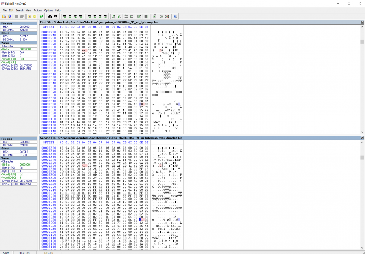

Thanks antus, I'll see what I can find. When I find the segment with the VATS bit, shouldn't we be able to set the bit then find an unused FF and set it to FE so checksum matches, then byteflop again so he can program the flash chip? Sorry if these are dumb questions.
Posts: 9008
Re: delco ecu identify and VATS off
Yes, thats right. From comparing the output of other software I can see vats disabled is 00 to 01 at F0BE and Checksum is subtract 1 44 to 43 at EF94. I would assume sum is checksum-16 at EF93 but I havnt verified the endianness to be sure of that. Its the system segment, and sum is in the system segment header.
gmc yukon_ab28f400bx_99_ori_byteswap_vats_disabled.bin

Do you feel confident that he should write this and re-solder?
Posts: 9008
yes I do, and hopefully we can come up wiith a software flash tool, and someone can make XDFs later. Just remember to byteswap it back before writeing.
