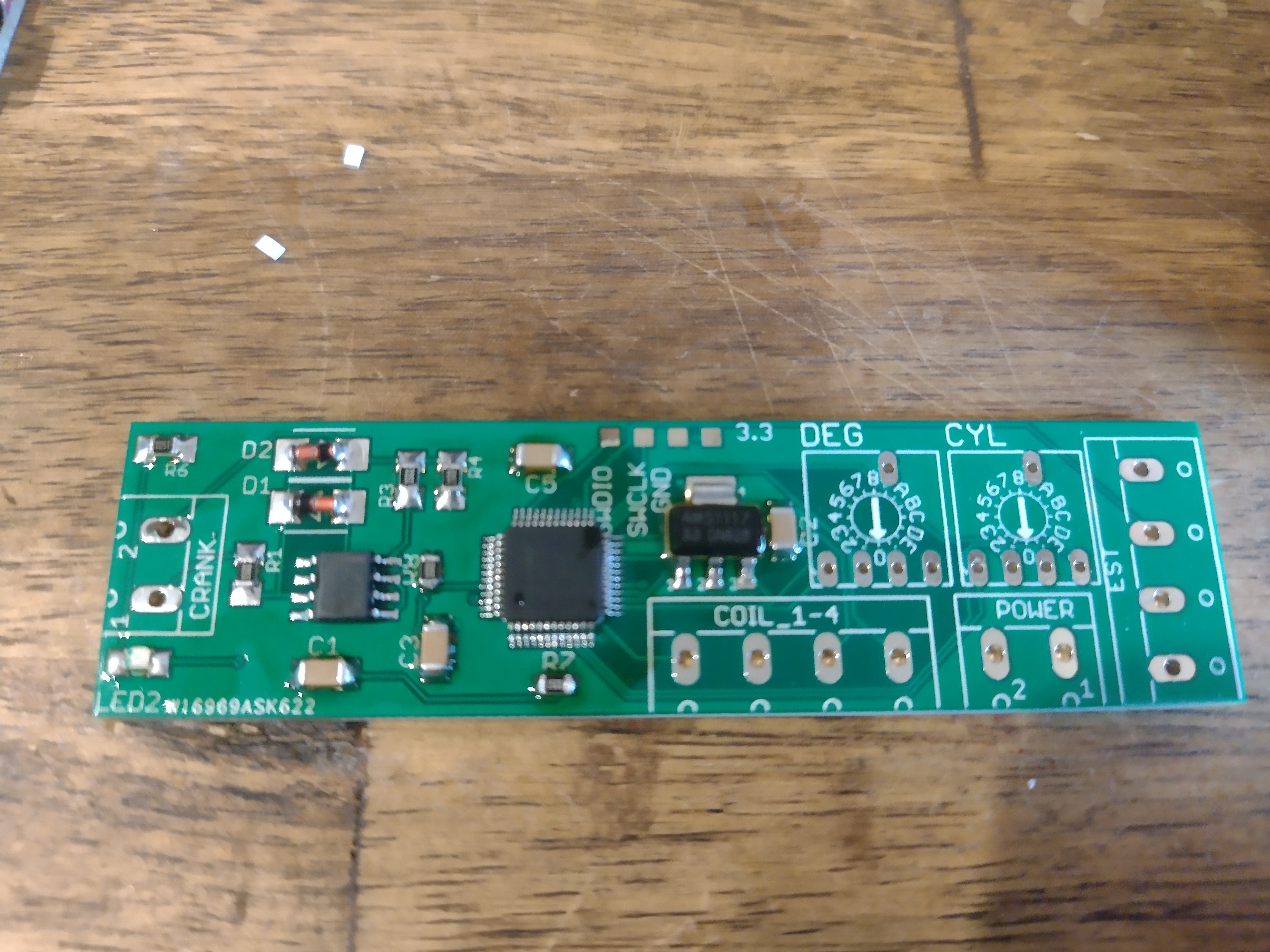

Protos arrived. Testing maybe this week

Looks good! If we need to fine tune ref angle will it only be a firmware change to modify the scaling of the change dialed in on the rotary encoder?

The plan is to have the DEG wheel adjust from 0-150 degrees offset from the missing tooth - adjustable in 10 degree increments. Reversing the VR input will trigger on the opposite edge (start of a tooth vs start of a gap) and could adjust down to 5 degree increments but that may cause other side affects.
Ideally 10deg will be enough and your VR sensor will be on an adjustable bracket that would set the timing below 10degrees. Or degree your crank first before you weld on the trigger wheel if the sensor is fixed? I think 5 degrees either side of ideal will still let the motor start and run and 11p/12p will do the rest.
16 options for the Cylinder count is a little overkill so I'll probably set it up for 4,6,8 cylinder, inverted 4,6,8 output, and CDI 4,6,8 output (CDI being fired on the falling edge of EST with very small dwell)
I should have added more LED's for status / loss of sync / coil firing etc. Next revision maybe. And maybe use some of the ADC pins on the micro to eventually read the knock level from the saab cassette to retard timing without ECU intervention, or just output a knock PWM signal which the Delco can interpret.
