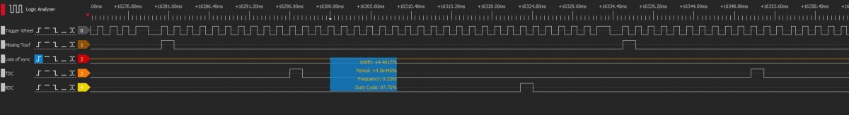

A bit more work on the software side of things:
It's processing the tooth pattern from the VR circuit, it's detecting the missing tooth, generating the reference pulse as well as 10deg before Top and Bottom dead center. 60deg before is fine too which I think is what V6's expect?
The TDC and BDC angles can be set in software so it'll be compatible with 4,6&8 cylinder engines. I'm not sure if 'fine' angle adjustment will be necessary in software, a hardware solution which moves the VR/hall sensor will probably be fine? A course adjustment in software is available (10deg increments for a 36tooth wheel)

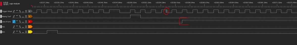

There's also code to detect the wrong number of teeth per rotation which sets a Loss Of Sync flag and LED until the next full trigger wheel count is detected then it continues on. I think it's more important to just cut the spark than to allow early ignition timing.
Loss of sync shouldn't occur in normal operation, unless the sensor is too far from the wheel, there's significant runout/wobble on the wheel or an unusually noisy electrical environment. I might test a few different VR conditioner circuits on the lathe and play around with sensor gap and adding interference to see which is most robust.
Cranking dwell - Right now it's set up in tens of degrees. 10deg = roughly 6mS of dwell at cranking RPM which is right on the money for most coils with battery voltage around 10v or so. It wouldn't be too hard to set up a timer to fire a more precise dwell for cranking. Let me know if you think its needed?
Running dwell and timing is all controlled through the Delco. The angle at which to change coils/pack pairs can be defined but it seems more logical to use the falling edge (moment the plug fires) to select the next coil to fire. The MCU will keep it in sync and watch out for a loss of sync.
MCU processing latency - It is measured at 2uS between the detection of the missing tooth, to the generated reference pulse. At 1000rpm this = 0.012degrees of error, at 10,000rpm this = 0.12degrees of error. To keep this error at the absolute minimum, the MCU won't be processing any other signals, the pulse distribution to the coils will be handled by a programmable logic IC, as will cam syncing for coil-on-plug setups. The MCU is only there to process the trigger wheel signal and make the delco ref pulses.
Waveforms from the logic analyser:
Missing tooth detection: Loss of Sync Detection:
