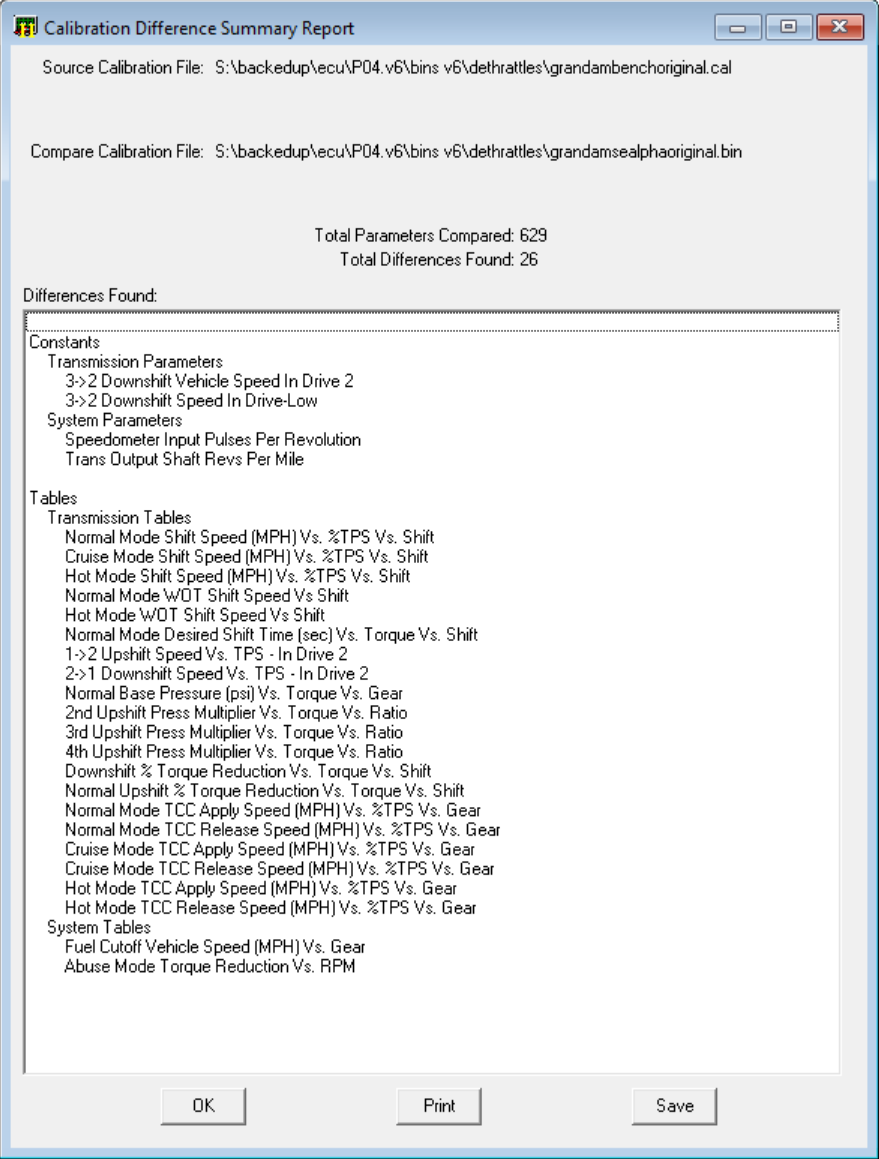

There are no fuel or spark differences between the two PCMs. If you look at the difference file:
If you cant make sense of the detail changes and headings in the text file heres a screenshot of the summary from the gui that lists the different params without showing you how much those items are changed. Looks like it might have a different diff ratio, but other wise be pretty similar. Reminds me of the types of changes we got in the Aussie HSVs.
Nothing in those areas.TABLES:
Spark Tables:
Fuel Tables:
- differences.png (145.57 KiB) Viewed 2175 times

Im going to have to read up then and i never did contact lsdroid to see if they cover the grand am. I'll just keep it as is, now when you say the speed is pulses? Is that just saying my speedometer is off using the se version? I wonder if the gt got different sized tires.antus wrote:The only free thing for p04 with write is lsdroid and an xprogt interface.
Spark Tables:
Fuel Tables:
