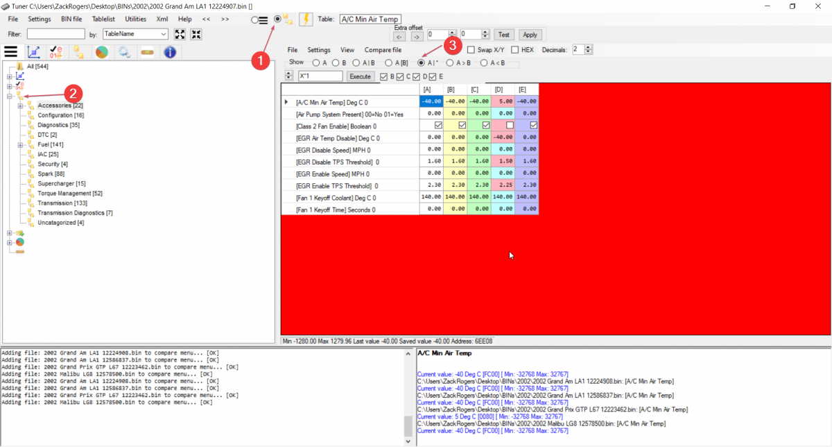

Universal Patcher makes it pretty easy to compare multiple BINs imo. Open UP, click File>Open multiple BIN and click the checkbox for all of the BINs you want to compare then click 'Open files'.
Make sure you have UP set to treeview (the option next to arrow #1 in my screenshot). Open the tree next to #2 and click a category you want to compare tables from, in my screenshot Accessories is active. next to 'Show', choose the option A|* (see arrow 3) and this will show BIN A compared against every other currently open BIN, all in their own column. (note: your options may say B|* or C|* etc, I think when you open multiple BINs the active BIN is set to the last one opened, ie if you open 3 BINs UP will set the third, C, as active and that will be considered your base/compare to)
Hopefully that's enough get you started in the right direction. I haven't used it a ton so I can't offer much more help than that unfortunately.
