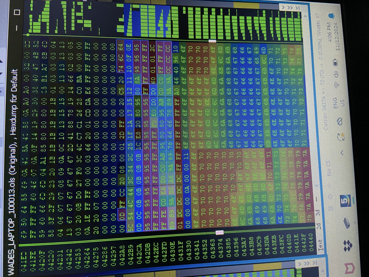

Looks like there may be another 2 or 3 tables there but I’m not sure what they are.
Wade
Posts: 1247
Joined: Sun Jul 10, 2016 8:29 pm
Re: VT V8 CFZC($A6C) Injector crank tables
Post by Wade »
The larger map is injector rate constant vs mg/cyl vs rpm. So you can see there’s still a couple tables in there, but I don’t think there’s as many as the v6’s have?

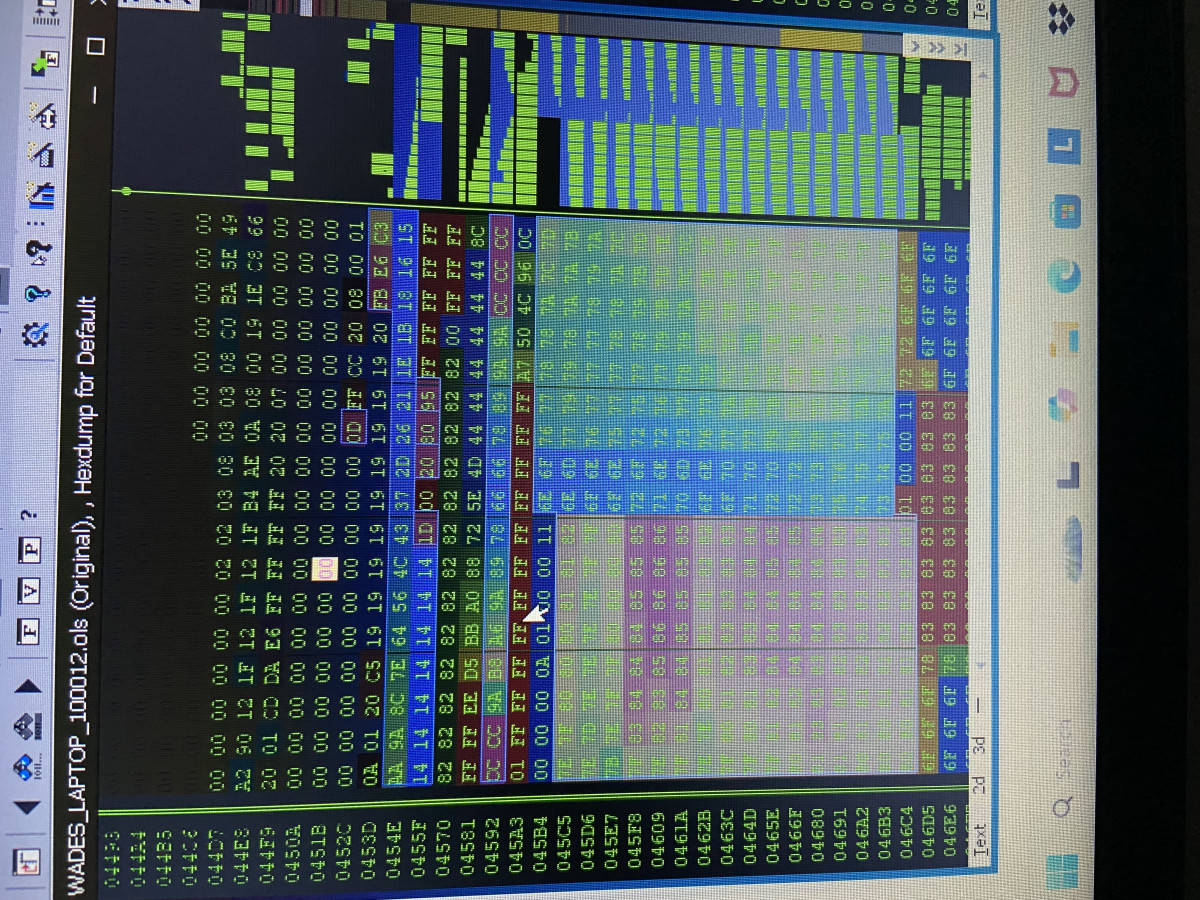

Vs v6 for comparison

4581 17x1 might be fuel pulse width multiplier vs ref pulses table a. Then 4592 I dare say is table b

The offset would be 1 over from what I just posted I think

Enhanced vs v8 stuff looks to be at. Crank table scaler for max crank pulse width 4534. Crank fuel pw vs coolant 4549. Hopefully that helps with the vs v8
