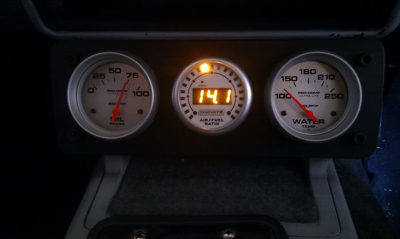

Installed mine today, finally got a passenger seat again with the LM1 being retired to only when I want to log both banks. So far so good with the MTX-L although it does seem to read a little different to the LM1 (am still using the sensor that came with the LM1), but it may be that I have not calibrated the LM1 for ages (read years

Is there a way we can adjust what this displays on the dash of TP. Seems to read about 0.5 higher in TP, than on the guage itself.
Cheers
Cheers
Re: ANYONE INTERESTED IN GROUP BUY WIDEBAND O2 WITH GAUGE ??
check the wideband config is right, it appears the 5v setting in $12P is 23.4 when it should be 22.4

Thanks mate, spotted that in another thread.
