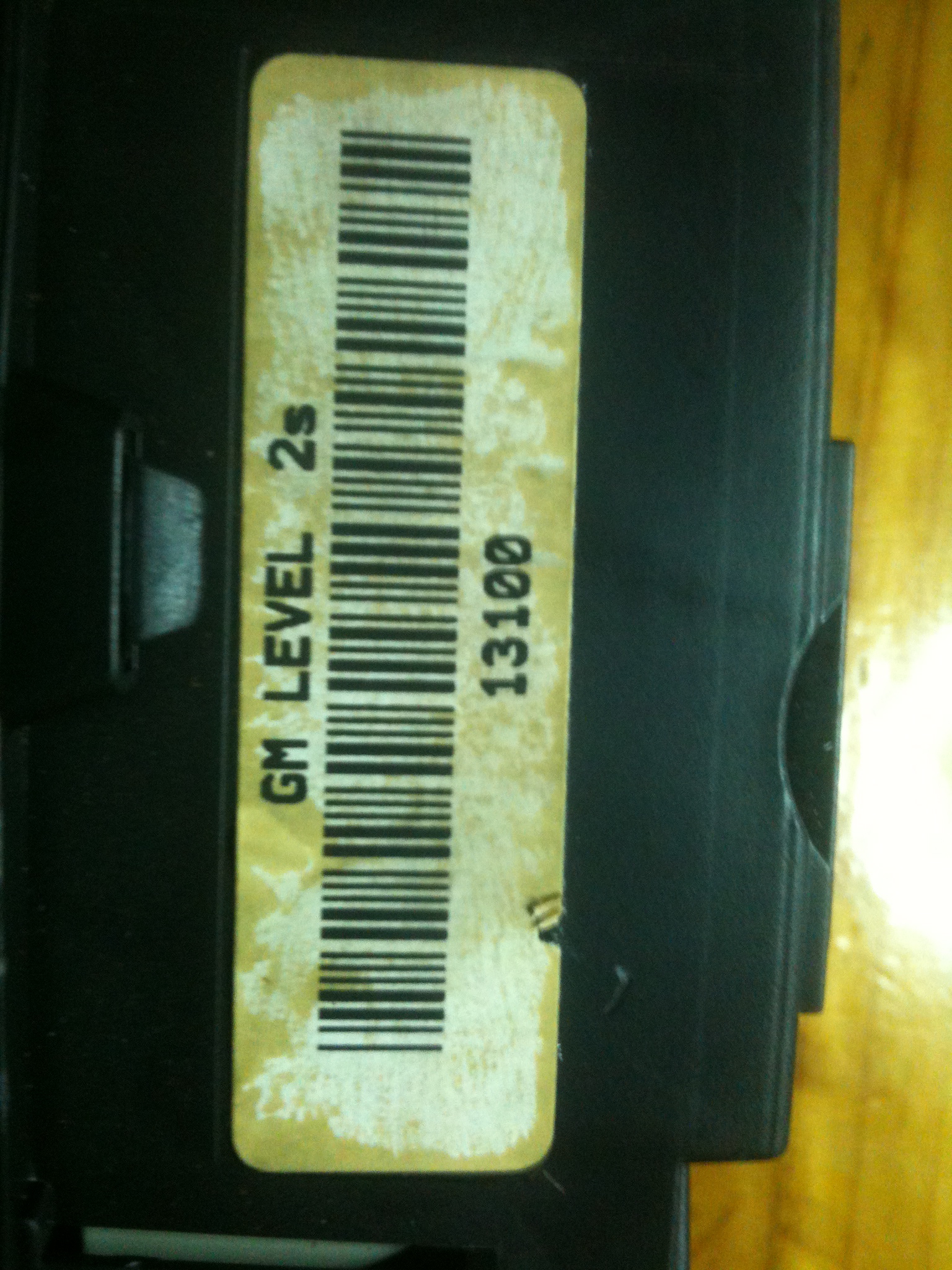

all VX clusters are S2 wether single or triple window and that's a pic from my single window
holden stuffed again with the VE' s between 2007 and 2008 cluster weren't interchangeable

Is that a picture of a VX cluster? I thought there was S1 and S2 VX clusters?

The series 2 clusters have a large P in the bar code lable - Level 3oP
The supercharged series 2 clusters have Level 3siP (si being a new found code for me)
