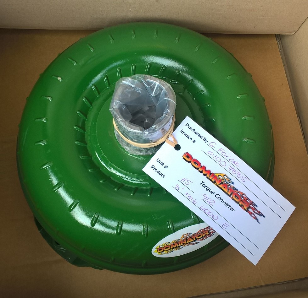

so the main reasons this is off the road was because the converter didn't like NOS, so we've just gotten a new 4000rpm converter which should do the job nicely, this is also going to mean we'll be able to hit the gas on the line now instead of 5 mtrs down the track! also pulled the tranny down, its all good, but has flakes of metal all through it, so it got a thorough clean in preparation for the new converter!

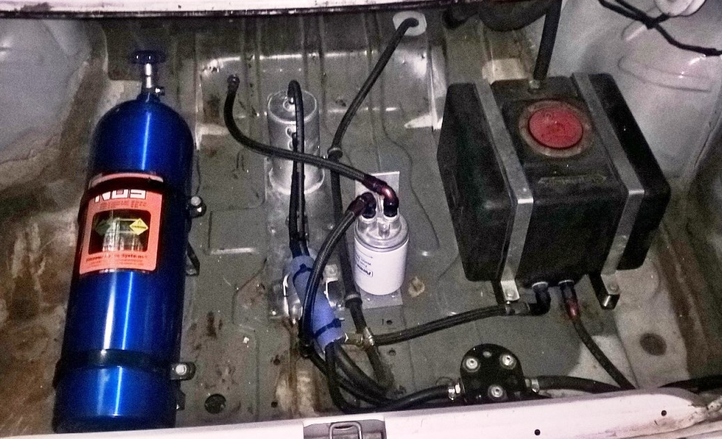

Scotty also purchased another NOS bottle, it was mainly to have enough available for a full weekend of racing, as it turns out they sent the wrong size bottle, so paid a bit extra and probably now means we'll have enough for a full weekend with just one of the littles and the new big one
only concern we had was having to re-locate the mounts to suit the bigger bottle, but no need, fits perfectly and theres enough length in the NOS feed hose to go to the new location!

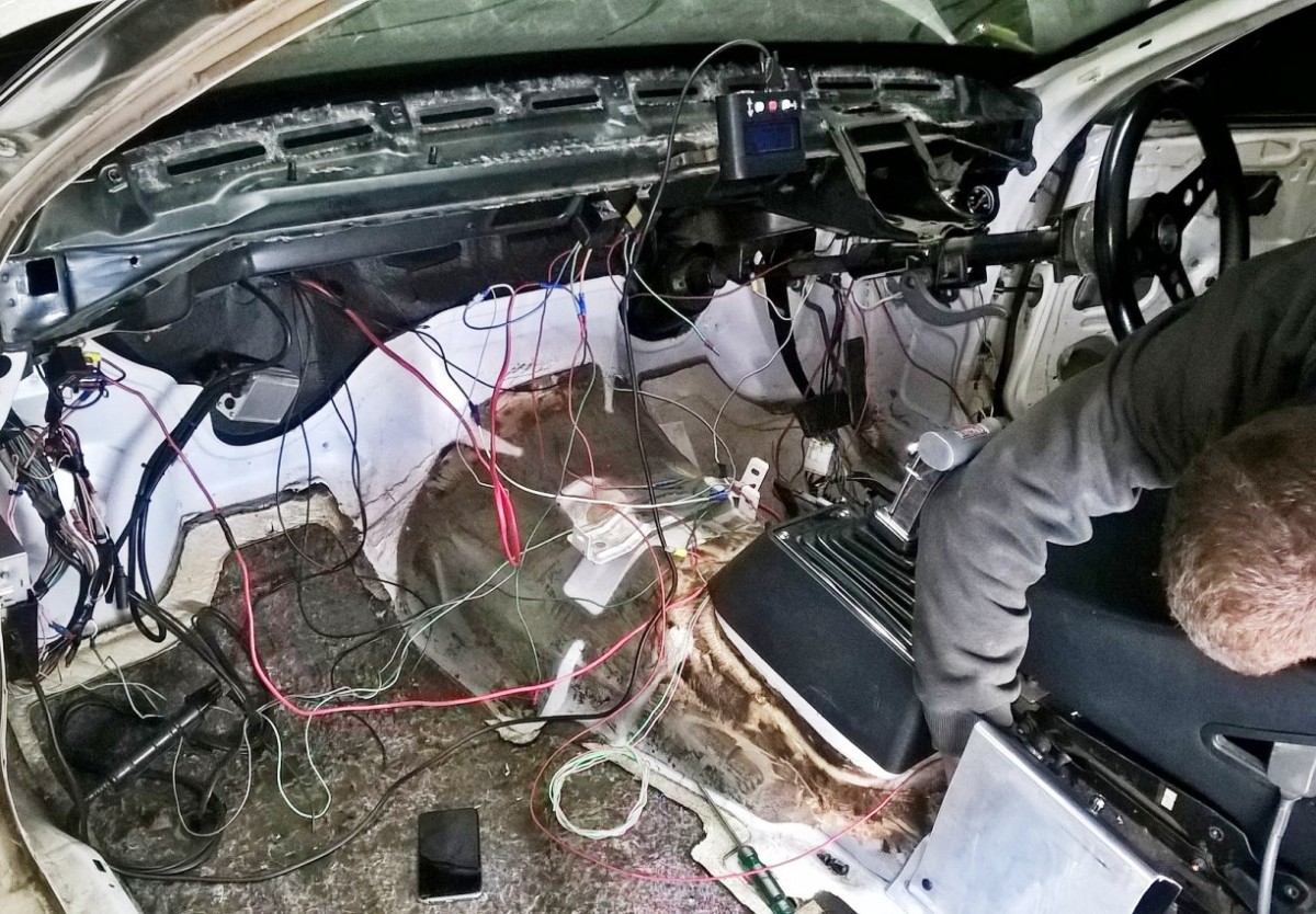

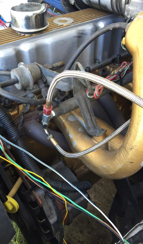

we gutted all the original commodore wiring only leaving what we needed in the engine bay and run fresh wires for the ECM/NOS/Lights etc and fitted a switch panel on the transmission tunnel with what we needed for ignition, 2 step and nitrous controls!

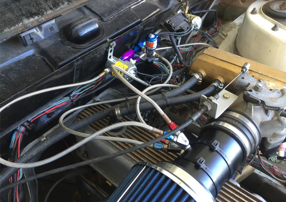

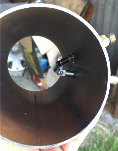

As you can see from the next few pics we have the 2 NOS nozzles installed, so we'll be good to go with multi stage NOS injections now
so we are in the process of finishing off the wiring and hopefully that will be done tonight then all systems go for Gunnedah this weekend!

Not knowing too much about NOS does the injection system have a calibrated amount of additional fuel it injects with the NOS to maintain air fuel ratio? If so how is it calibrated?
- Posts: 2585
- Location: North Coast, NSW
Re: VS Commodore 202 Drag Car :)
nah, its a wet nos kit... the nozzle sprays nos and the extra fuel. with this one, you tune the ecu with your wideband first, then you add the nos and fuel jets and tweak the jet size till your wideband comes back to where it should be.
