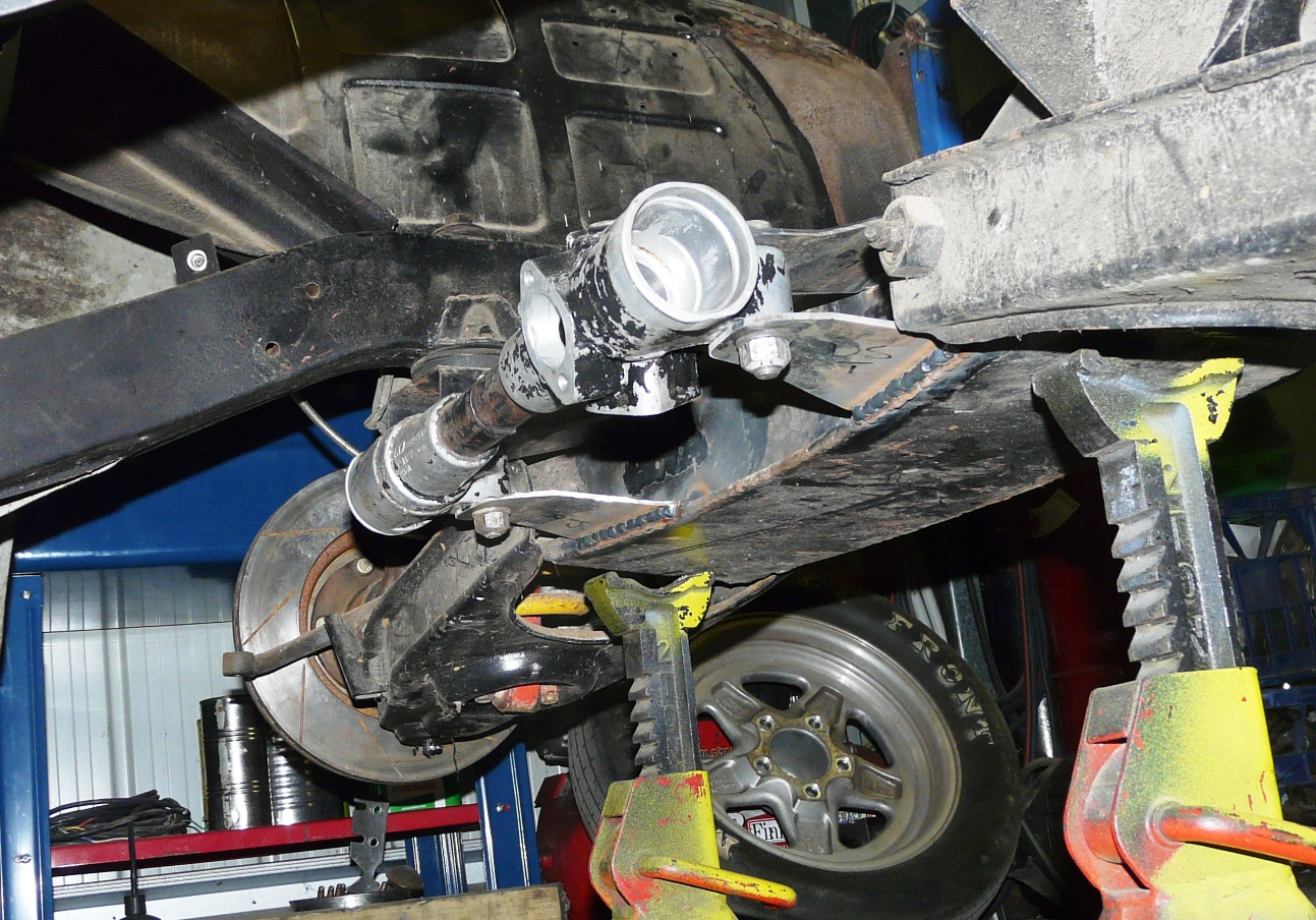

before you mount it height wise make sure the stearing arms are parrellel to the lower arms so it dont bump stear
yeah i need to slightly bend the plates up to get it about 10mm higher so they are in line! but haven't done it yet as i was using them as a template to duplicate for the top ones!

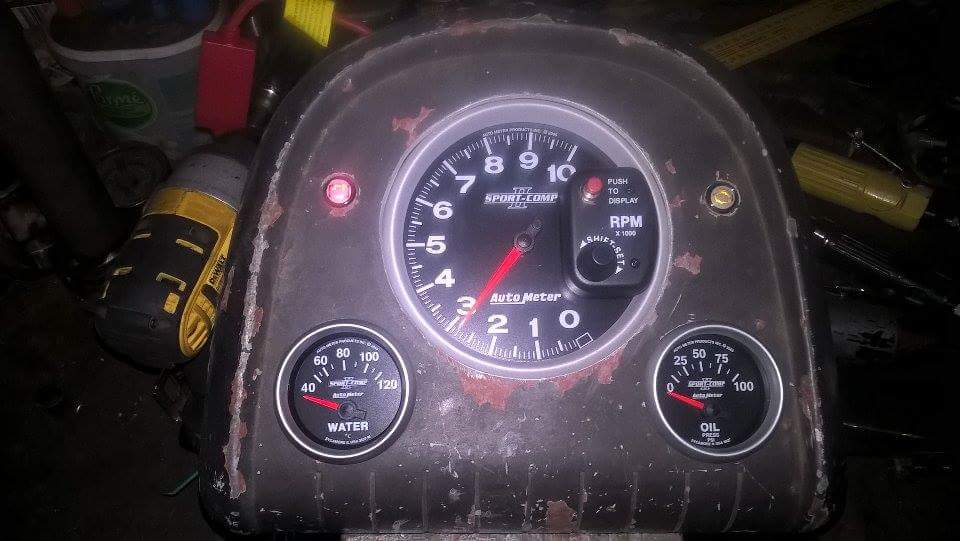

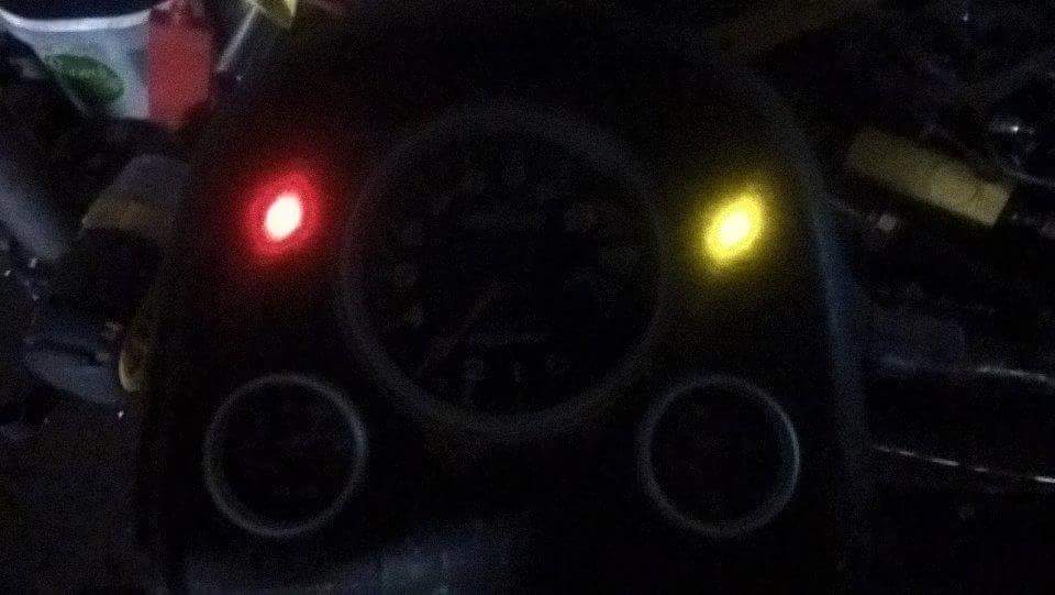

Lights turned up today!
Sorry the pictures don't do them much justice!

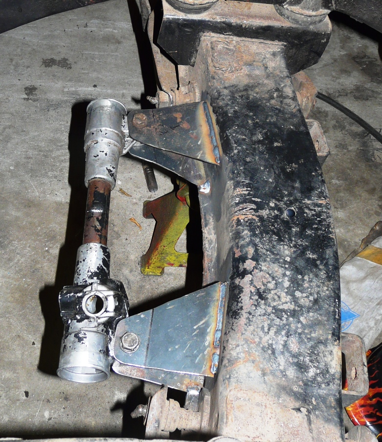

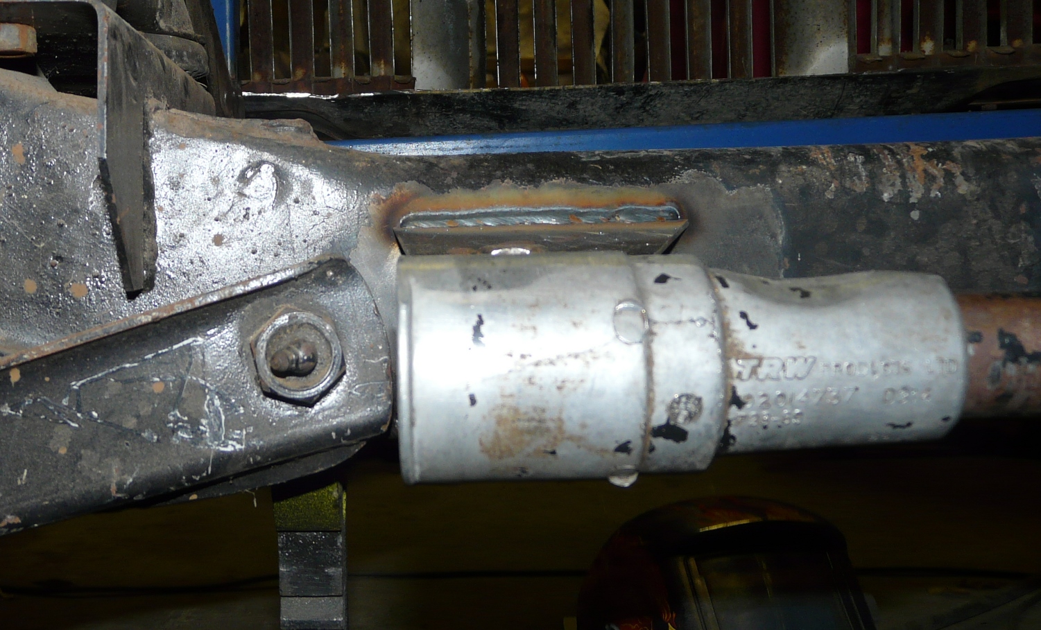

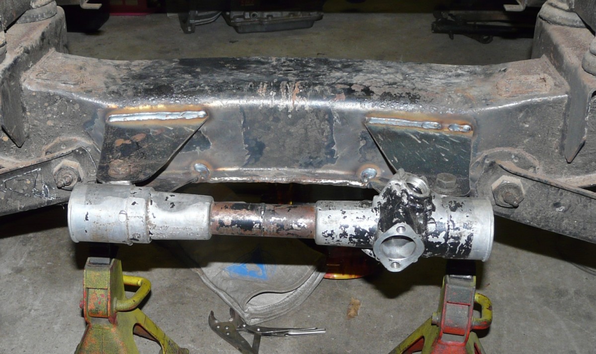

made some good progress on the rack today, the location and mounts are sorted and locked in! just need to make the gussets on the sides! probably should start on getting the rest of the rack bits modified I guess lol
The next pictures for you delcowizzid

Have you thought about bump steer?
yes and no ...
no in that for a drag car doing only straight line racing it shouldn't be too much of an issue....
that said i am copying directly from one that was setup in an FB Ute and it is as good as it gets for old holdens bump steer wise, so provided i locate it in the right position it should be the same....

in any case it can only be better than steering box and idler arm
