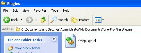

be careful where you put it... looks like someone made a mistake
its not supposed to go into Documents\Plugins.. it goes into Documents\tunerpro Files\PLugins. I just tried it on a winxp machine and the only place tp5 detected the plugin was there.

It should be set up in the directory how Jayme has shown (he just tested it also). Old habits die hard and Im a stuborn bastard so I have under program files with tunerpro but technically its not right.
Re: OSEPlugin for Tunerpro 5 v1.2.1
yeah the file path I wrote has always been the official place to put them.... I guess mark just made a booboo with the latest build and put it in documents by accident.
as written in the link below
http://www.tunerpro.net/downloadPlugins.html
I tested the prog files directory and documents\tunepro files\plugins on xp pro sp3 and both worked for me.....
I no that plugins folder is supposed to be the correct directory but for me it will only work if i put it in program files/tunerpro rt.
I tried putting it in there (program files) before but it wasnt working.
Im not sure ,but it seemed to work after i uninstalled/deleted all folders,then installed an older version that worked ,then updating with the latest version,without uninstalling the older version , and then putting ose plugin in program files/tunerpro rt.
Anyway working fine now
